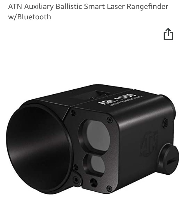

Several of the companies making affordable IR based night vision scopes (under $800) are now adding a laser range finder, like this ATN add on device:

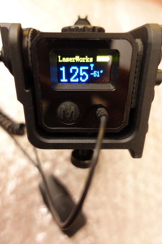

Picked one up at a gun show today: Ranged a treeline just now in the dark at 570 yards (so ideal night time conditions, no fog, and very low humidity). Don’t have a target that is further away yet. Will try longer distances tomorrow. Then see how well (or how badly) it works in bright sunlight. I would be happy with 400 to 450.
It has an aluminum housing and a nice pic mount, that looks fairly sturdy. The rat tail cable is permanently attached, and it might easily get damaged. Will figure out a way to protect it from jerks (like me!) who are rough on their equipment...
Will try it on my dedicated night vision rifle soon.
Tested it again this morning in fairly bright sunshine after 3” of snowfall overnight. Close to freezing temps. Blue skies, very low humidity. Ranged reliably to 450 yards (trees), but struggled beyond that. Got a few readings out to 580. I presume it will do better with large rocks, but less well with small hairy animals.
As expected, the LRF does not work wel in heavy snowfall. Fog mode was only a little better and i got a few accurate readings, but mostly the numbers were wrong. Laser bouncing off snowflakes.
Left the device outside in the cold for 3 hours (intentional) and it worked reliably when turned on.
Battery life is not great, but probably aceptable. Uses a tiny CR2 battery (a weird little overpriced battery). Will have to carry two spare batteries.
All in all, at least so far, i have hope that this low cost device will work for my limited purposes, which is rifle hunting out to 500 yards, and crossbow out to 70.
We shall see about reliability.

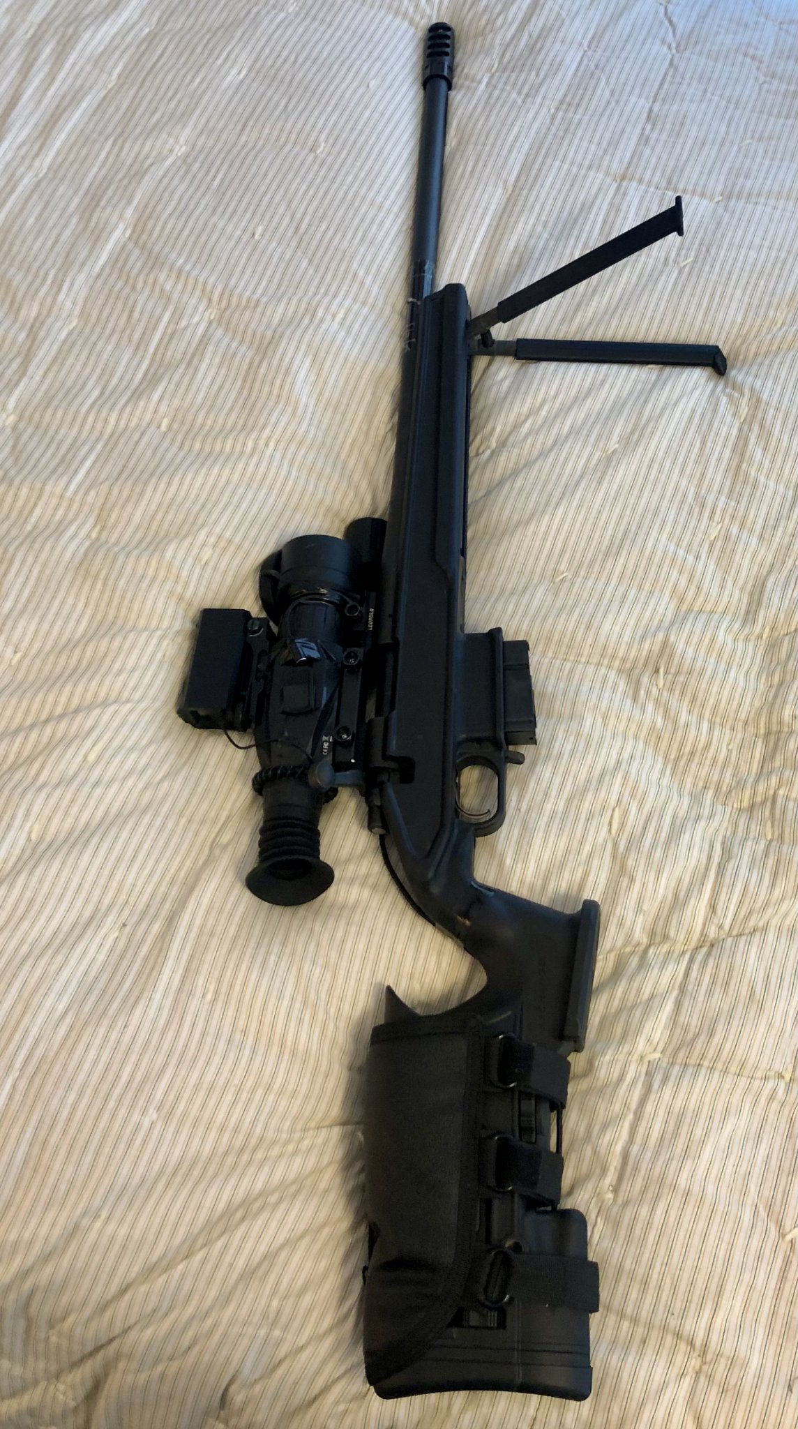

Final update: It is a little tricky to line up the LRF in the daytime even if you hang a metal plate on a clothes line. However very easy to zero it properly at night as you can see the laser scanning rapidly up and down in your IR scope’s viewfinder. My attempt to align it by day was off by a lot. Now it is finally correct. On a standard optical scope, this may pose a challenge.
Used it last weekend for boar hunting at night, and it worked fine. Not a premium device but usable on a night vision system.
Sightmark Wraith plus LRF on top is very tall and it will get damaged if you drop the rifle. Also it does not fit in a rifle bag, it will need a pelican case with a foam cutout. Two computers with a rifle attached to them.

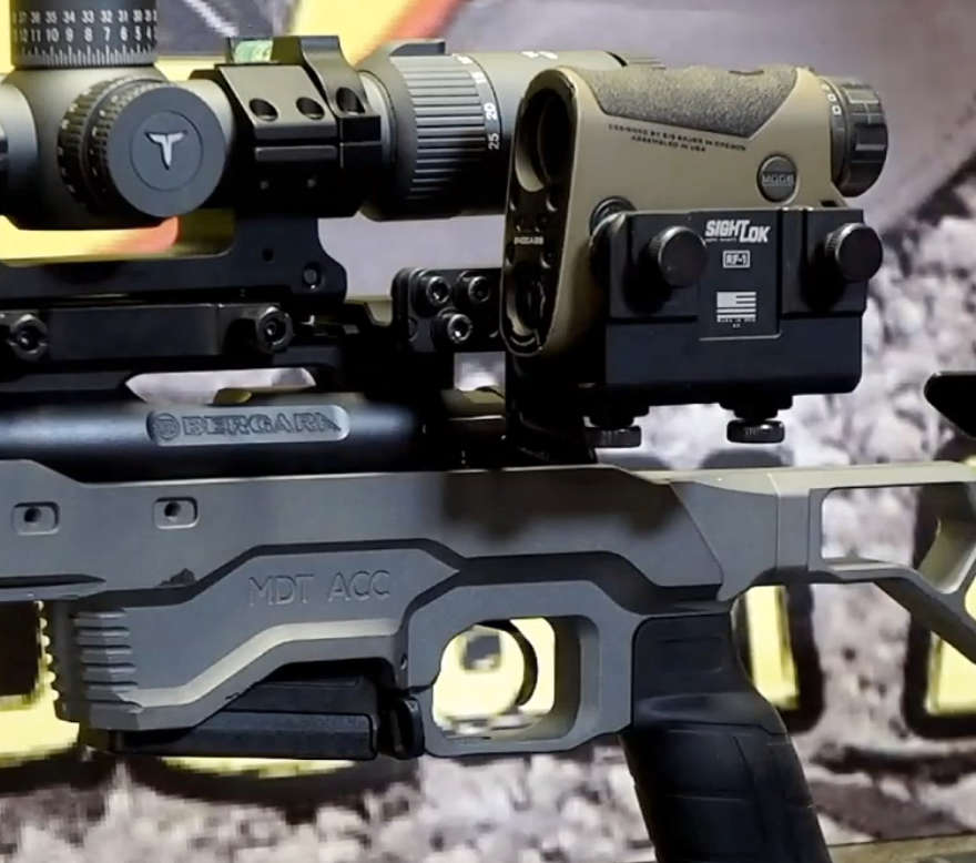

That's pretty neat!
Has anyone reached out to them to talk about what the riflescope market is looking for? I agree with the crowd that the market is ripe for a new SiCo Radius-style LRF at the $500-$1000 price point. (Actually, now I'm wondering why Sig hasn't released one...)
