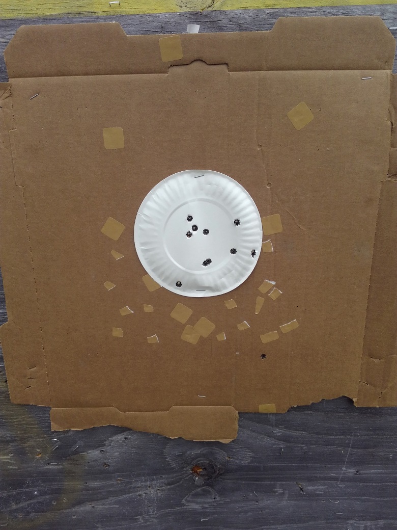

i just got into semi autos not too log ago.
all shoots fired for the sake of this discussion are from the bench with a rear bag.
i noticed, whether i am shooting my mk18 SBR or my scar 17, the last round fired when the rifle locks the bolt back is always off. on my scar 17, is't usually .5 mil low. on my SBR, it's been a few months and i forget which direction, but the last round is always off as well.
is it me? or is this just how it is, the rifle isn't competing the cycle?
attached is a pic from yesterday with the scar 17. these shots were fired in semi rapid succession. meaning; fire, ride the recoil, let it settle, fire. no time in between for breathing.
300yds
scar 17
168 FGMM
trijicon accupower set on 6x
14 rounds total believe it or not
6" pie plate
as you can see, i have 13 in the plate, but one way the fuck out there, which i am assuming is my last round (it's a little tough to see 30cal holes at 300yds on 6x). a little back ground info, when i shoot the steel plates and take my time, i see the rounds appear on the steel and my last shot is always low. this is why i am assuming the round way the fuck out there was my last round.
I have had the same problem. I have tested this myself several times, the bolt locking changes my semi automatic barrel vibration. Thus throwing off my last shot. Now when I shoot, if I'm going for a 5 round group, I load 6 bullets. That has worked for me.
I haven’t noticed this when I shoot my ar15s for groups, which admittedly is not terribly often. I would think the bullet would exit the barrell before the BCG locks to the rear therefore not affecting POI.
that what i have been doing, or ill just hold over .5 mil and make the hit.
you would think that, but it's the same concept as breaking form when shooting a bolt gun. like when you take your finger off the trigger before the recoil impulse is over, or taking your head off the stock before the recoil impulse is over.

That is only partially true; yes if you lift your head off the stock within milliseconds of breaking the trigger or slap the trigger your can affect the shot because you disturb the gun while the bullet is still in the barrel. Once the bullet has exited the barrel, nothing you do to the gun can physically affect the bullet. Therefore the question is whether the bullet is still in the barrel when the bolt locks back. I don’t expect that it is, but I could be wrong.
Known phenomena.
I remember reading something about David Tubb talking about this exact thing. Not sure if the cause was ever totally proven, but I've seen it as well.
I always wonder if its something with the bolt getting locked back and the 'stop' in the bolt carrier group, or if its how the last round feeds out of the mag differently because all subsequent rounds are coming off the top of a loaded cartridge and the last round is coming off the follower.
The bullet has left the barrel and there is zero pressure in the barrel when the bolt is unlocked, it then must travel rearward to the stop and start to return interrupted by the bolt stop.
Do not doubt the condition exists but the event would happen while the bullet is traveling down the barrel.

I've experience the same thing when my first 4 shots can be covered by a dime 50% of the time the 5th shot is usually 0.5 moa low. I chalk it up to buck fever as I can feel the tension in my body increase before the last shot. This happens when shooting either my AIAW or one of my 308 or 556 semi AR's.:cry:
Tension on the bolt from the magazine,
a Scar is not a precision rifle, the full mag pushes on the bolt, when it empties the bolt no longer has the tension on it, guy would usually load an extra round or not shoot them all
Last round fliers are common in certain semi autos

Due to the lack of a 3rd Recoil impulse, and the happy trigger finger (it's what I call it).
Many times I'll see people do this, with bolt guns and Semi's, they will put 4rds in one hole, and when they know they're on their last round the almost psych themselves out. And this will cause them to white-knuckle the grip, jerk the trigger, and Cant the rifle.
This is where I would start....
Have your range buddy load your mags for you so you never know what you're round count is.
Put a anti-cant device on all of your scopes, and make sure they are perfectly level with the scope and your action.
If you start to feel fatigued just pause for a moment and relax, don't try to rush to get that last round in. (BUT.. don't take too long if you know your chamber is hot, it will start cooking that round and you'll get vertical stringing)

Holy hell. That thing must have some terrible fitment if that little bit of difference in carrier tilt makes that much of a difference.
In AR-15's the accuracy increase from addressing carrier tilt either with one of the carriers that help it like JP or installing pads on the rear of the carrier is much smaller than even a great shooter can really see.
