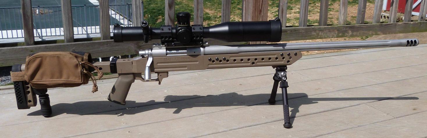

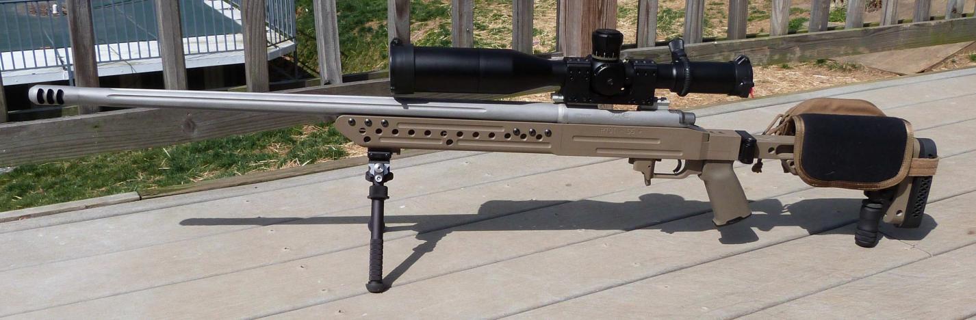

I've been keeping my eyes peeled for a Remington 700 takeoff barrel better than the .308 sporter barrel my 700 SPS came with.
I narrowly missed out on a 20" Tactical t/o barrel here on the Hide.
Since I've amassed quite a supply of .308 SMKs (3k .168s and 1k 180s) I'm motivated to find a decent .308 barrel but had plans to rebarrel in .260 Remington some day.
A few weeks ago a fellow Hider was selling a Brux 6.5mm stainless M24 profile fluted 24" barrel with Little Jimmy brake with 100 rounds down the tube since being chambered .260.
It was on a Defiance action, meaning it had already been threaded 1-1/16" 16 TPI.
Although I have a decent lathe and 20 years in the machine shop I do not have the change gears to make imperial threads with the metric lead screw on said lathe.
I bought the barrel with the hopes I could use it.
Saturday I removed the old barrel and to my delight the Brux threaded into my receiver... it was a bit tight so I put some silver never seize on the threads since I would have to crank it on and off to do what I wanted to do.
I ran it on with a go gage in the chamber and the bolt installed until the headspace was just right, then used gage blocks to check the gap I needed to fill between the .300 thick recoil lug I bought to replace the original.
I determined I needed a .194" thick ring which I then whipped up on the lathe out of 303 stainless.. actually I made it .1955 since I figured I would lose a thou or 2 when I torqued the barrel on.
After tightening the new(ish) barrel on, I had to clock the brake back in, which required .0085" faced off the brake.
I ran the barreled action through my glass beader, cleaned her up real well, torqued her into the McRees chassis, and bore sighted the scope in.
