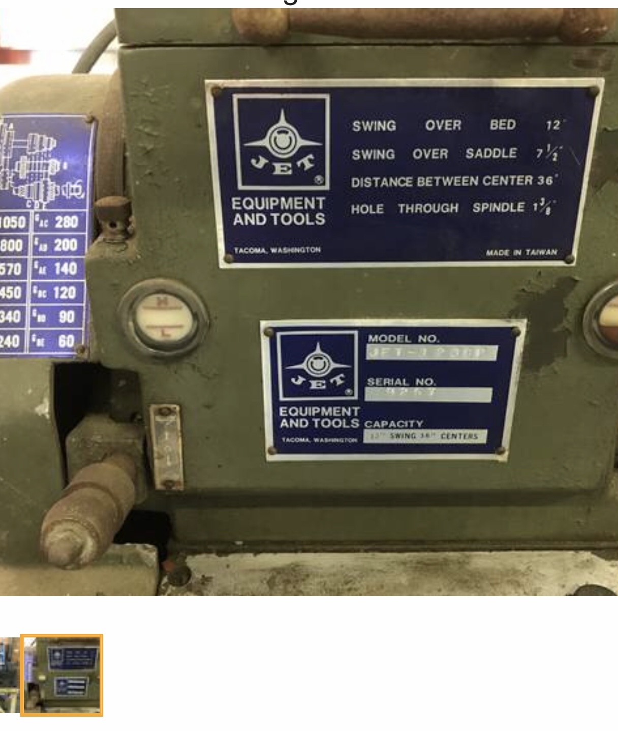

I am getting ready to purchase my first lathe. I have found a used Jet 1236P for sale within a couple hours. I am getting it for basic home projects and something to learn on. Eventually learn how to do some of my own chambering but that is a long ways out. Will this work for basic projects like shafts and spacers? Can I chamber and thread a barrel on this?
If it works, the ways are it good shape and the spindle bearings are in good shape, then yes.
A lathe of that size would be a good gunsmith lathe.
But, thats a pretty old jet (old isnt necessarily bad) just means you need to check it out reall well.
That your asking about this size implies your not knowledgeable about machine tools. Youd be wise to find someone who is, to go with you to inspect it.
I agree. I don’t have much experience at all when it comes to lathes. I am a millwright by trade but not a machinist. It’s something I’ve always wanted to learn.
Im seeing what looks like plenty of rust on it, but cant tell on the ways. I wouldnt buy a lathe that had rusted bedways with pitting.
Inspect the ways, check for excessive way wear under the headstock. Run it in each and every gear. Test all the powered feeds and leadscrew.
To be honest though, unless its just a really good deal, id pass. For a couple grand you can get a very nice used lathe.
I appreciate the feedback. The guy is about 3.5 hours from me. May take a trip up to inspect it.
The chip pan looks to be bent, also looks like it’s integral part of lathe. Looks like someone tried lifting it there instead of under bed or straps. I’d have to pass for a first lathe. If you’re experienced in machinery and can determine everything is fine, it may be a different story.
Good luck.
