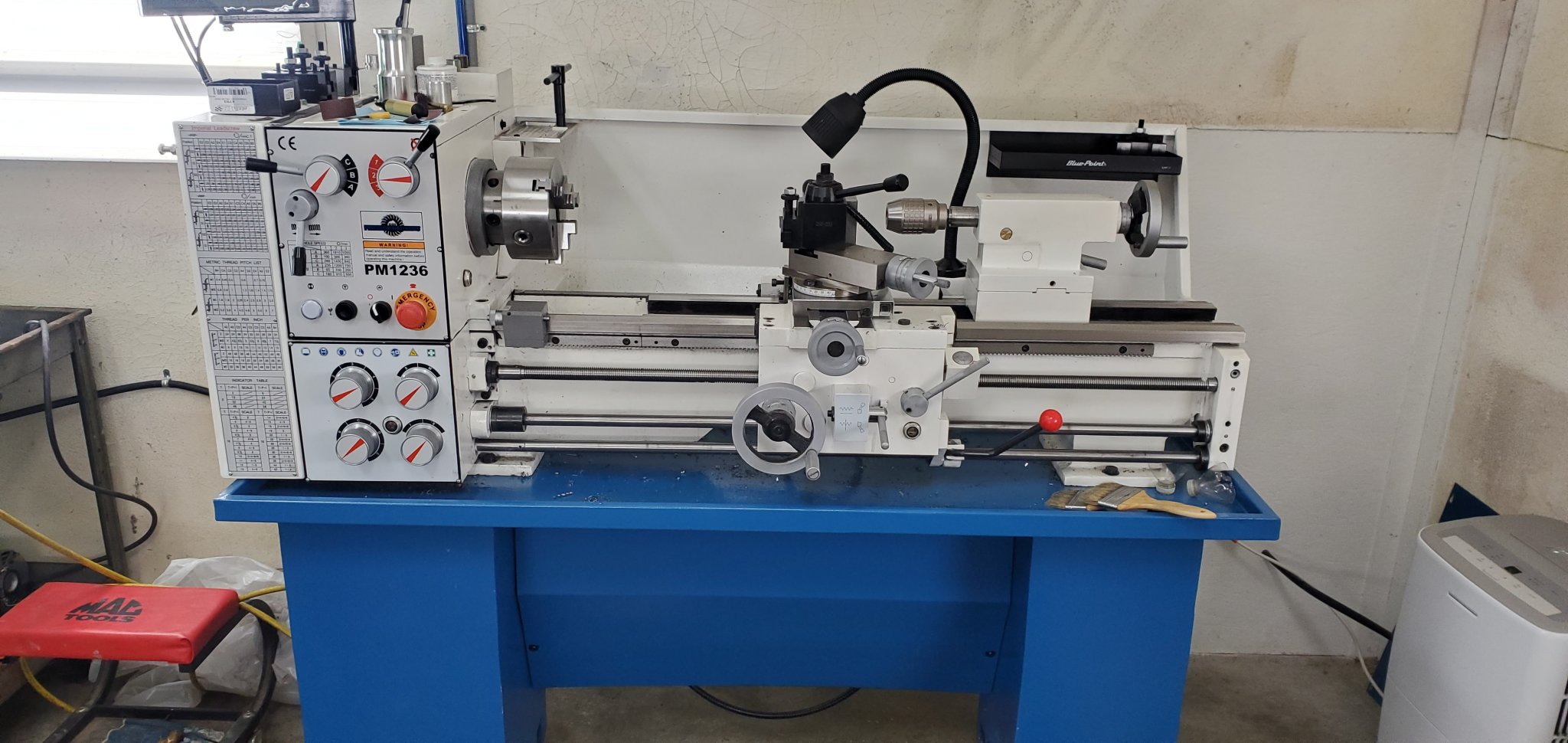

If you wanted to do just barrel work what Lathe would you buy.

PM has a new Taiwan made 12x36. But, to be sure, many a barrel has been spun and action trued on the grizzly 4003G.
I have the Chicom PM 1236, if the Taiwan made one would have been available, I would have gotten that one.
No complaints with mine, except the leaking oil. Not terrible, just annoying.

After lots of searching I went with the PM12x36 Taiwan.... On paper it seemed like the best deal and didn't want a china machine. But-- be prepared to wait-- the delivery date keeps getting moved back. Not regretting the purchase at all (and sure they would give me a refund if wanted) but if you want to get your hands on it quickly it may not be the best option.

Bit the bullet and bought four jaw , three jaw and collet chuck even bought the upgraded scales and display. Very happy with the setup it turns out some really nice work . Last night I opened up some 6.5 brakes to 9mm for a customer using one boring bar :) .
Edit to add Gordy had the 1440 in his setup before our class so getting to run it before buying sure helped.
