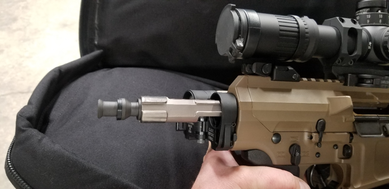

Has anyone gotten it to work? It’d be neat. I haven’t had hands on with the law folder, but read that it increases the length of your receiver extension - I know there is that plug that goes into your bolt carrier, but if you shaved that down. Do any of y’all think you could fit an a5 buffer and rifle spring in there?

Mine is on a AR10 6.5CM with a carbine tube.
Although I had to get a special BCG extension with a hole in it to work with the JPscs.

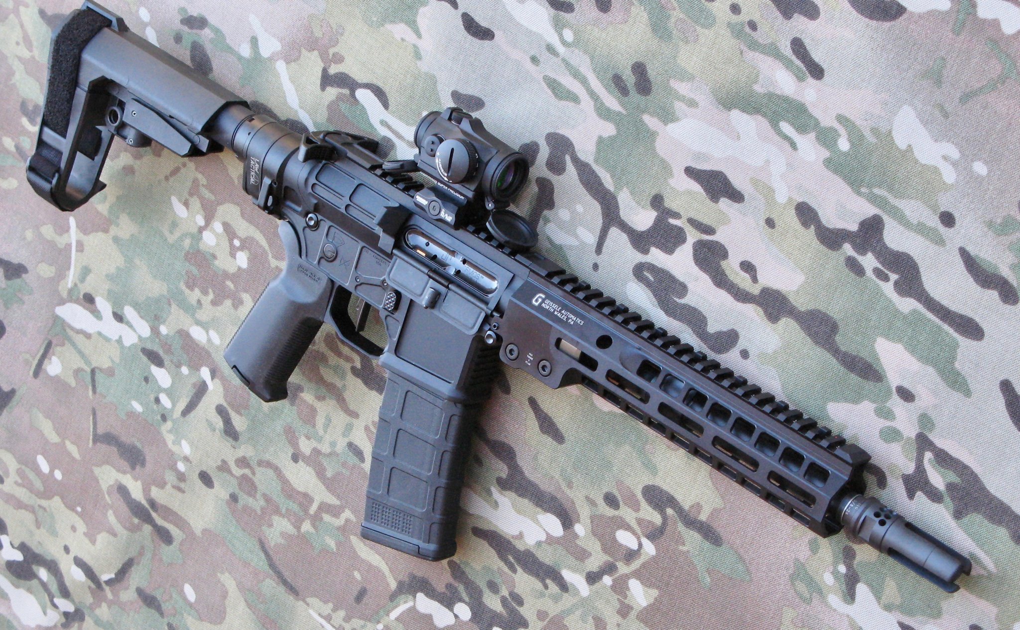

GarandThumb runs the A5 buffer system with his Law Tactical folder without issue. He has a YouTube channel. I'm sure you can search his channel and find the information you're looking for. Having said that I have a Law Tactical folder on my BCM 11.5 SBR. I also use it on my 8.5 inch 300 BLK upper. I shoot both suppressed without issue. It flat out shoots so I haven't messed with springs or buffers. YMMV.

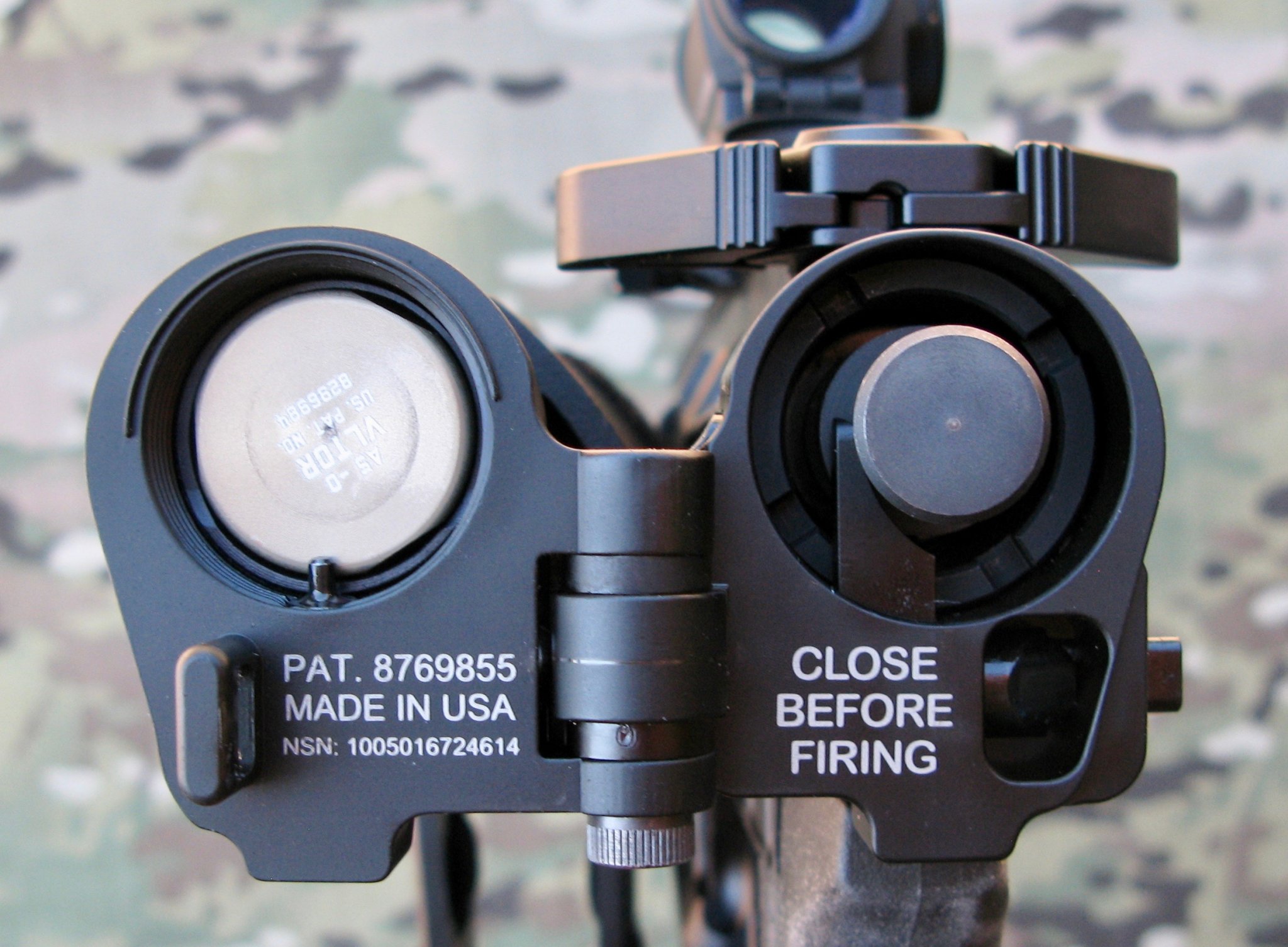

The OP is clueless. MSTN has posted the photo of the situation. There is no need for innovation / experimentation as the buffer / springs are simply changed by depressing the buffer detent; there is no fitment / dimensional changes to the receiver extension with the Law Folder. The bolt plug adapters are specific to bolt aperture diameters. I did have Wilson Combat turn down the diameter of the adapter to use in their 9 mm SBR, as the rear of the bolt had non-standard recess. A few of my SBR-folder setups.

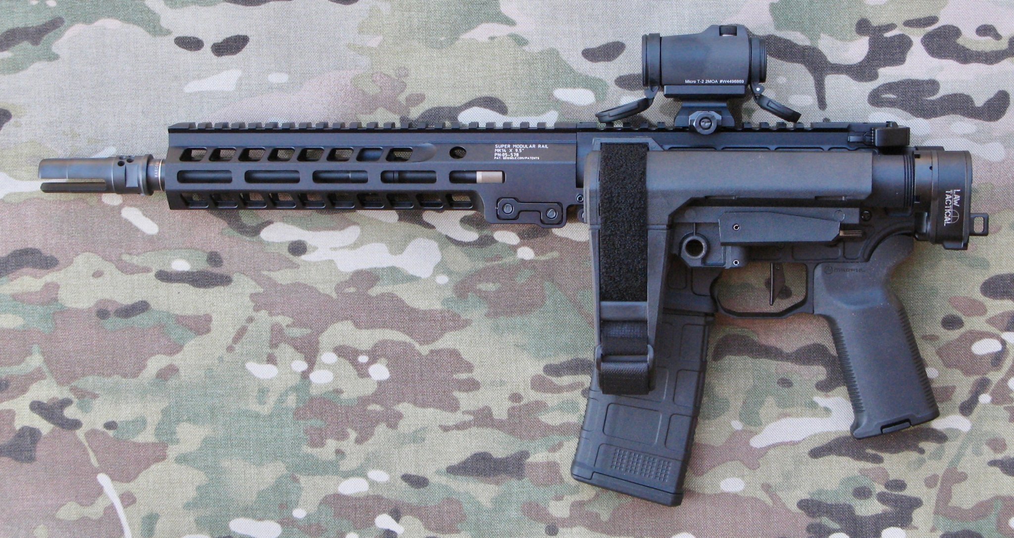

I have two BCM 5.56 pistols and shoot them suppressed with law folders and the A5 system. I have had zero issues out of 1000s of rounds thru them. I run the VLtor A5H3 buffer simply because I couldn’t find the A5H2 in stock anywhere. I am running the bootleg BCGs for gas mitigation as well. I went with Dark Angel buffer tubes which are about 3/4” longer than the stock tube. I was somewhat skeptical abt the ”felt recoil” reduction but I can honestly say that this system shoots extremely soft and smooth.
