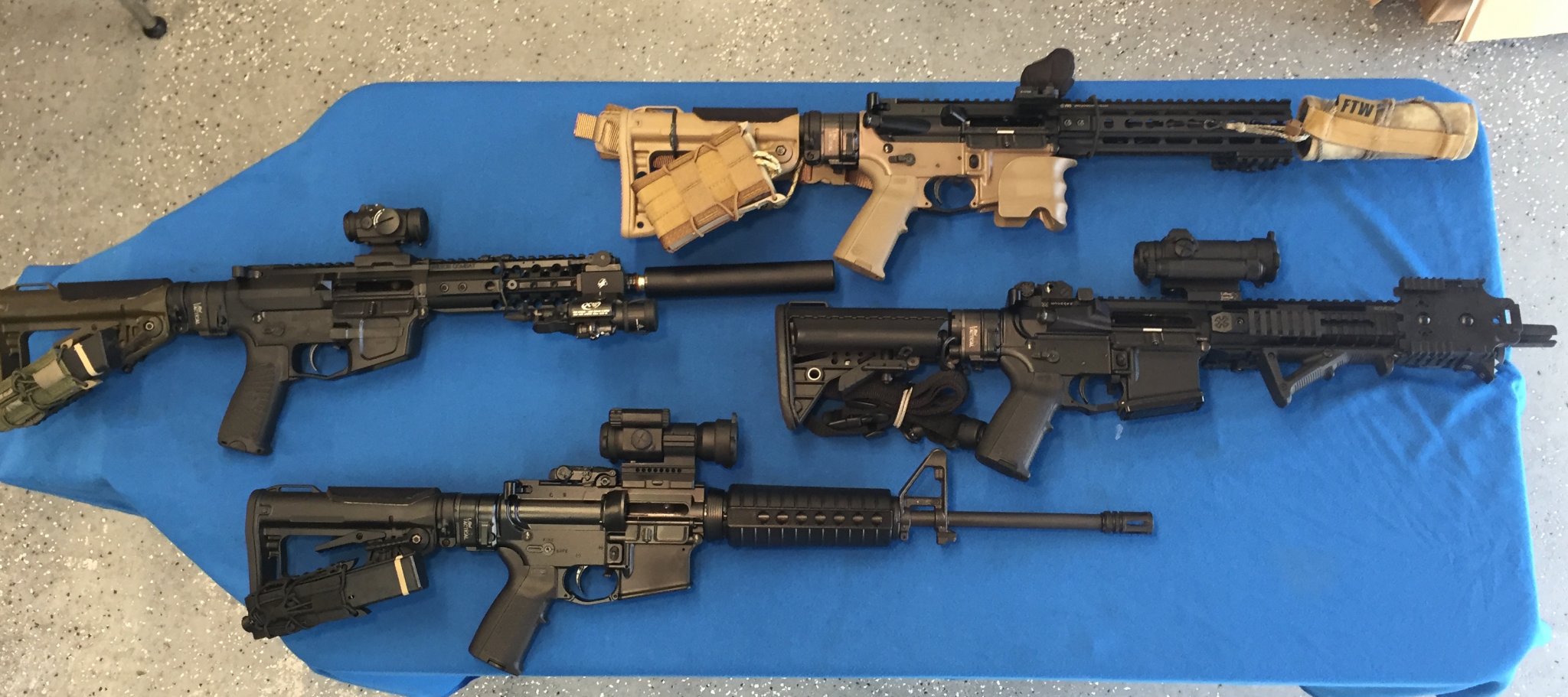

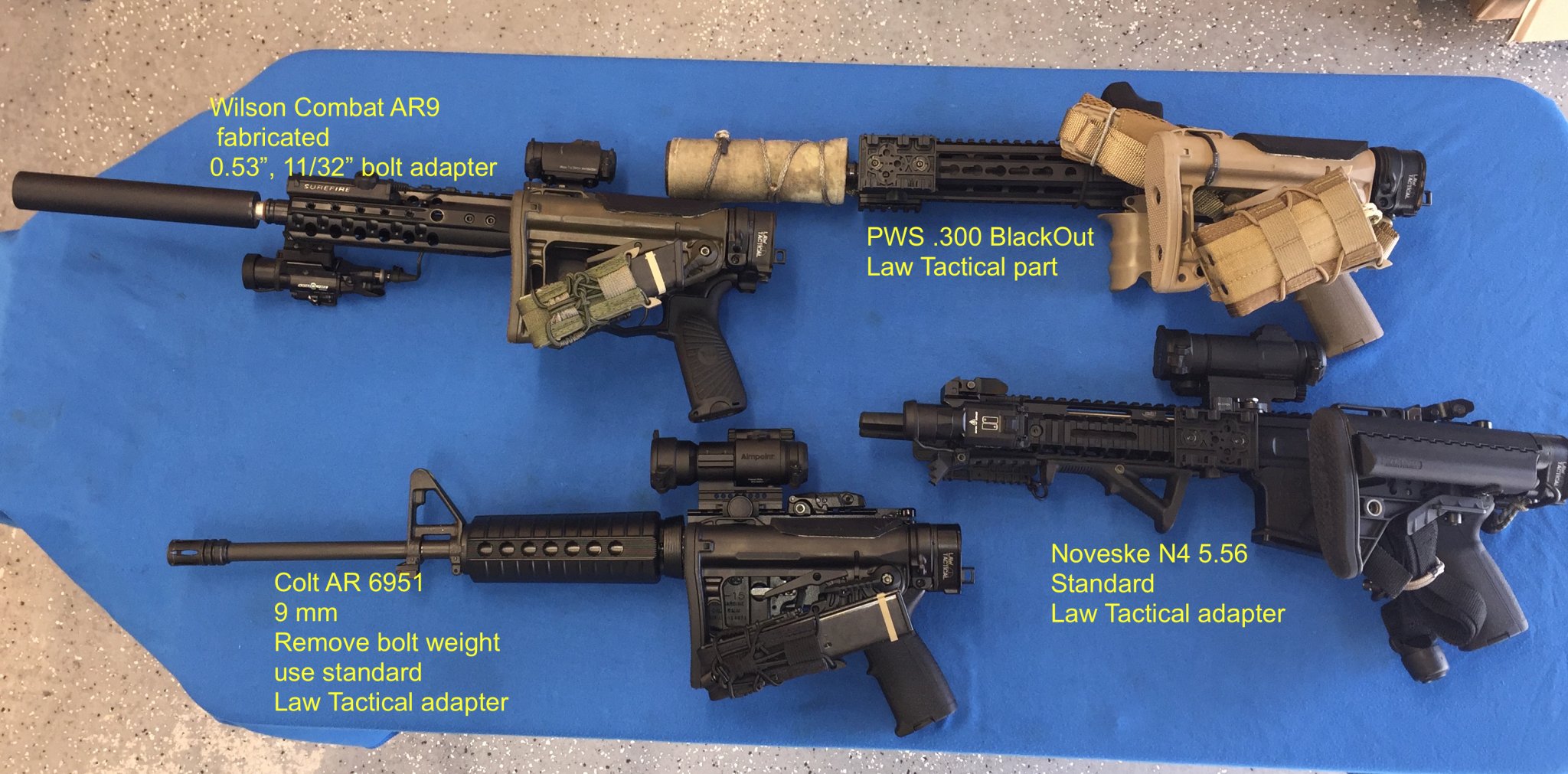

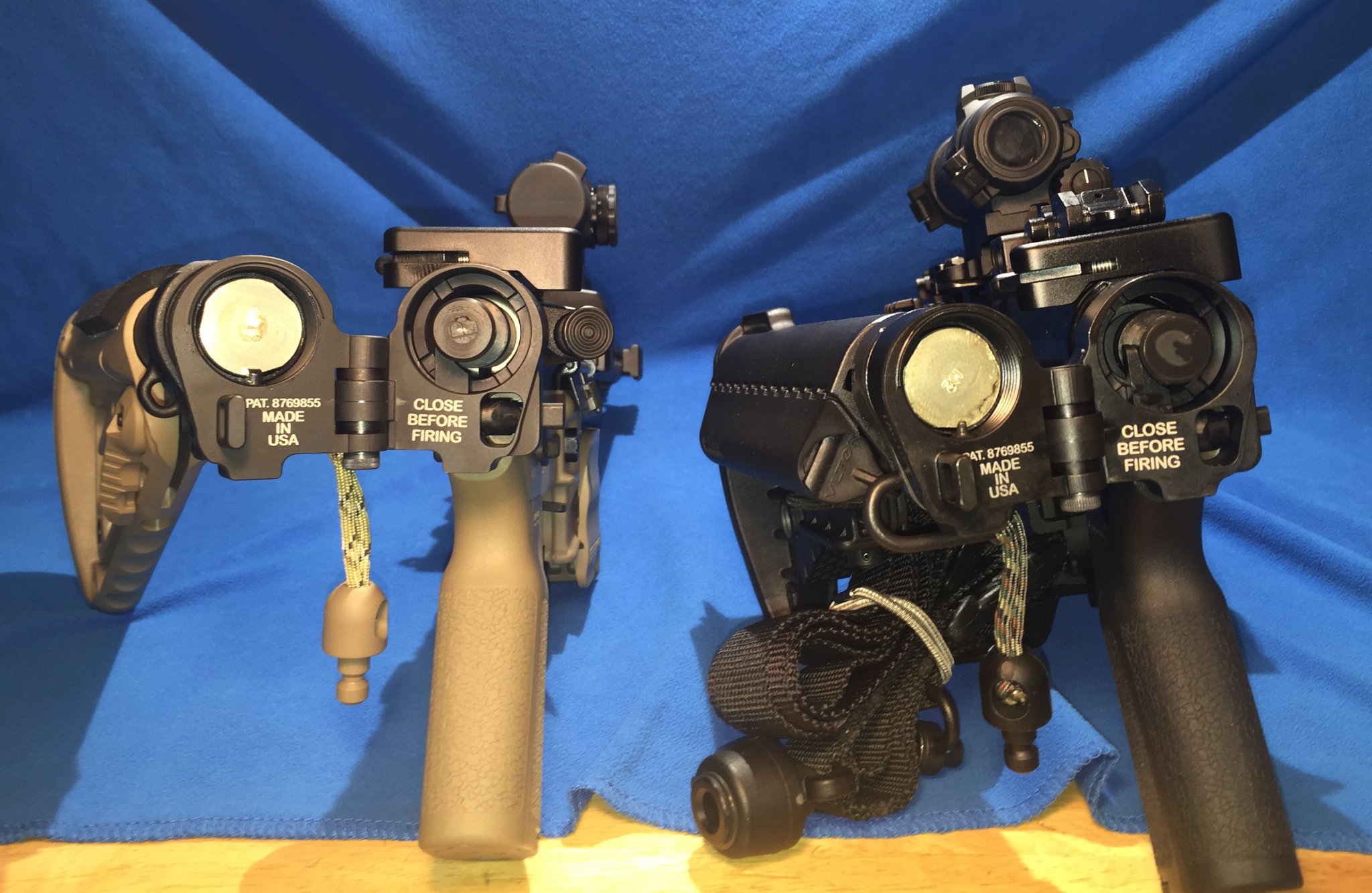

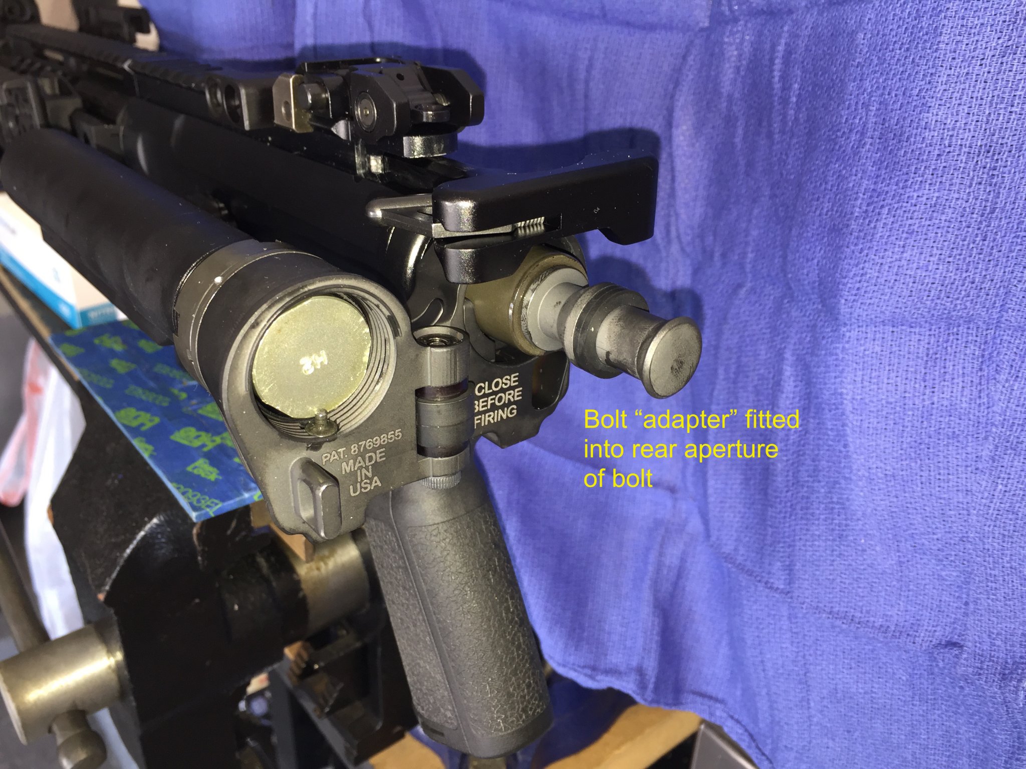

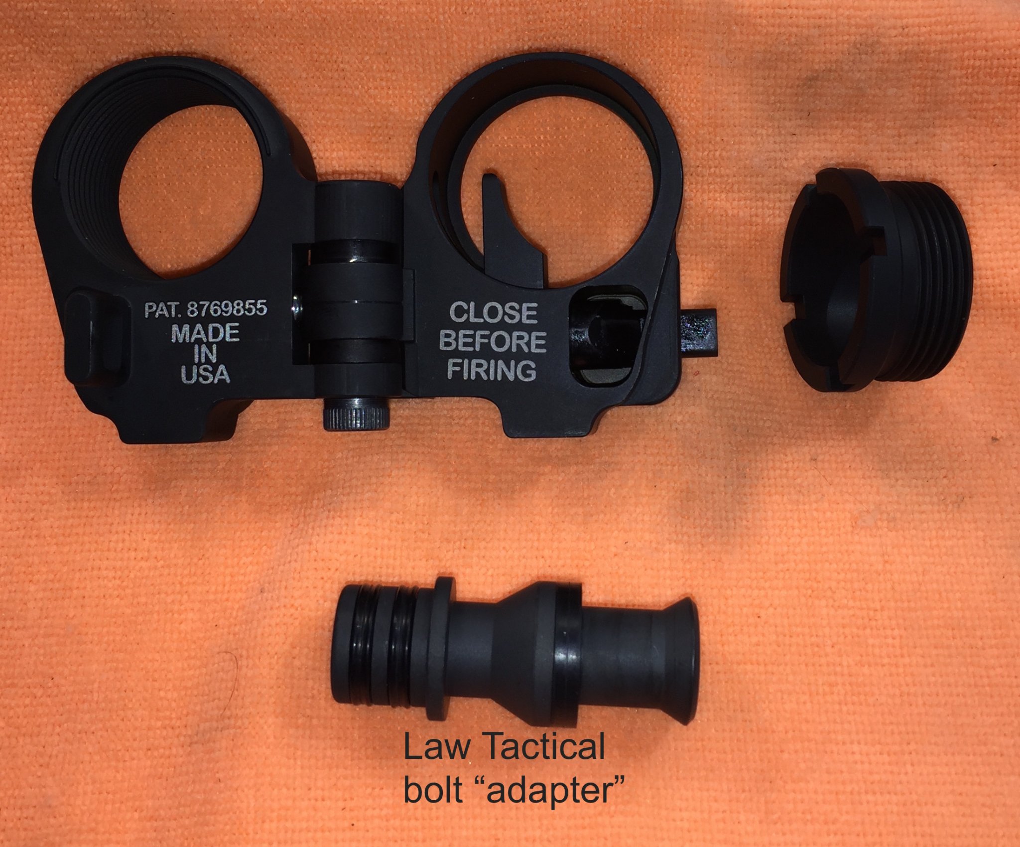

    These SBR's are not precision gassers, but I do use it for a HK MR556A1 match rifle. As mentioned the rear end of various bolts have proprietary sizing and / or weights to control bolt speed. I had Wilson Combat fabricate, i.e. turn the adapter O.D. down on a lathe to their odd size correct O.D. to insert for its use in a AR9 SBR.
    Some photos for those that may not be familiar with the device.
