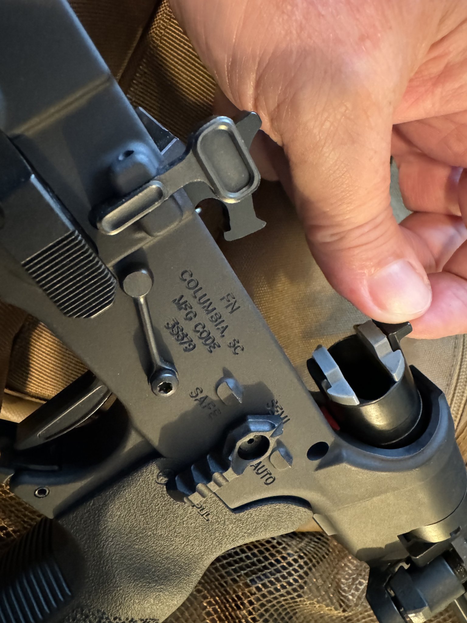

    Photo dump if it helps to give an idea of what’s involved taking down and reassembling. I pop pins with hammer up and slide upper forward, the rear cup slides forward no issue and off it comes as I slide cup slightly into upper receiver. Note, dust cover must be open for this to work…!
