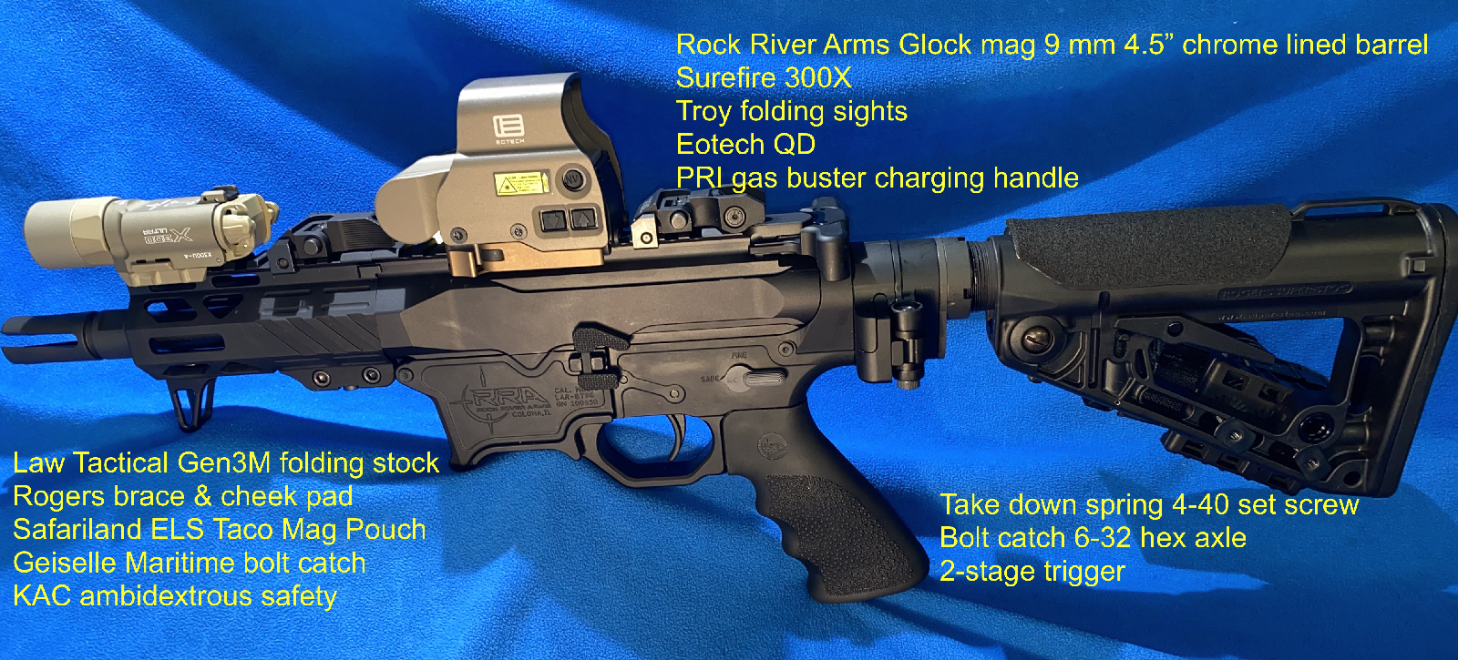

OP - I don't have any experience with Sylvan, but use the second gen LAW folder (made of aluminum rather than steel, so it's not very heavy), and as others said they do not lock open but have a friction mechanism in the hinge that holds them in place pretty well. I wish LAW had kept making them from aluminum, but they got too much feedback from silly people insisting they needed to be able to fire a shot with it folded, so they beefed the mechanism up a lot and made it out of steel. I like the light weight aluminum original versions better.
I use mine to put my 9" 300 Blk or 12.5" 6.5 Grendel in a backpack. It works really well for that, and with some practice it can be unfolded as it's pulled out of the pack. (One advantage of having it NOT lock in the folded position; it's much faster/easier to deploy.)

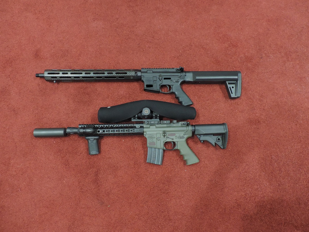

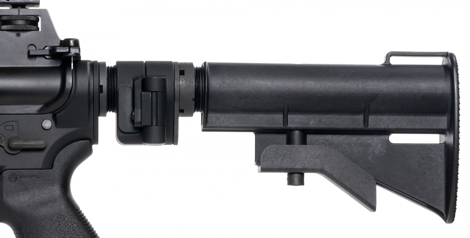

Just some thoughts from looking at the Sylvan folding hinge - it looks like a pretty close copy of the earlier aluminum LAW folders, except that it sticks out behind the receiver another 1/2" or so rather than being mounted flush like the LAW. Maybe that was to get around a patent issue, but it sure looks dumb IMO. I do like that it's lighter weight though.
The Sylvan https://sylvanarms.com/product/arh300/
vs the LAW folder: (note the early Pmag and aluminum LAW folder - I've been beating on this gun for a long time)

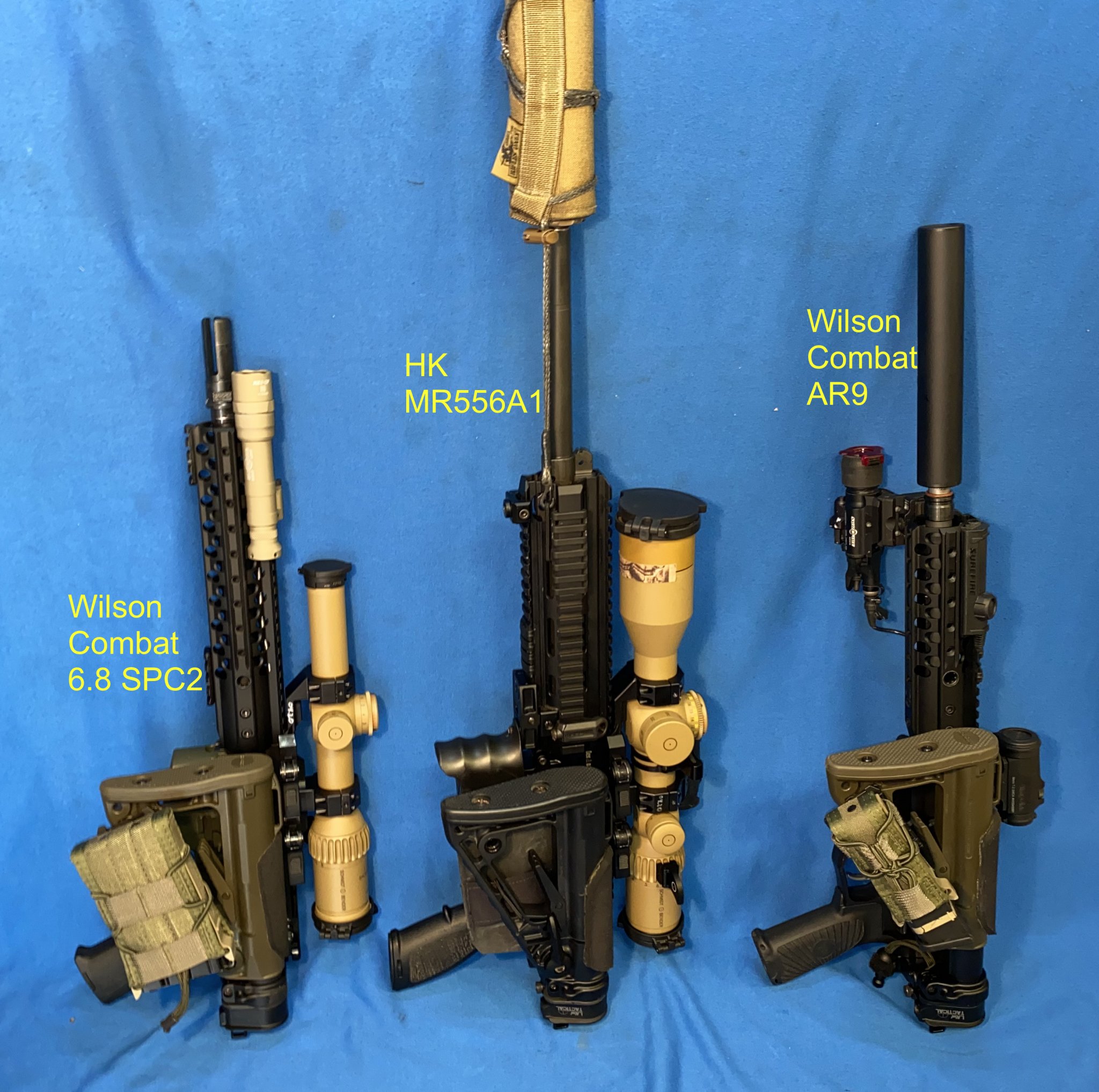

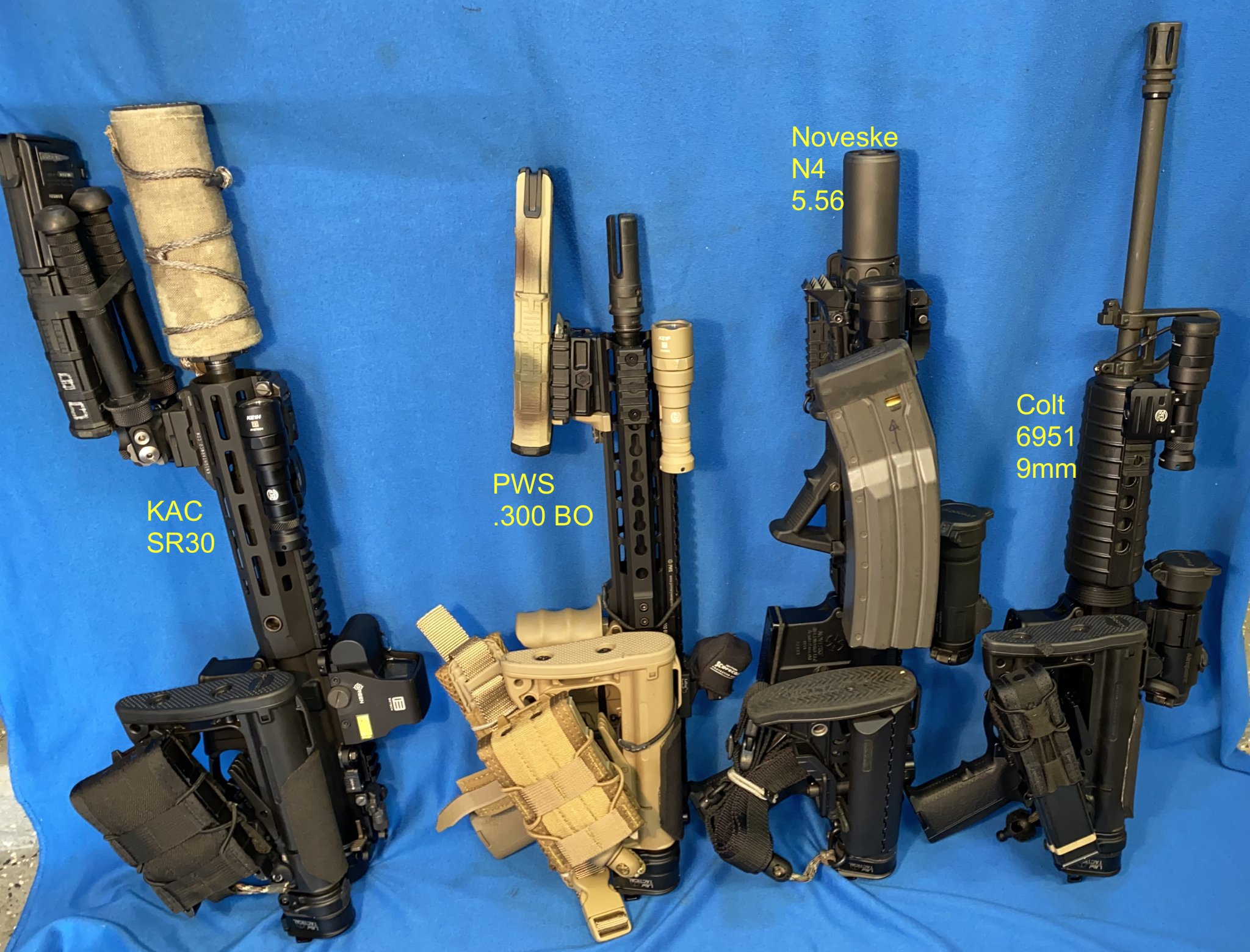

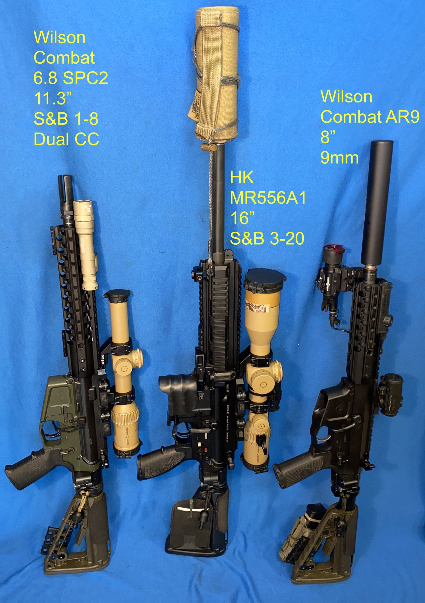

Recently though I bought one of the 17 Design folding lowers, which IMO is even better than the LAW folder. It's a definite step forward from the LAW, being about 1"-1.5" shorter in the folded position, tighter lockup, about 6-8 oz lighter, and generally a nice lower as well. Also at my price of ~$240 it was about the same price as buying a LAW without a lower to put it on.
I can try to post some pics if anybody is interested.
Fully agree that the LAW is hands down the better choice.

They are pretty new, haven't been out for very long. IMO the first real step forward since the original LAW folder was released. I normally avoid being an early adopter, but this seemed worth the gamble, and it paid off. Although I've heard these were being sold as part of a complete rifle by some other company for the past year or so, but forget who.
17 Design top, old gen II LAW below

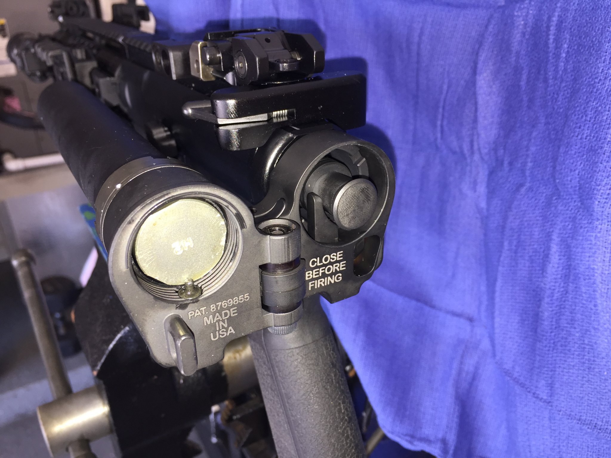

The reason LAW switched from aluminum to steel was customers wanting to be able to fire the rifle folded without damage. Even though LAW states it should be fired from the closed position, that’s is why the change was made. Is there any issue with firing the 17 Design lower in the folded position?
LAW states that you might need to replace the O-rings after firing folded, but I haven’t found that to be the case.

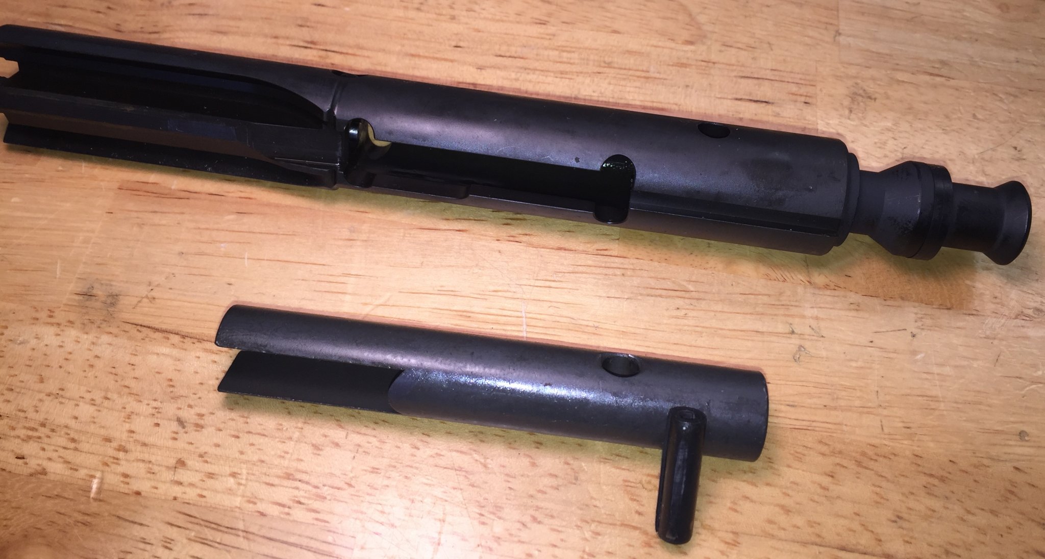

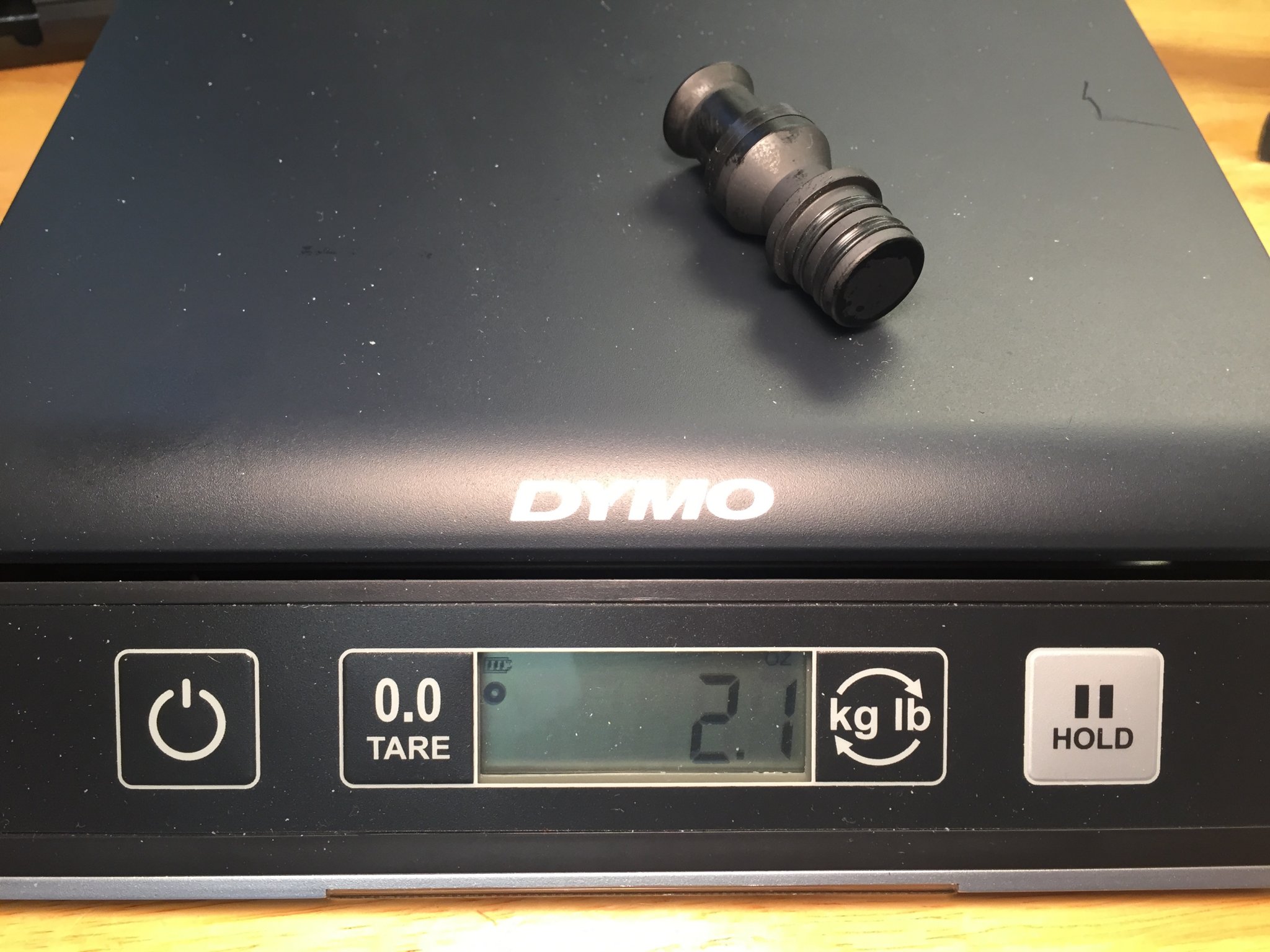

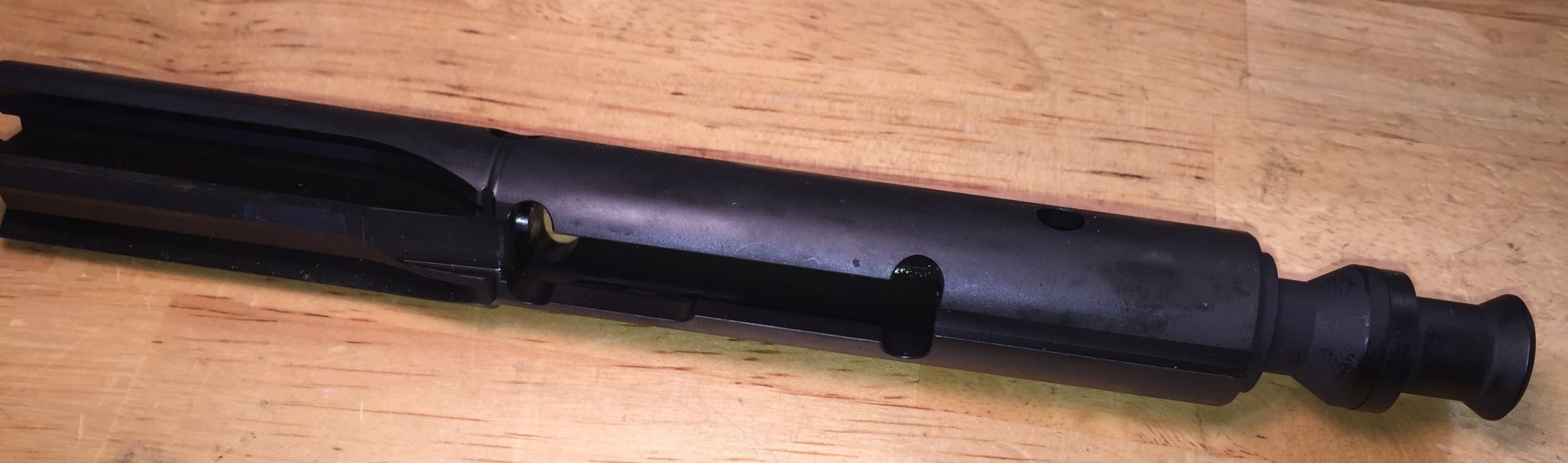

The "adapter" is installed into the rear of the bolt, it does not add weight to the buffer. It adds 2.1 ounces of weight to most reciprocating bolts however some 9 mm carbines have bolts with pinned weights to slow the bolt speed down, in theses circumstances, the total change in bolt weight, if any, is the difference between the removed bolt weight and the installed adapter.
Law Tactical Gen 3M Colt AR6951 Adapter Bolt WeightsIMG_4763 copy CROPPED copy.jpg
Law Tactical Gen 3M Colt AR6951 Adapter Bolt WeightsIMG_4763 copy CROPPED2 copy.jpg
View attachment 7669725View attachment 7669726
Yeah should have said bolt not buffer, but I’ve had to lighten the buffer in two rifles now to account for the change. No big deal but something to keep in mind
