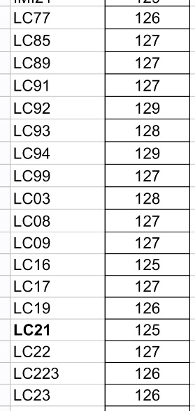

    In a non scientific test of LC 556 brass I used the AMP Aztec function to see how the codes across several years compared.
    They obviously produce these by the millions but they look to be fairly consistent for the samples I have.
    For a total of 54 different headstamps of 223/556 the overall average code is 130.

    Today I used 5 once fired LC17 and ran them through the sizing die to uniform the necks for testing. All 5 are code 127.
    Found another 10 different years of LC and after including those the LC only average is 126.
    The average for all 74 cases dropped to 129. T and Wolf were 142 and 138, respectively and the two highest codes.

    I have over 20 different years of LC 556 and they test between 125 to 127. For mixed LC 556 I use 126. Works fine.
    I also have a very large batch of LC21 and everytime a primer pocket gets loose I analyze it. So far they are consistently testing at 125.
