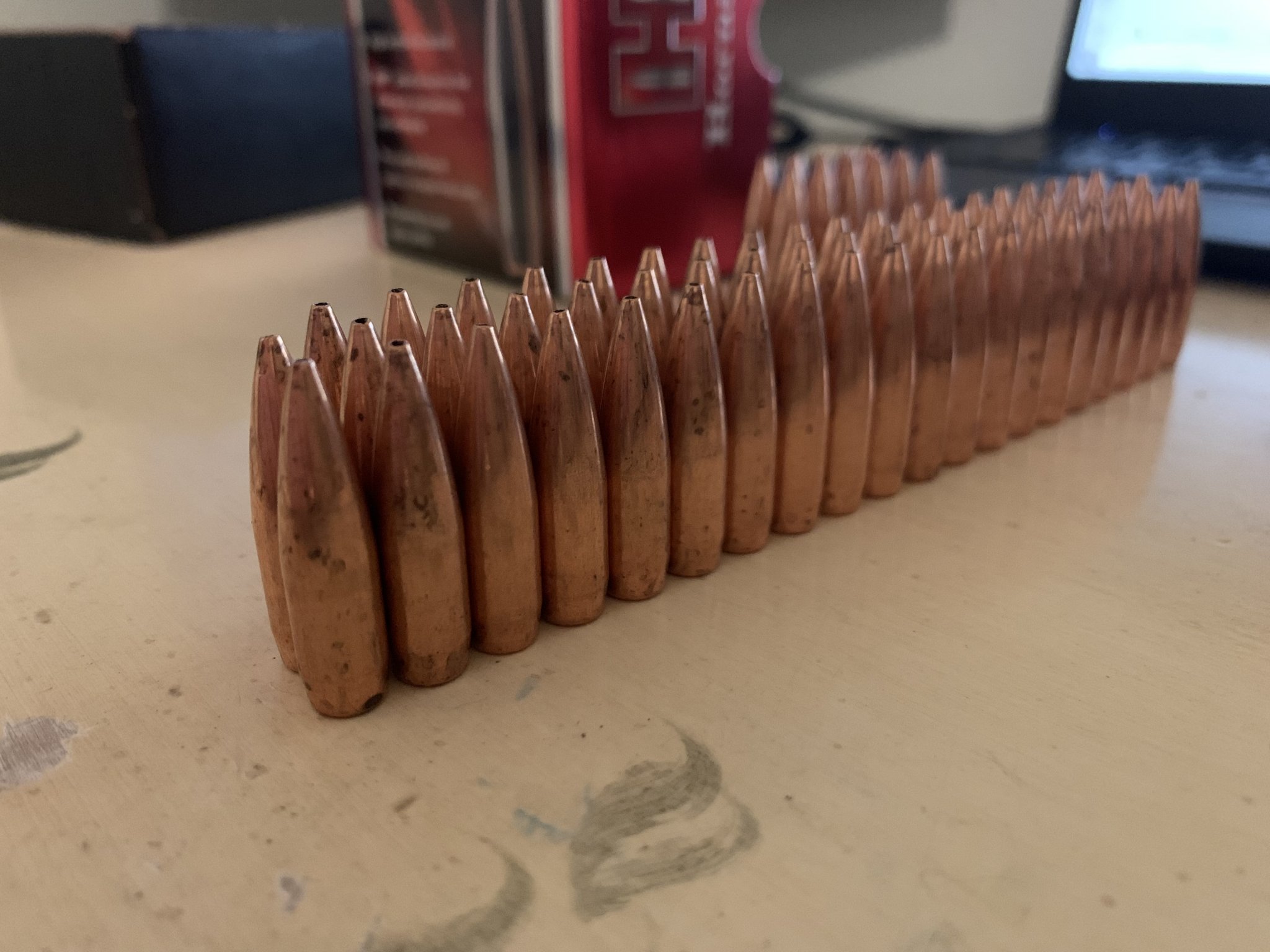

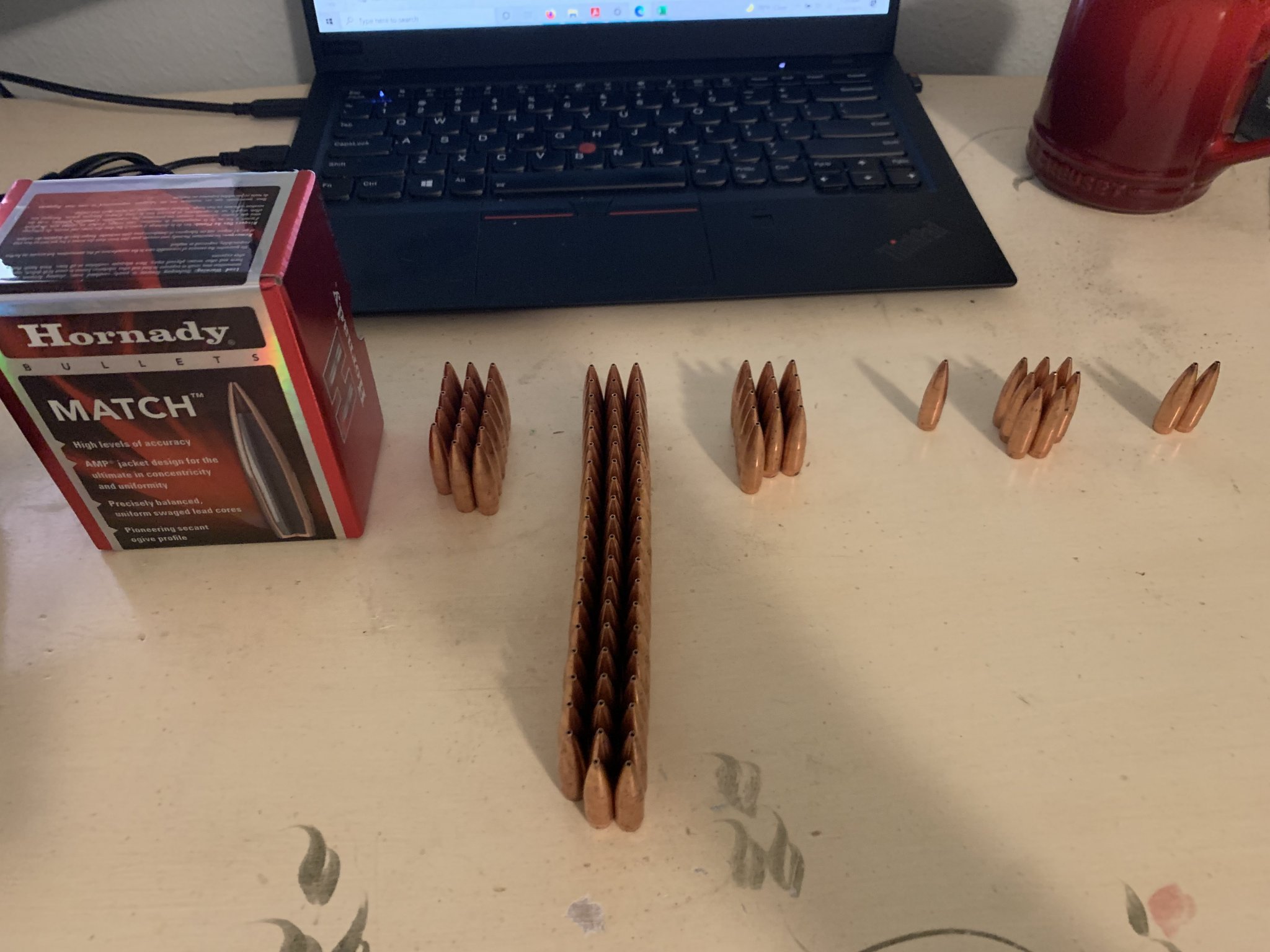

So just did some measuring.
Thousandth's differnce
Count
Hornady Match
-1/0/1/2/3/4
5/16/16/5/4/1
Sierra Tipped MatchKing
-1/0/1
13/50/6
Hornady ELD Match
0
50
I stopped measuring the Hornady ELD Match at 50 because the most difference I saw was about a pointers width from 0 on my calipers. Can't wait to try loading those!
I've got another unopened newer box of Hornady Match. Will do some measuring on those sometime.
I haven't checked the base/ogive. Are bullets really that inconsistent in this case?
I do anneal, though for this batch I decided to not anneal after the last firing.
I haven't specifically lubed the inside of the necks and no force pack, though I can tell the seating forces aren't super consistent.
How much would seating force really impact seating depth when the bullet seater bottoms on the die body? I recognize that neck tension is another variable to track, I just haven't gotten to that step yet.
Then this has nothing to do with the die at all. This is inconsistency in your process causing inconsistency in your ammo.
Reactions: nn8734
Yes. Take measurements to ogive. If I seat with a chamber die, I seat halfway way spin 180 +/- then seat the rest. That helps not only seating consistency but also concentricity. This method also works with standard seating dies too.
The measuring part 2.
New box of Hornady Match 168gr BTHP. Grouped by 0.001" increments.
