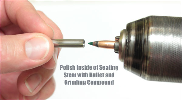

so I have an le wilson seater which uses a small arbor press to seat hornady 178elds 308 and the stem Marks the bullet. I bought a vld stem and this does the same thing if not worse.
I tried my old lee bullet seater using the lee press and its absolutely perfect, no Marks.
am I doing something wrong? could I have been sent a non vld stem? anyone use a le wilson seater with eld bullets in 308 successfully?
Just polish it.
I have used the method Spife illustrated several times and it works quite well.
Just don't get to overzealous with it and sacrifice a few bullets if needed if they start showing a non uniform surface from the lapping compound removing the softer jacket material.
Reactions: porter_jamie
