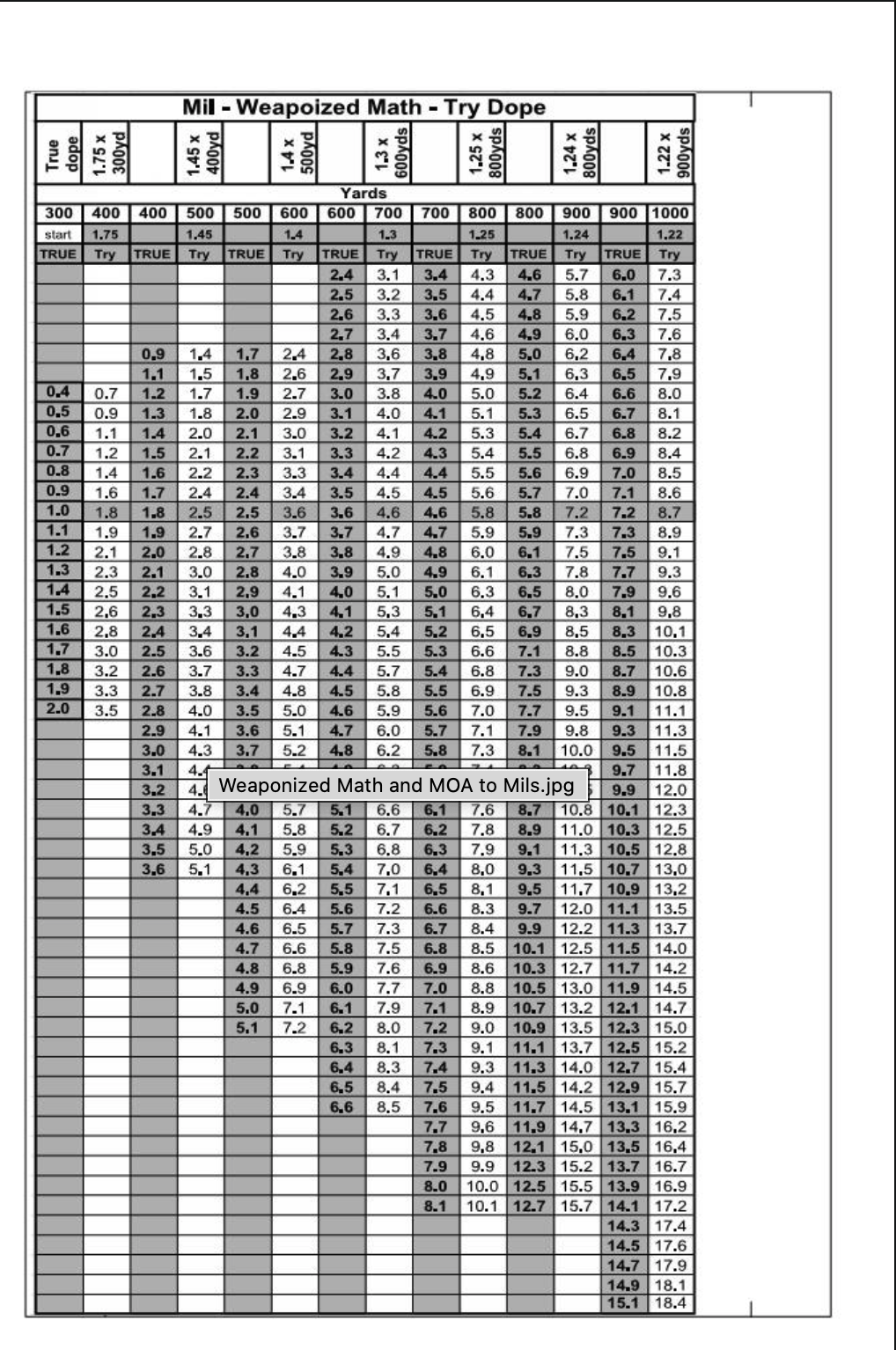

if you truly want to "Learn" ballistics in any meaningful way, an App is not the answer. You shot and record actual data then line up the computer to match so when conditions change, the necessary changes to your data are handled seamlessly.
Here is a better way of learning and doping your rifle that is not caliber specific, and will work for both Mils and MOA.
It uses real world data from your rifle system and gives you dope out to distance minus all the App variables.

A ballistic calculate is to manage your changes, understanding you have to adjust the computer to match the rifle as the rifle can never match the computer.
Thank you so much this is so helpful! Guess I have a lot more learning to do then I thought.
Downloaded the ballistics app you mentioned so I will give this all a try this weekend. Appreciate the help so much!
