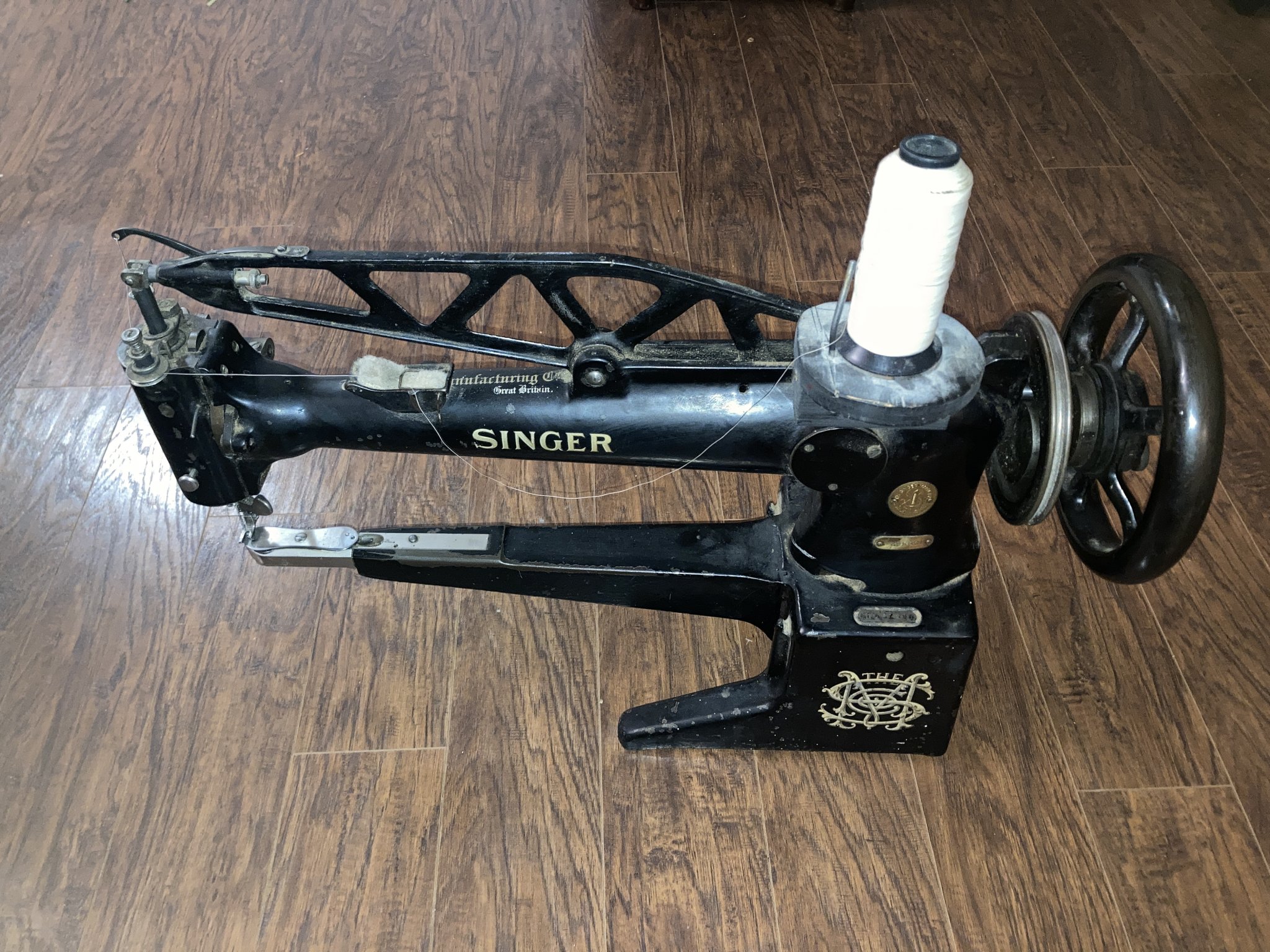

Post your pics or projects or project ideas we can try. Maybe moccasins, wallets, sheaths, etc?
Or stories related to these or leather projects?

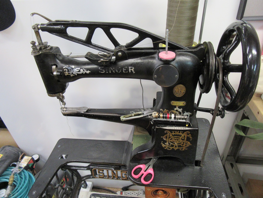

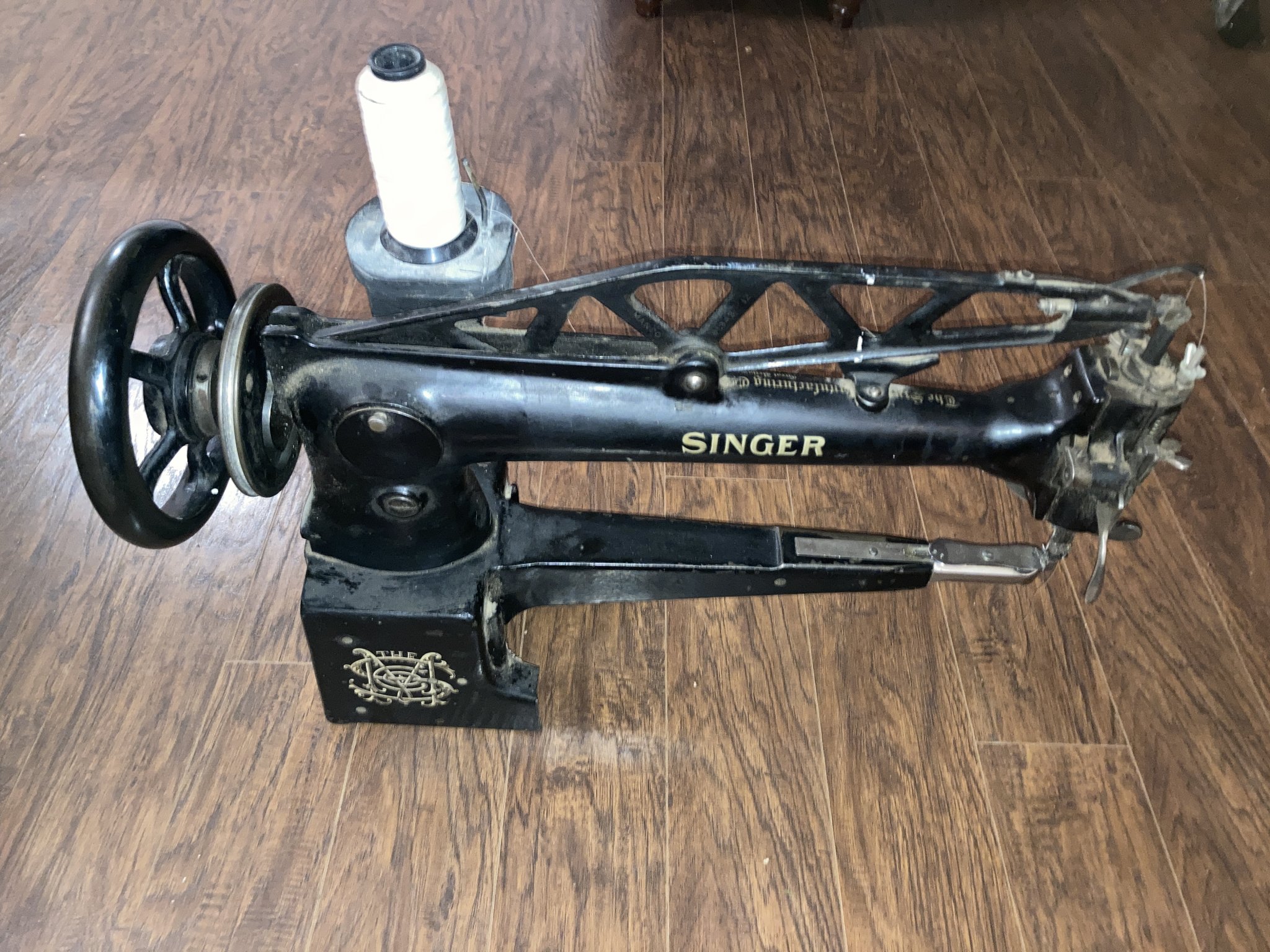

Singer leather sewing machine. Model 29K60, serial #ED847866, looks like mfg in July 1946.
I was given this thing and told “I know you can figure it out and get some use out of it.” 😎 So I need to order a manual for it, clean it up and oiled, get some leather, and turn the kids loose with it.
Complete and works, has the treadle base, a motor and clutch type attachment, and a box of parts needles and thread.

View attachment 8177598View attachment 8177599
Patching machine, they are good little machines. You can do a lot with one, I prefer a foot tread on these machines.
model #29's are ' Patchers ' . they are worth their weight for Repair, or reaching into an area for stitching that you can't do on the regular flat bed, post bed, or larger cylinder arm machines . It's design really not for a production machine with doing long runs of stitching . reaching into Shoe/boot repair and other items is where it shines doing both Leather and Textile .
The model #29's small slender cylinder arm, with small Bobbin assembly, and small Bobbins don't hold much thread . But it small for reason and that makes easier to reach into small area's for repair .
It easy handle #69/text 70 thread , probably maybe ? set tension, needle and bobbins for #138 thread size . Easy to time the machine to use common 135x16 / 17 needles .

Ah I see what yer saying, it is a small bobbin. Thanks for the info!
Started our leather business with a 29K. Worked it for a while, upgraded to a Ferdco 440 for a couple years, then the right deal came up on a Cobra class 4. Bags, belts, wallets, holsters…… you’ll find it’s undersized for thicker veg-tan but will work fine with 4-5 oz chrome/oil tan. …. As long as you can get the timing of the machine right. PM if you want some scraps to try out
I keep an old 29-4 in the corner. it is at least 107 year old machine that I went through, rebuilt several years ago . Also sand blasted and industrial powder coated the Treadle, with paint/gold leaf the Singer Manufacturing Co. emblems . I put the Treadle on Caster wheels so I can wheel it out and use for repair or a stitch tack when needed.
The 29's are one of those Machines that are not used that much... BUT when you need to use, , YOU REALLY Need It .
Half the worlds sewn together with needle and thread ...LOL .. I can go on for hours boring talk about stitching machines .

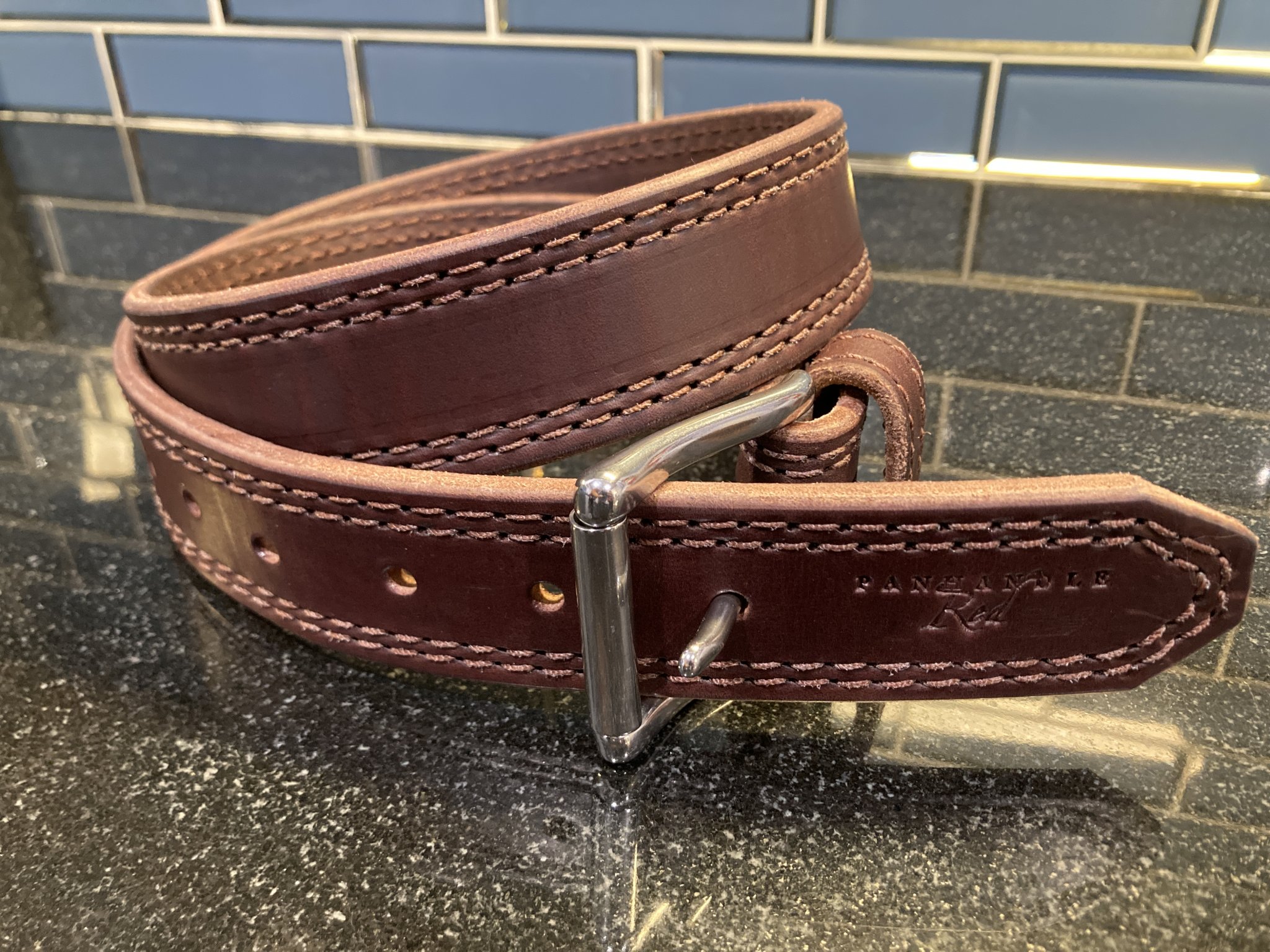

I got one of those Cheap Chinese leather machines. I think it was $115 on Amazon. The learning curve was pretty steep and it took a lot of research to get it timed and working properly but I’ve been getting decent results with it. *Don't look at the rough edges or the jacked up attempt at stamping patterns--just look at the stitching. :ROFLMAO:
Yeah! That’s awesome! My Blackhawk is crying for a holster and belt

Fantastic work from “Panhandle Red”

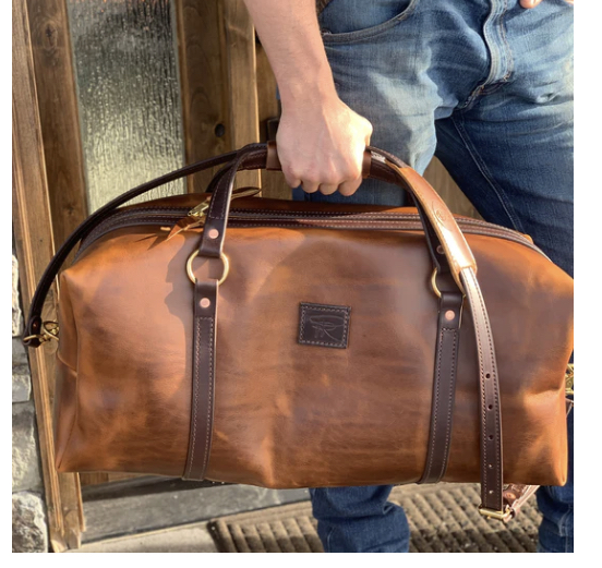

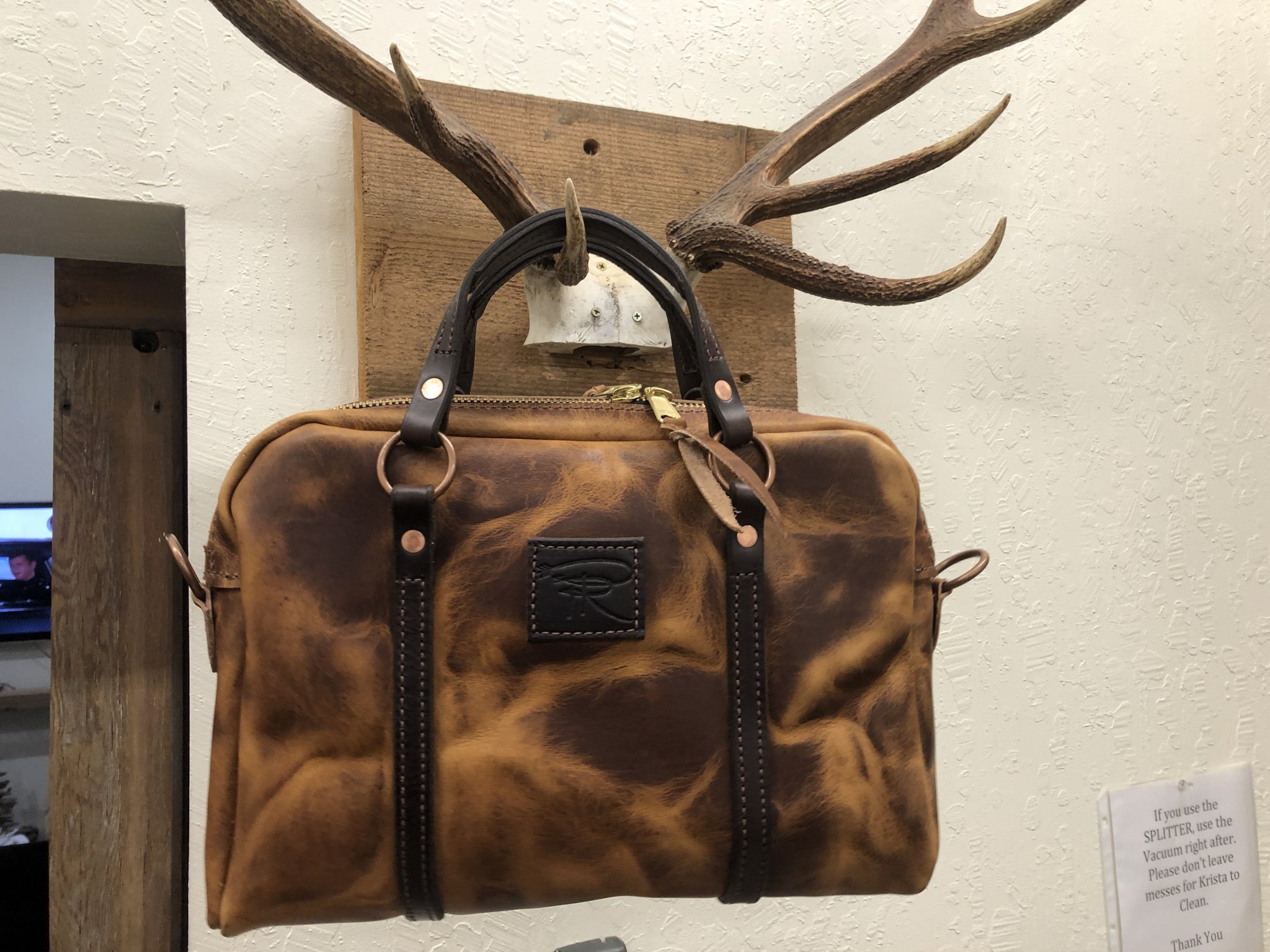

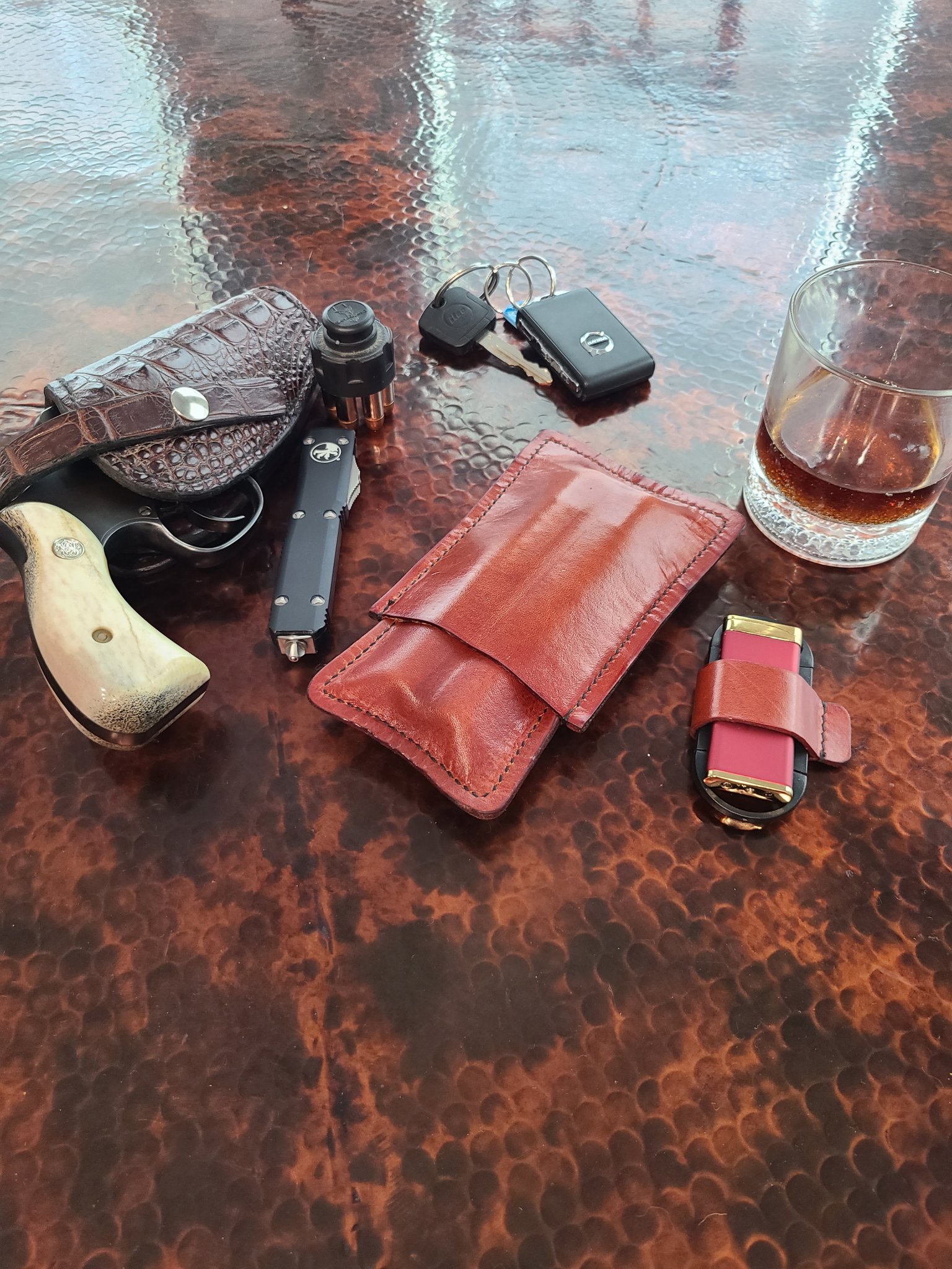

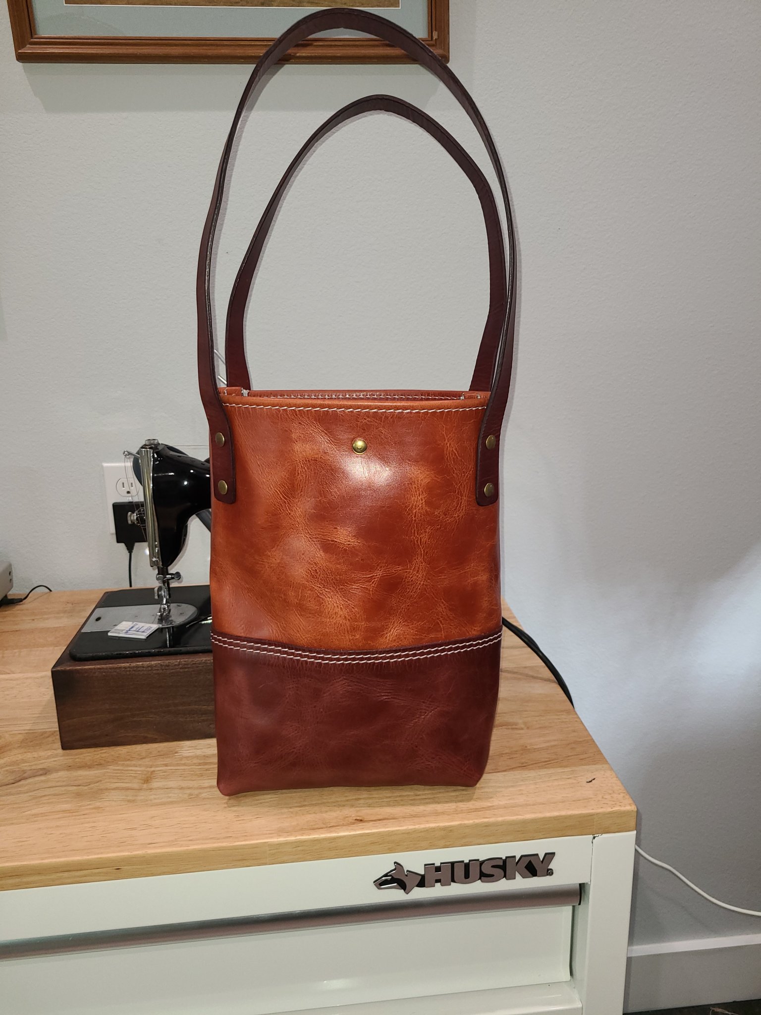

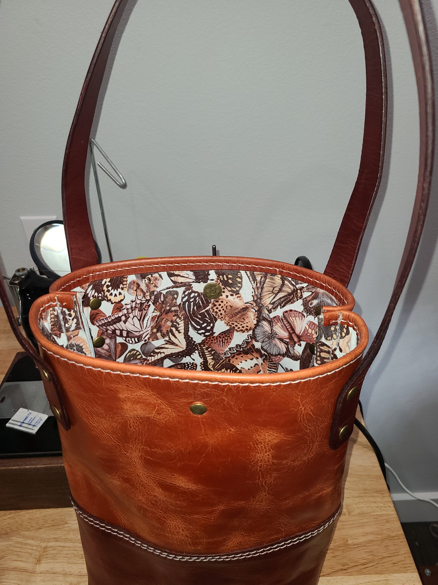

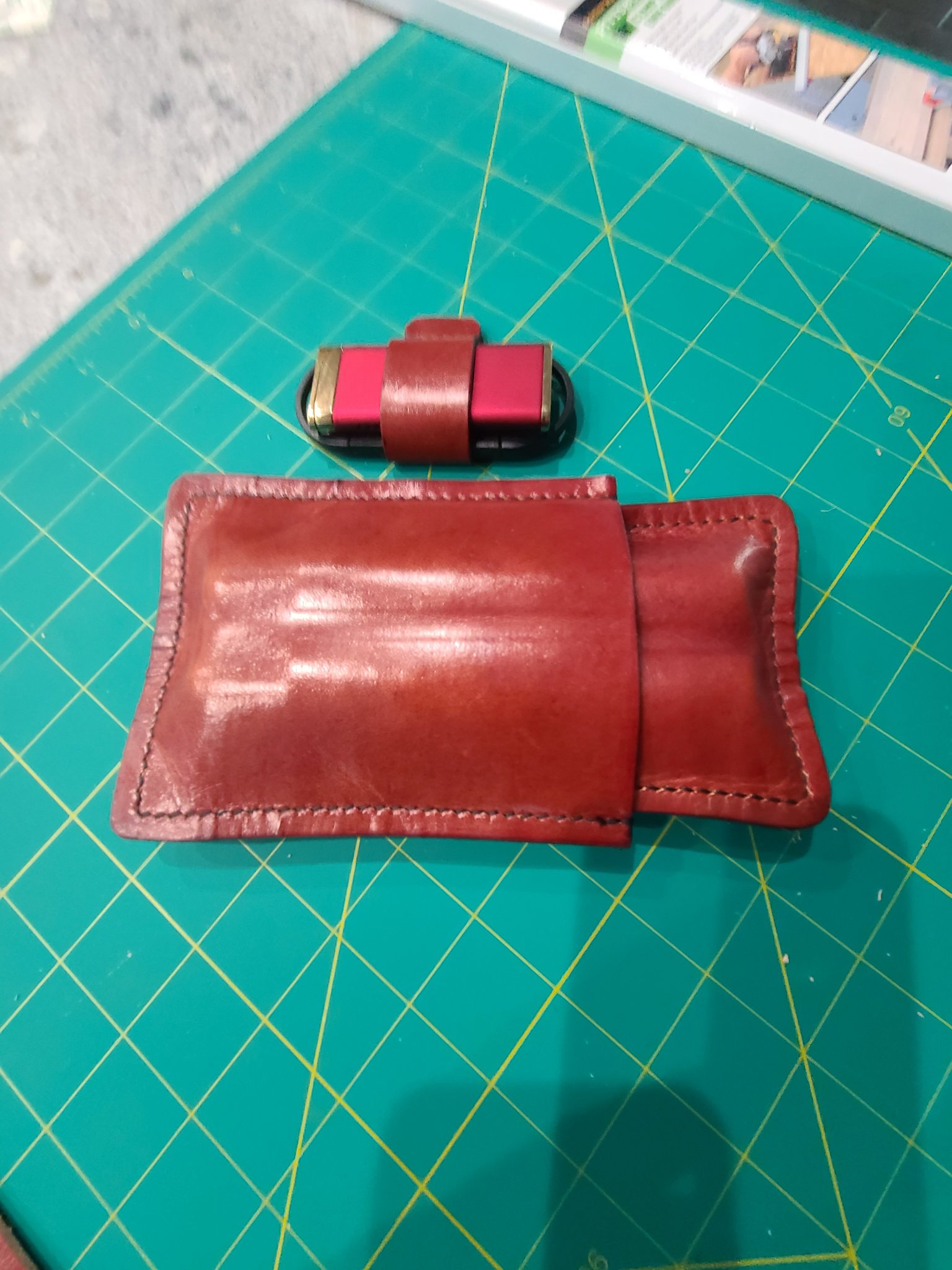

I’m not real good about taking pics of stuff, but finished up the messenger bag last night, couple holsters today and a few from last week- along with a pretty cool meat cleaver sheath.
I 'really' like that Bag with the distressed leather look. That looks like a nice pattern you worked-up for that . Did you also line it with anything ?
I’ve messed with the liners on a few bags, but really don’t like them. I typically use 5oz ish leathers on bags and the additional weight added coupled with the differing wear characteristics between quality leather and just about anything else made me just eliminate the liners altogether. First time I did one on a duffel bag, it doubled the labor, weight etc and made it kinda clumsy, for lack of a better term. For pockets, etc… I’l build them with the same bag leather and either stitch or rivet them in. The messenger bag has inside pockets as does the duffel. Here’s one I finished up last week
