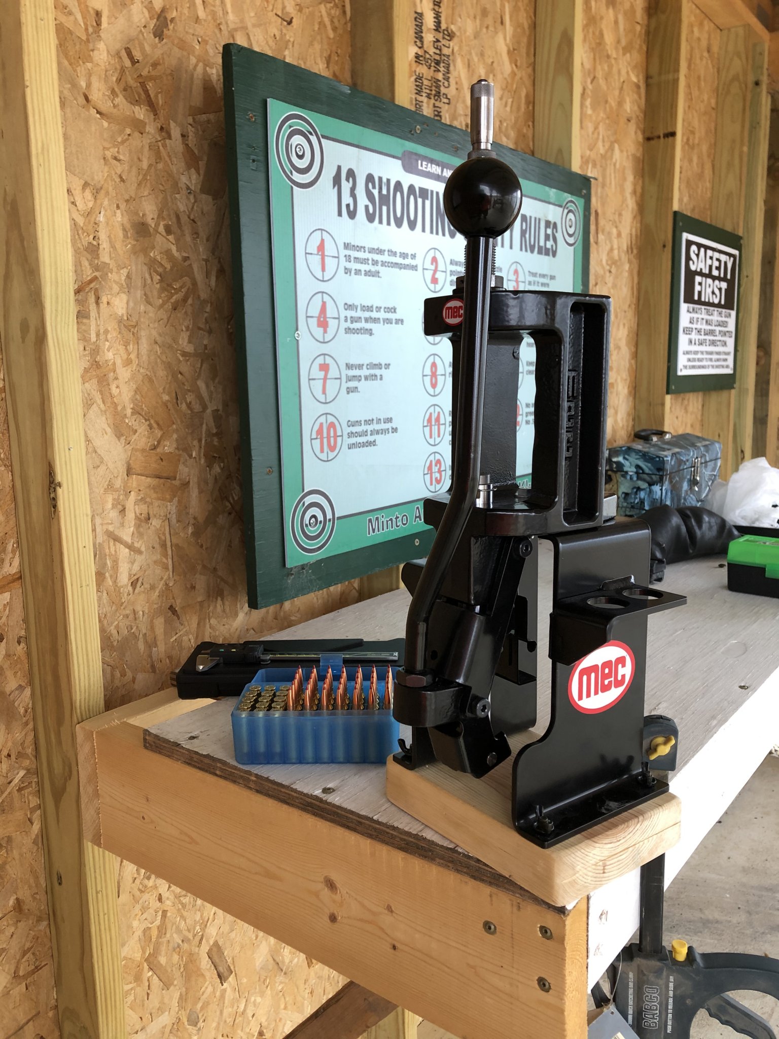

    I loaded 100 rounds super long and took my press to the range with me to adjust seating depth. Worked really well. I already had the charge weight I knew I’d be using

    The marksman or the forester coax is going to be my next press. Nor sure which yet though
    I freaking love my Marksman. The ram operation is so buttery smooth and effortless it should be illegal. Some people complain about it’s spent primer catching system but I decap all my brass on my old Lee Challenger press anyways so that wasn’t a big deal to me.
    I’m averaging less than 0.001” of runout on the bullet
