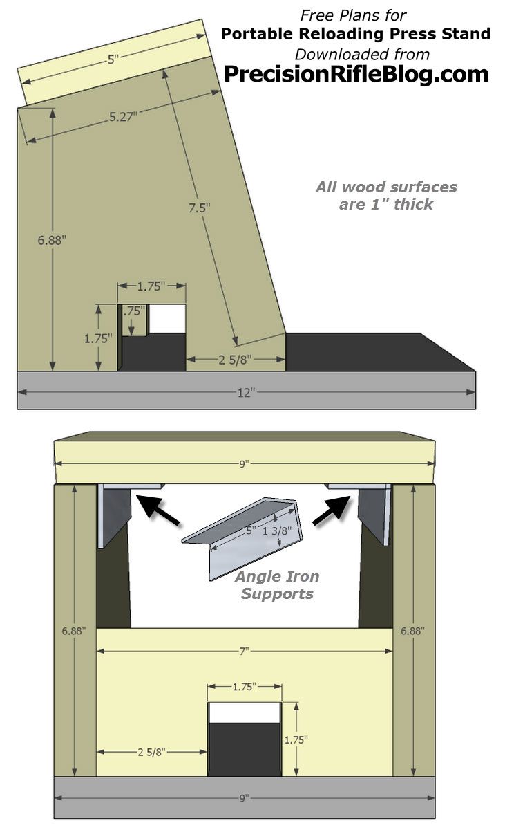

    I used a partner press on a B&D folding work bench for years when I was single and living in a 1 bedroom apartment. It worked well; much better than a hand press. There's also plans floating around on the net for a portable reloading box mount that works well for many.
    Looks like this...
