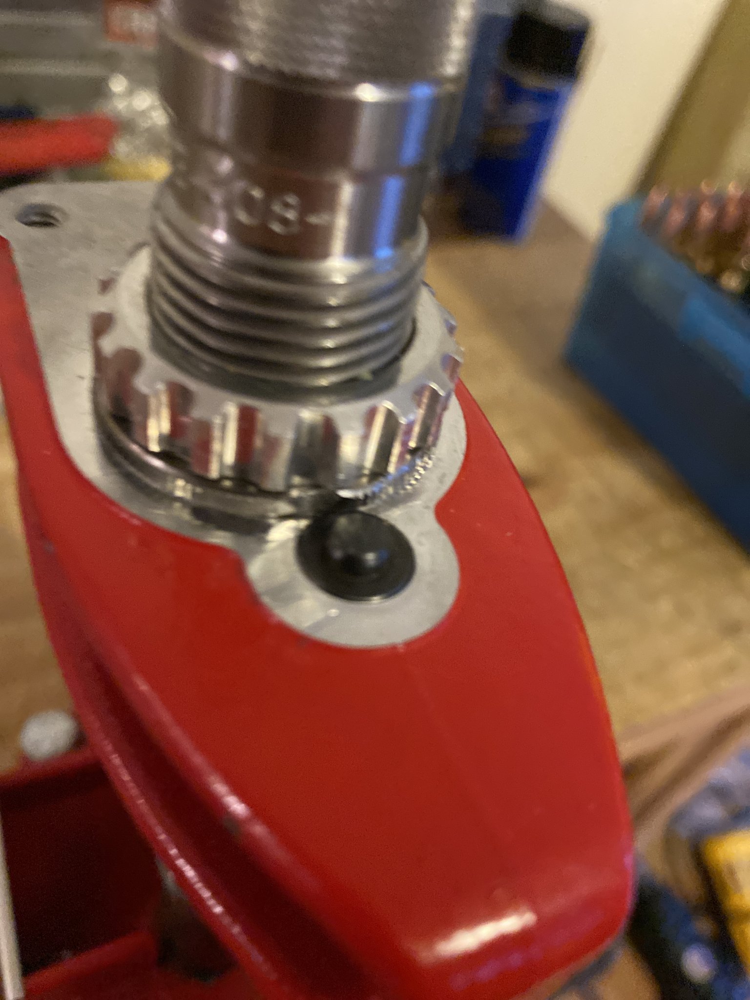

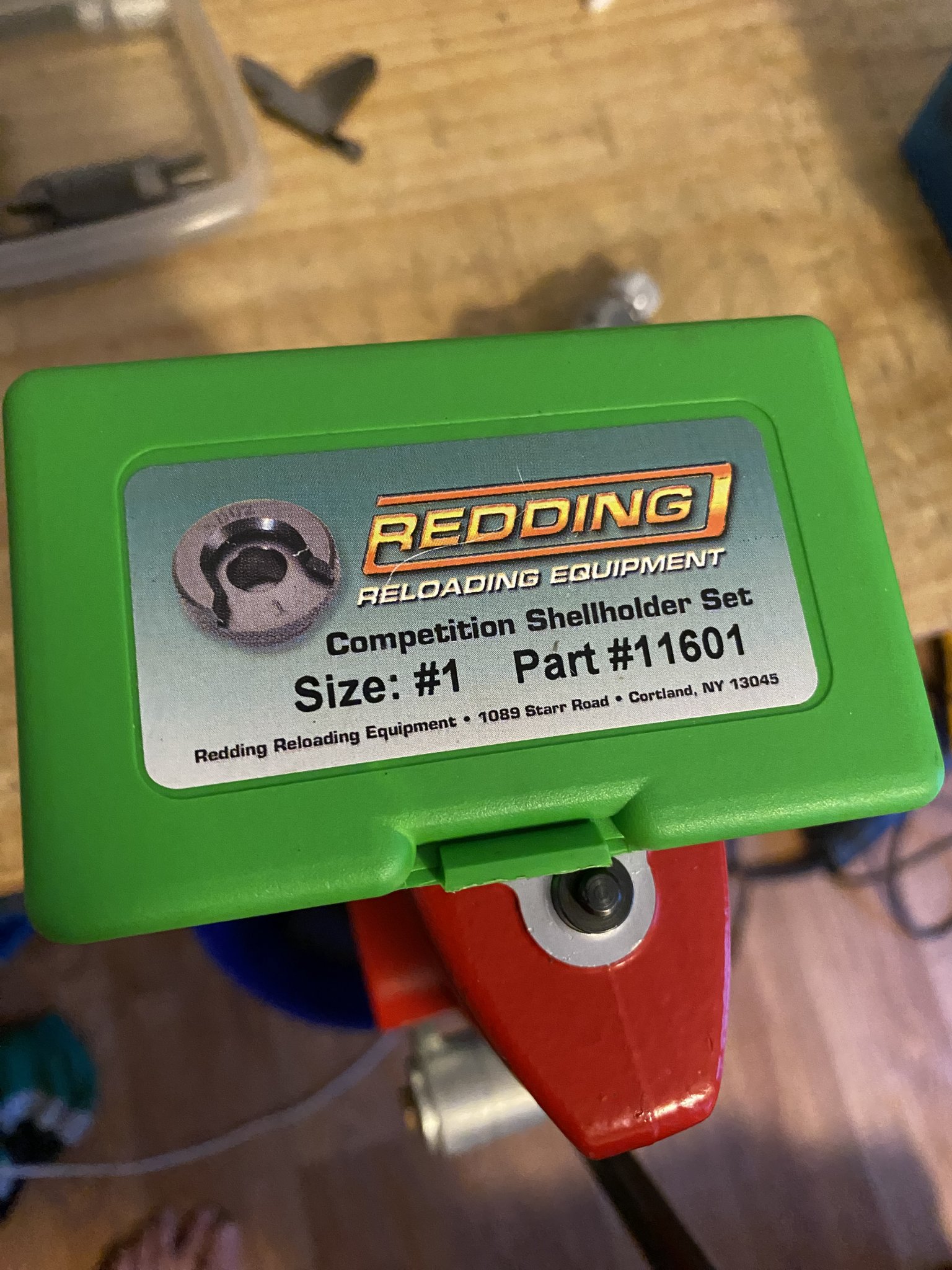

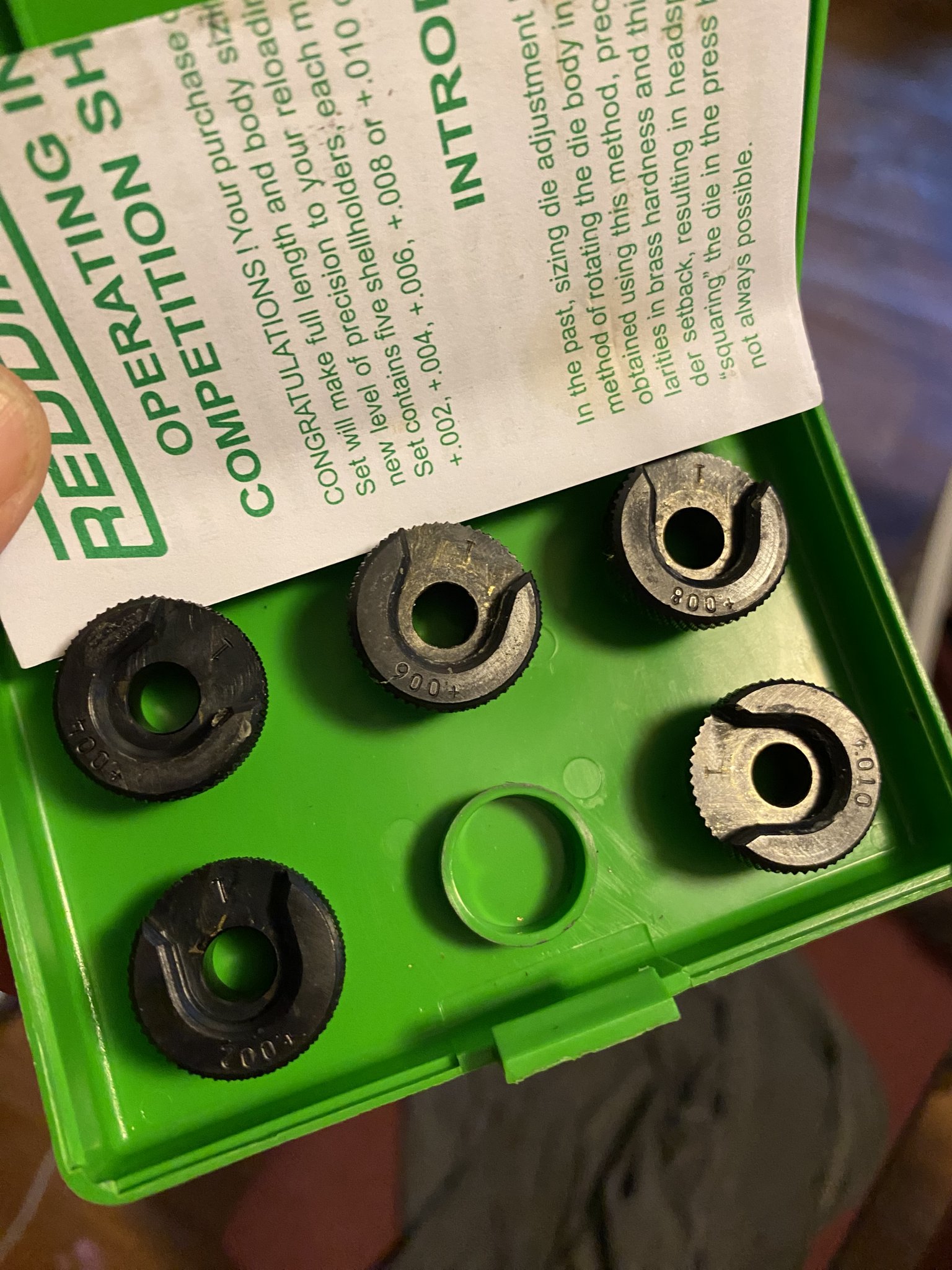

Been doing my reloading on a Lee single stage, (I think it's the cast iron). Anyway as a new reloader over the last few years it has given my fits trying to bump 2 thou. For a while I said f it and just screwed the die all the way down
After 20 videos, a brand new mitouyo caliper, and a healthy attitude I tried again and again it was all over the place. First my brass was growing, then we were at -7 thou and finally I landed at a consistent 2 thou. I thought I had it set, but then the bump got larger and larger...
After 20 pieces its settled in 2 thou each time
I lock that mofo down. (hornady locking ring)
Measure every piece, consistent 2 thou. Chamber Guage, mostly in, but not perfect, by my rifle chambers it. My sized brass never fits guages.
Go to remove die and it's stuck in the collet via the locking ring(screw in adapter your die screws in to) so I have to loosen the locking ring and then of course loose my setting. (Beleive me I tried alternatives)
Words were said. Foul words. I'm already worried with tolerance stacking of locking ring, die, press, but I seem to be the only idiot with this problem and I can't figure out why this is so damn hard. Maybe it's the die too...Hornady precision die (full length). I had this issue with a redding as well on 308
I'm good with calipers, that's not the issue. I'm fairly dexterous with my fingers and have moderate mechanical skill.
Is it the die? Press?
I need some extra guidance as ever video does it in like 5 minutes and apparently I'm a retard

Rubber O ring? (I've got metal to metal)
I measure with the Hornady Comparator (digital). I've got 3 calipers and I practiced getting consistent reads on all between loaded rounds and once fire brass, as well as new brass vs fired. This was startline brass 6.5 Creed (one fired) and annealed, deprimed.
Now the press...that thing mystifies me. I probably was crazy with tightening it down, But it was finger tight until I did did the allen head in the ring. I've also had problems with the die backing out in the past, so I probably was aggressive.
Well at least its not the press. Still very frustarting, but I appreciate the insight.
Rubber O Ring...I think he was assuming you were using Lee dies .
If you tightened the lock ring set screw while the ring was cranked down very tight that would explain the binding .

I'm assuming the fired primer is being removed before taking fired H.S. measurements ,if not do so.
Index marks with a sharpie marker on press , lock ring ,and die can be helpful
The advice about backing die and lock ring out a tad before tightening lock ring is spot on.......see sharpie advice above
Yes indeed, I also give the case a spin to make sure everything is tight. I'll give the sharpie a try
I have an old analog mitouyo a new digital and a cheapo NI that all agree on measurement, so fairly certain that part is good. That comparator can be a pita, but I don't see any clear alternatives.
It's probably my die setup, the sizing die has always given me fits. Seating I have micrometers, so it's easy mode
That Hornady locking ring has maybe 1/8 turn on the set screw from loose to tight. No way to get it so it's tough to move and get small increments
With the die rings, once you get the die set for your proper bump, tighten the die lock ring screw lightly. Carefully loosen the die a tiny bit using a wrench on the die ring, just to get some wiggle room. Then tighten the die lock screw tight. You then always tighten the die into the press using a wrench on the lock ring to where it is just snug and it will not move. Don't over tighten, just snug where it won't loosen or move when using it. Just finger pressure will not lock the properly, it can wiggle loose and throw things off.
As far as shoulder bump, not using enough or improper case lube will give you shoulder bumps all over the place.

It could be the piece that you are using to setup sizing is very hard, from repeated firing, and is springing back. The next piece could be softer is setting a little shorter.
One thing that has helped consistency is making sure the die touches the shellholder, annealing, consistent lube, and a consistent stroke of the handle.
