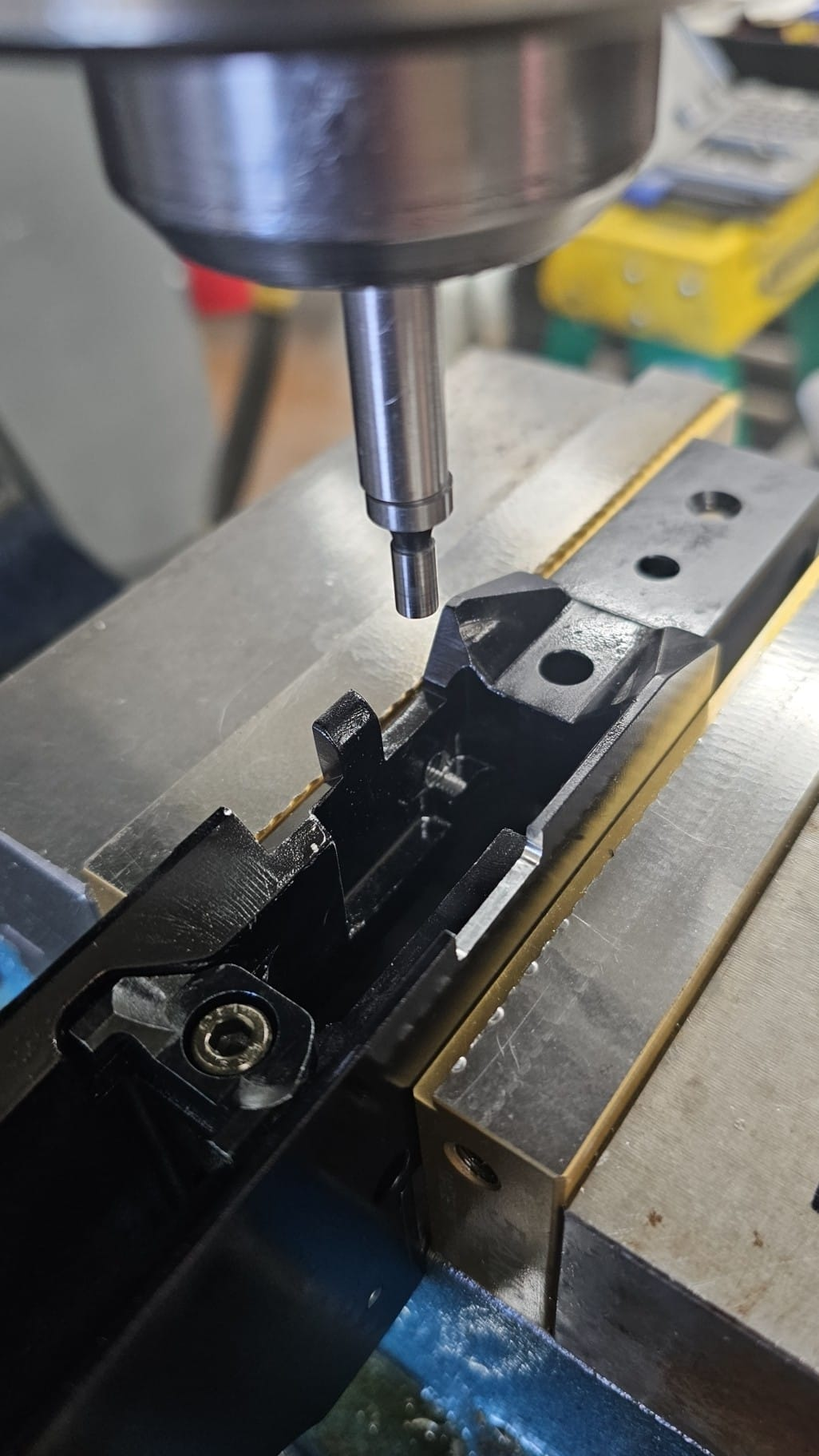

    Because LH LA chassis options are sparse, I’m on the hunt for someone to mill out an ACC long action right hand to LH. I don’t run a safety so it would just need to be the bolt handle only I think. I would like it to be a very professional job, with maybe Cerakote on top to cover the raw material

    I got my buddy who's a smith to do one for me and ceracoat it for mebyears ago. Any smith can do it, so just get someone local who does ceracoat to do it.
    If you can't find anyone, I think Rick at gcp rifles in FL can do it.
    Reactions: Rockdoc173

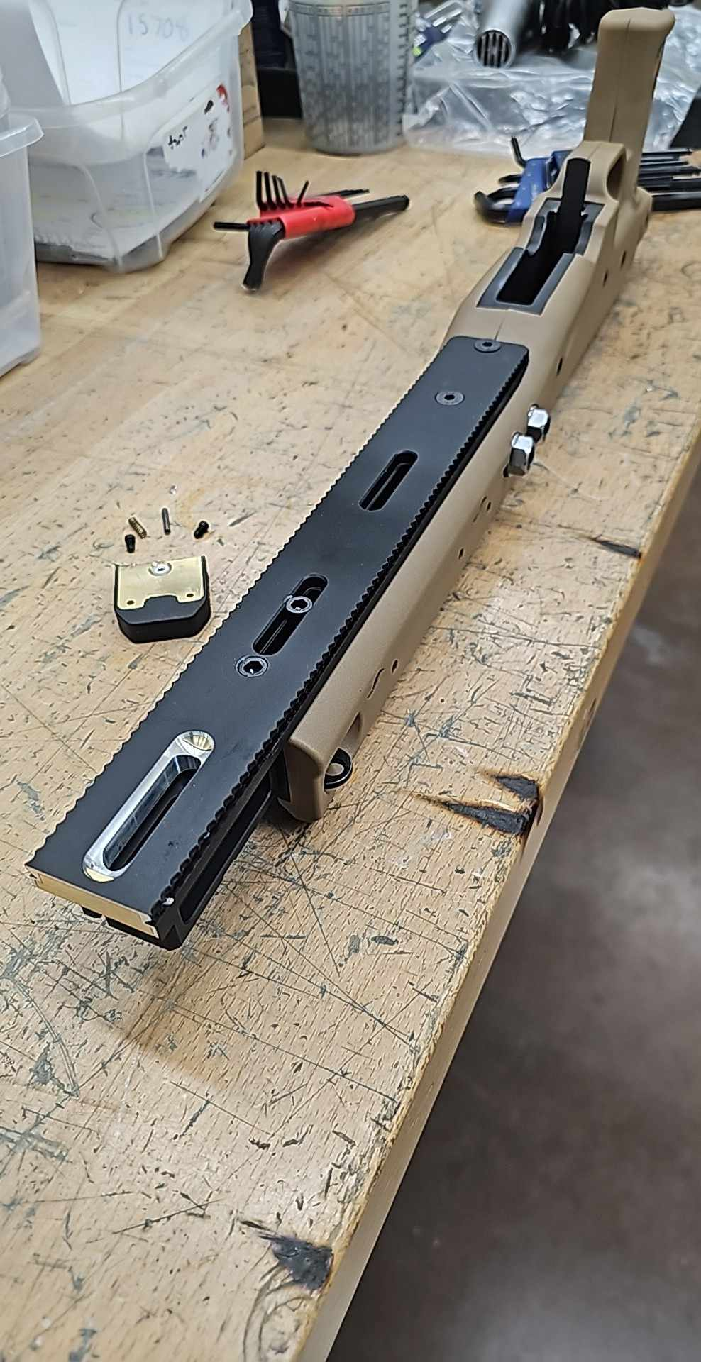

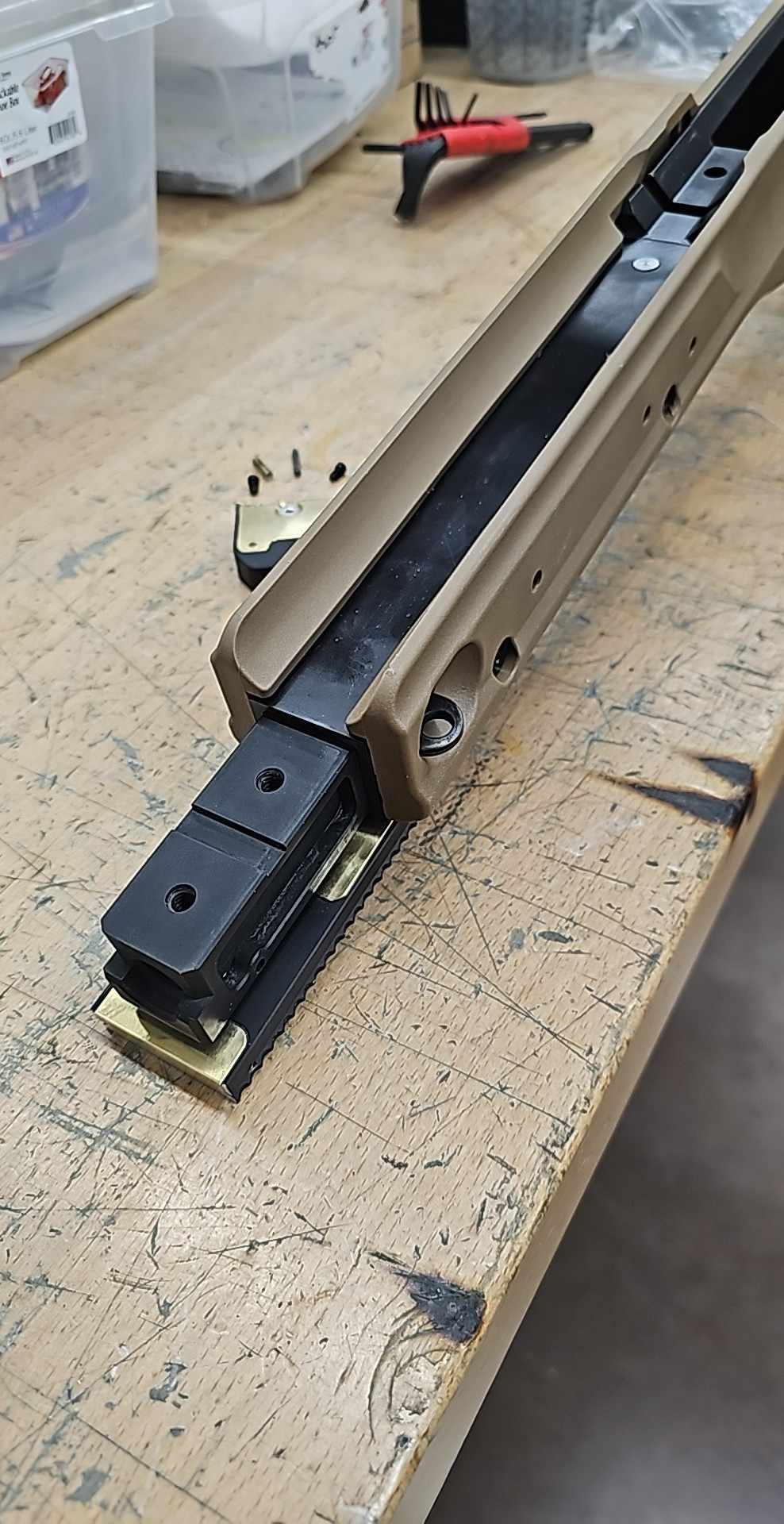

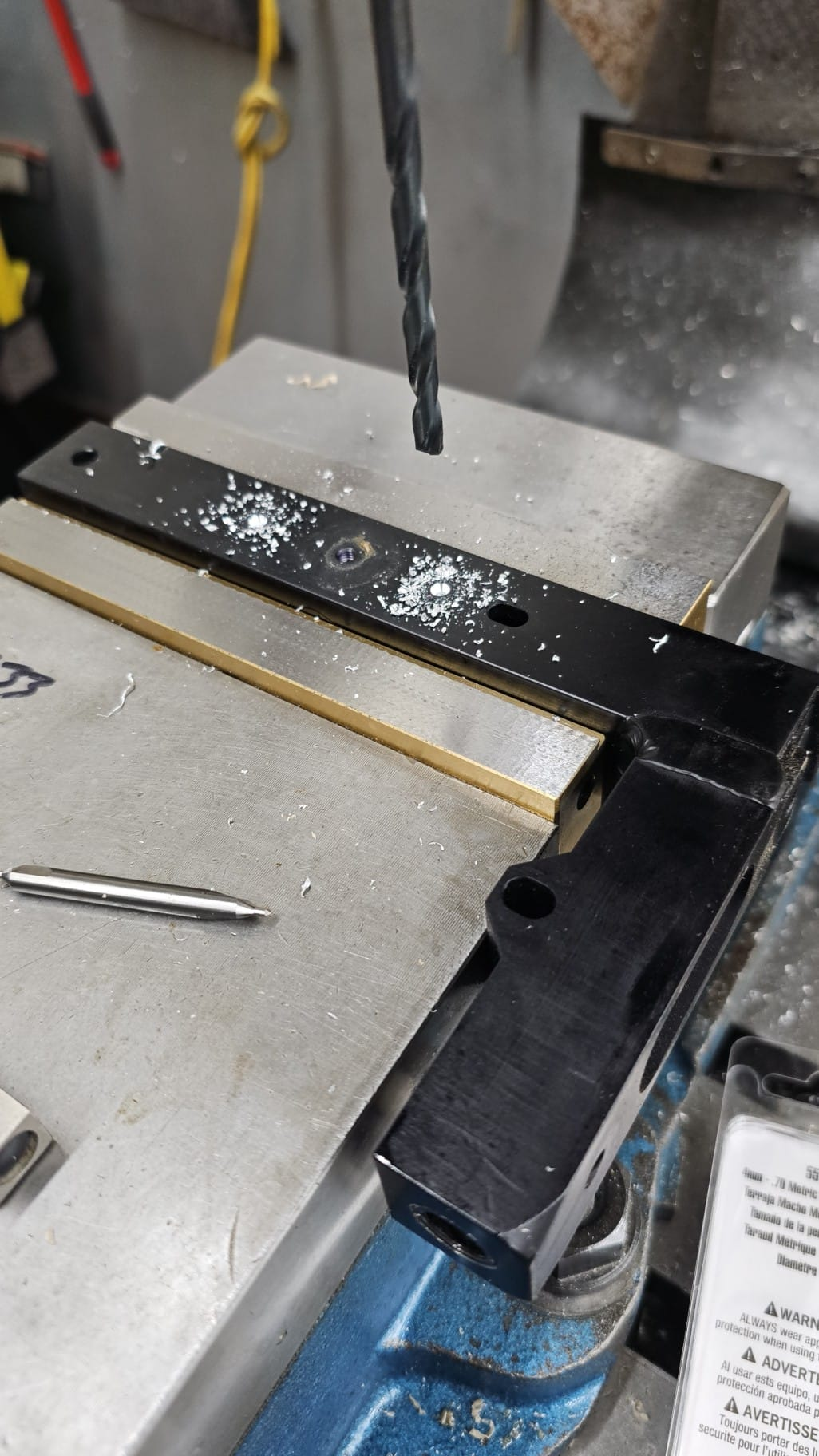

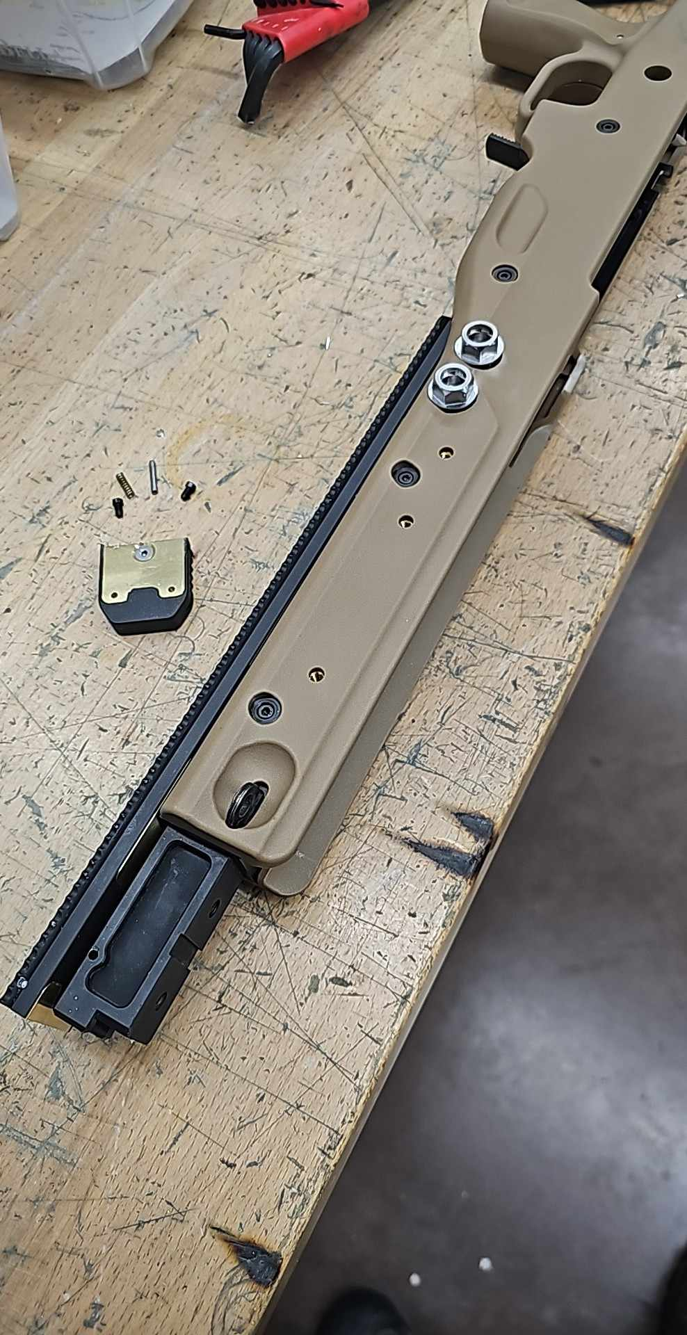

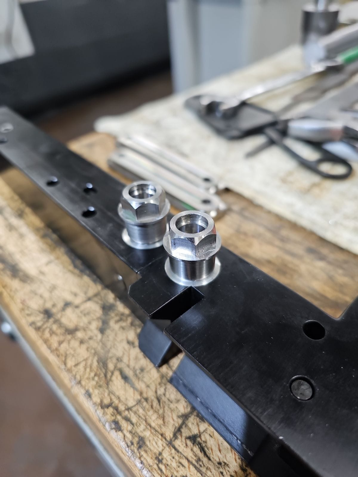

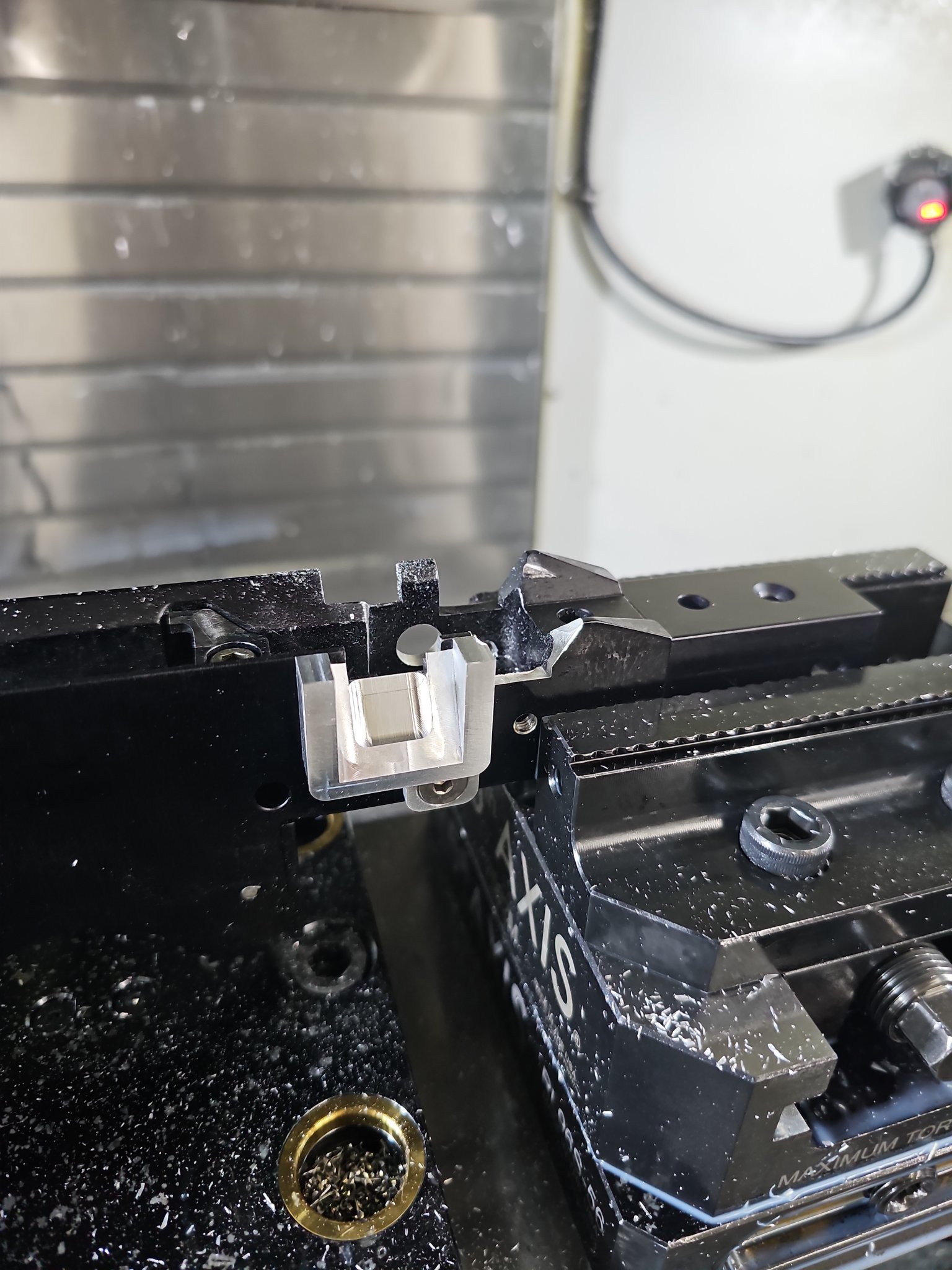

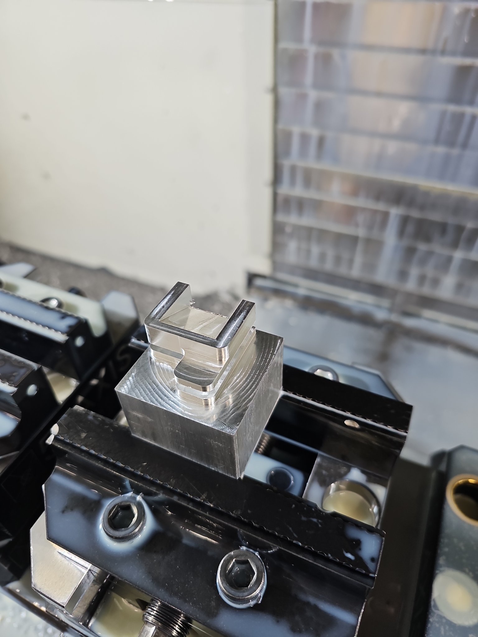

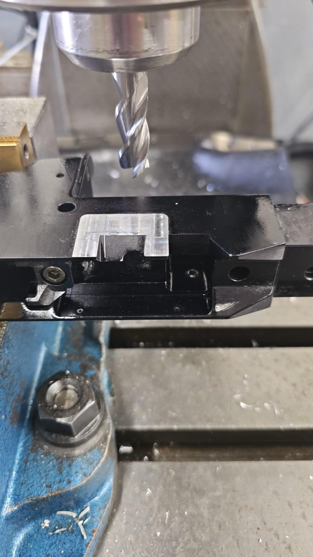

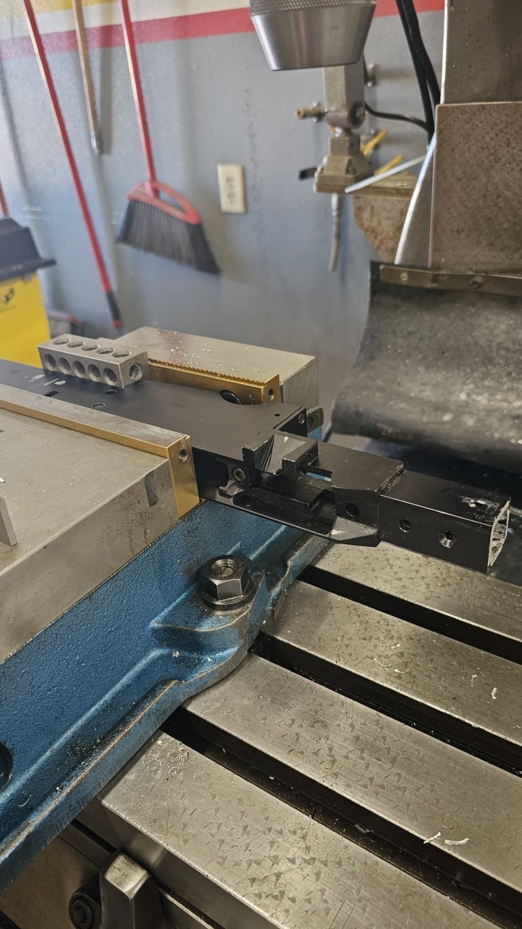

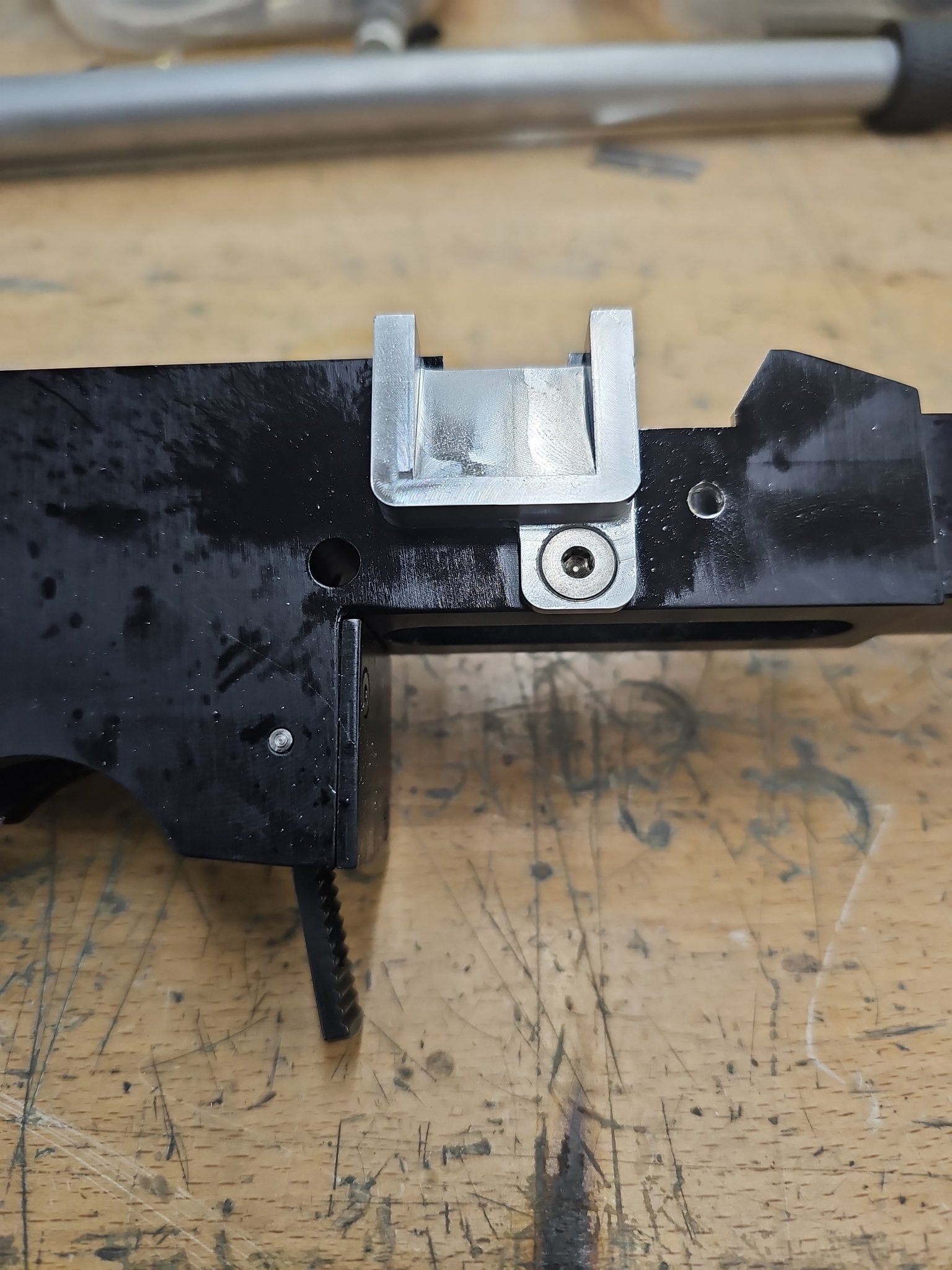

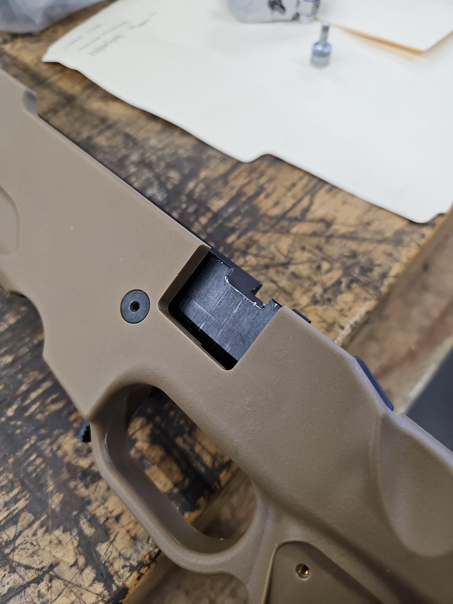

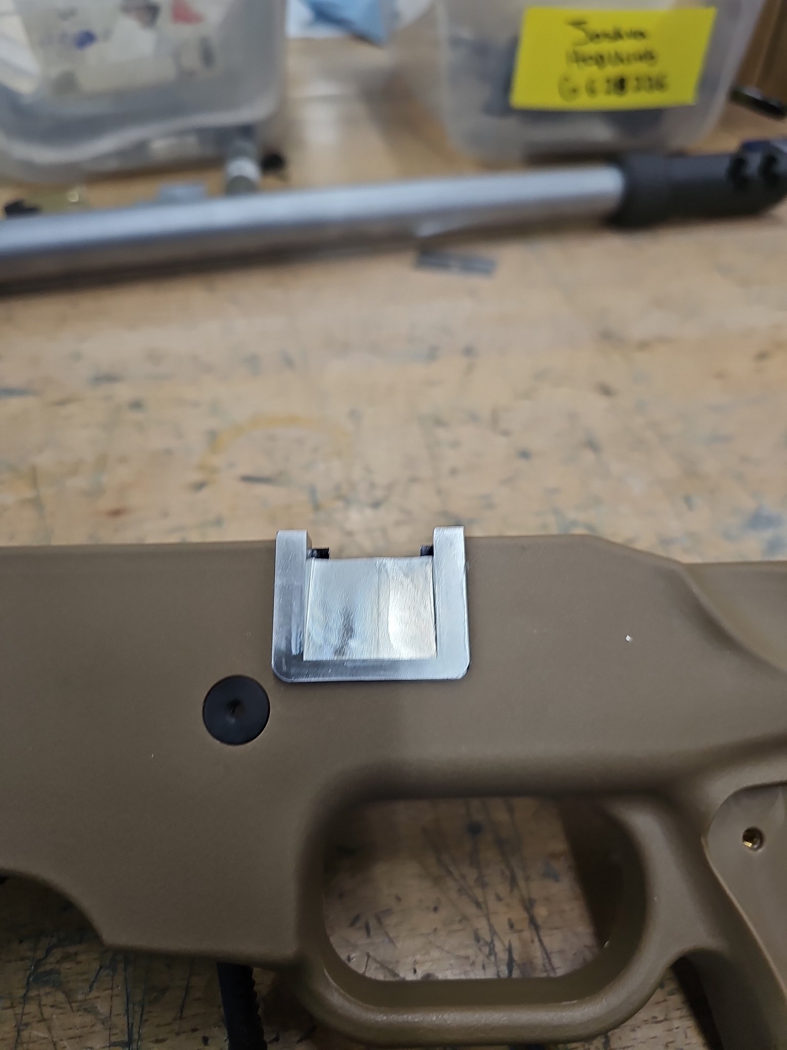

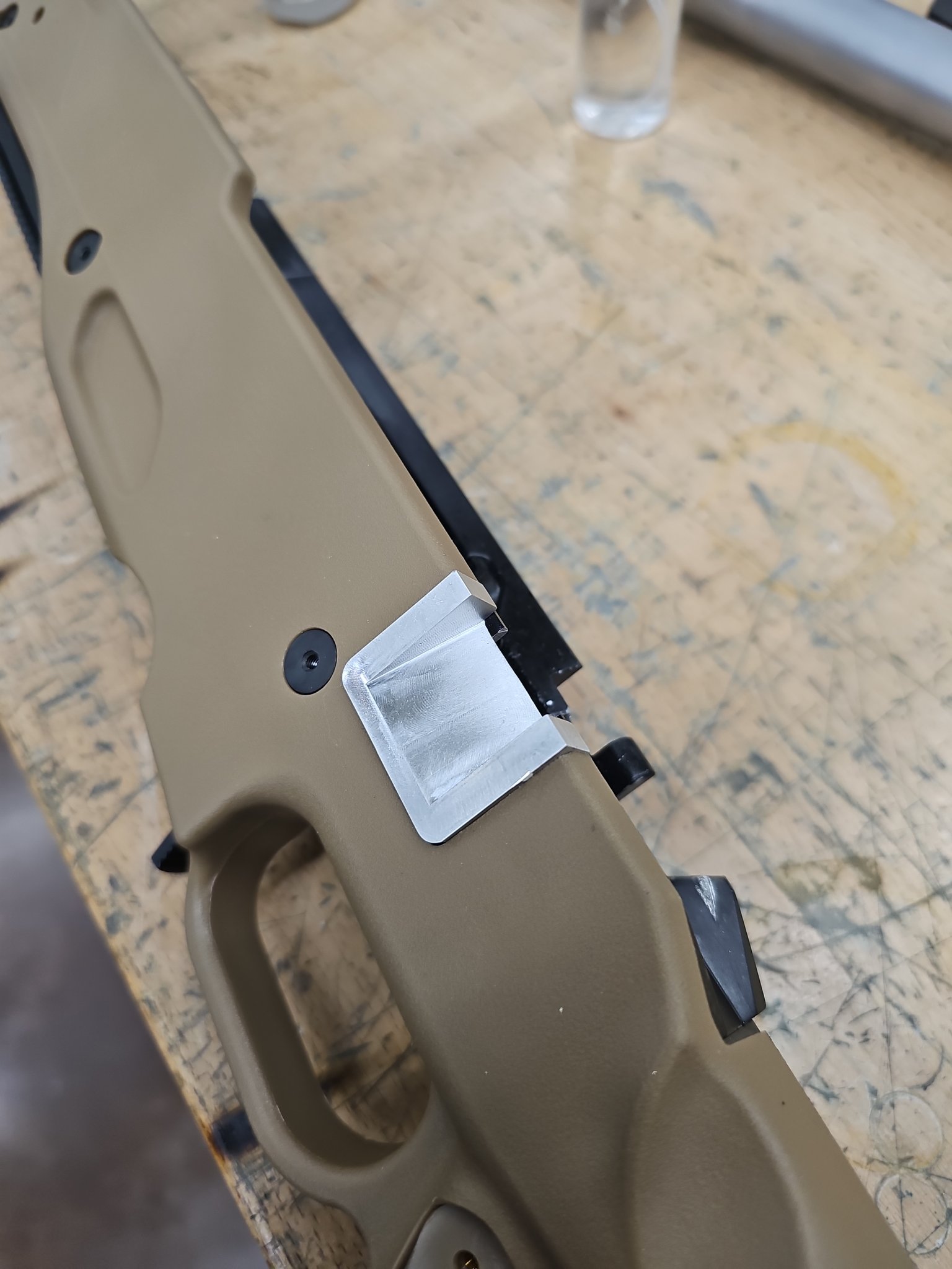

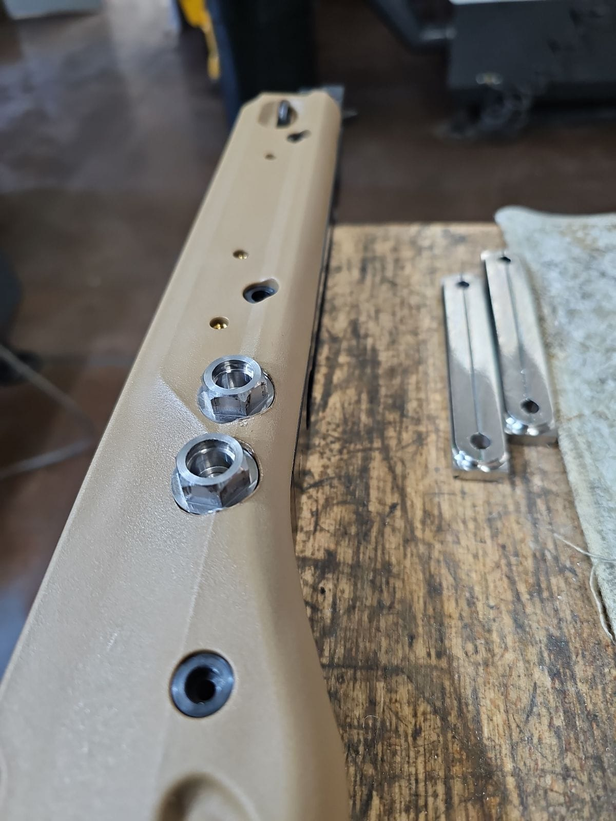

    Some "Transgender" surgery I did just last week.
    Right-eh into a Left-eh.
    The "lug nut" looking flush cup thingys are something he had me whip up for some kind of widgit tripod thing he has.
    Arca rail is still in process. I had to pin the weight and followed up with a little glue as the AL is pretty thin around it. We'll squirt it with some C/K to finish it off.
    I think I'm going to make a "block" to fill the bolt handle cut in the skins so that it resembles the original side prior to facing it off.
    Dude I know you've been told this more time than either of us can probably count, but you do some outstanding work.
