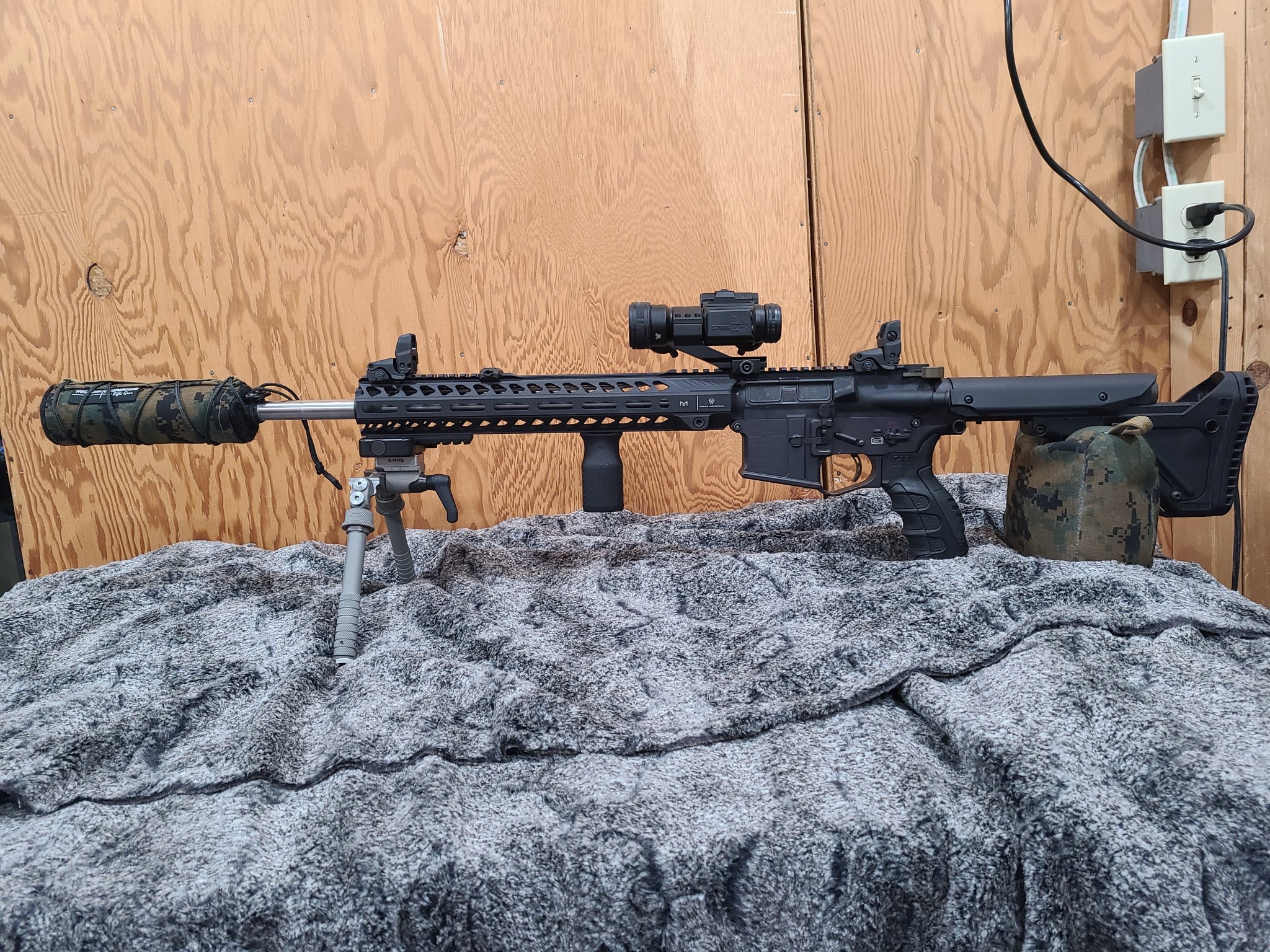

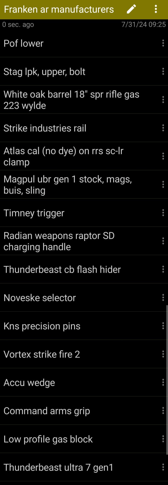

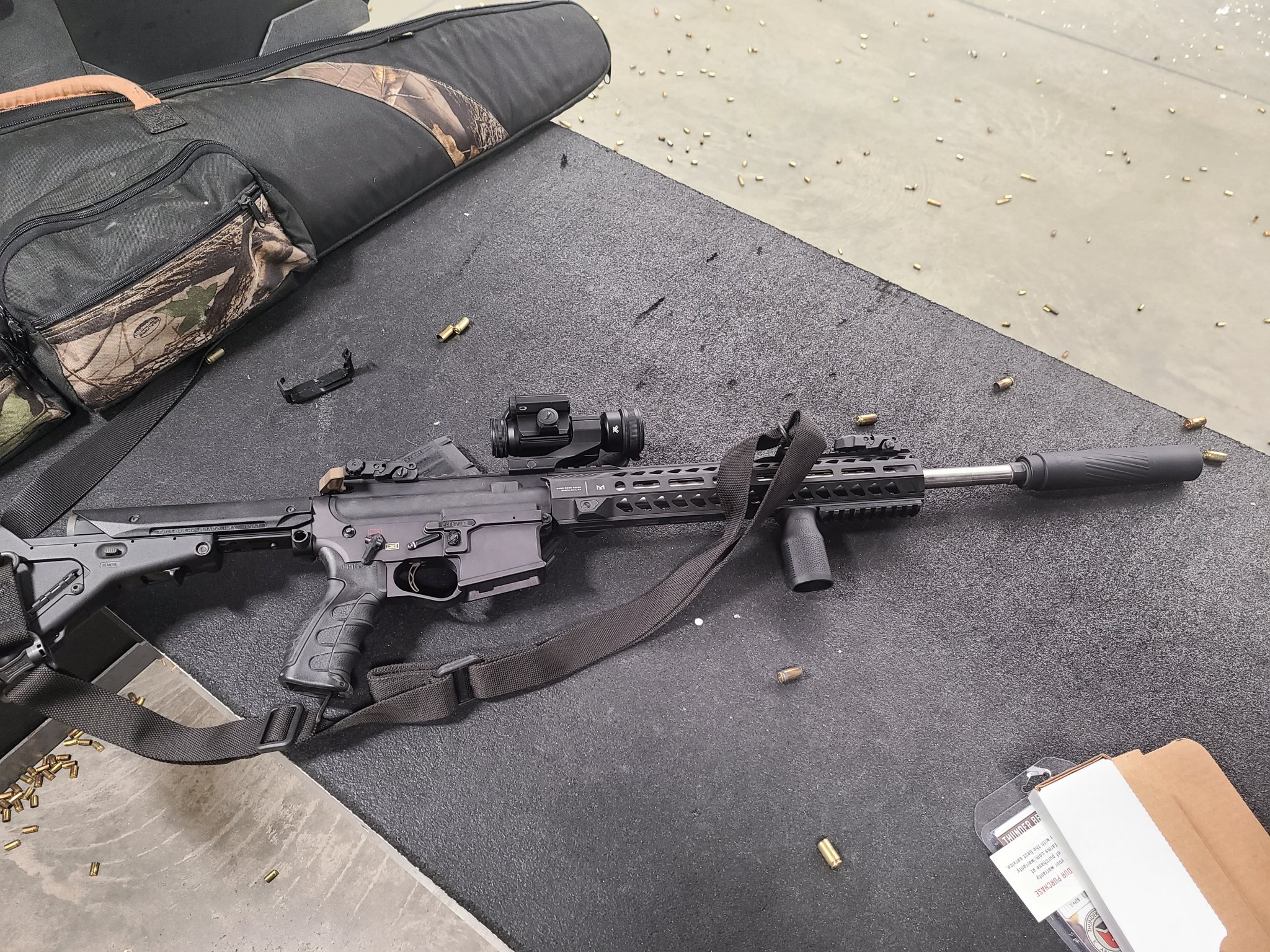

I built mine over 10 years ago and it works pretty good. Upgraded the rail more recently. Both pics same rifle. I think mine has the white oak armament ambidextrous extension but I'm not sure that is still needed. In it's life it has had a leupold mark ar 3-9x40 mismatch pos and my razor 2 4.5-27 was on it briefly.
The pof lower has features built in that you can run bolt release and magazine from both sides. The more relevant piece I would say is a good ambi selector. My noveske is a 45° type.
