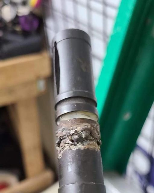

    I removed one of their pin and weld jobs years ago. Before I started grinding the muzzle device off, I put a wrench on it out of curiosity. It spun right off. The pin didn’t even completely penetrate the device, let alone touch/penetrate the barrel. I contacted them to complain and their response was pretty much “oh well”.

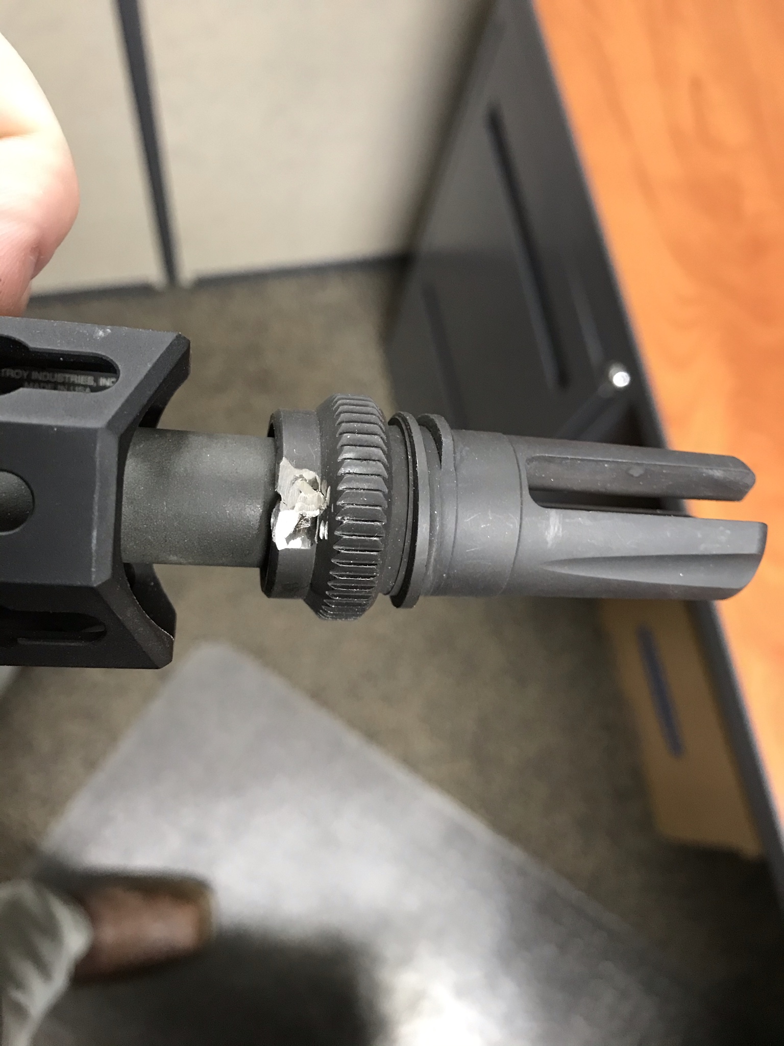

    Do ya want to save $40 or do you want it done properly? Not mine, just a picture taken off the interweb. Pay the money AFTER you check out their quality.

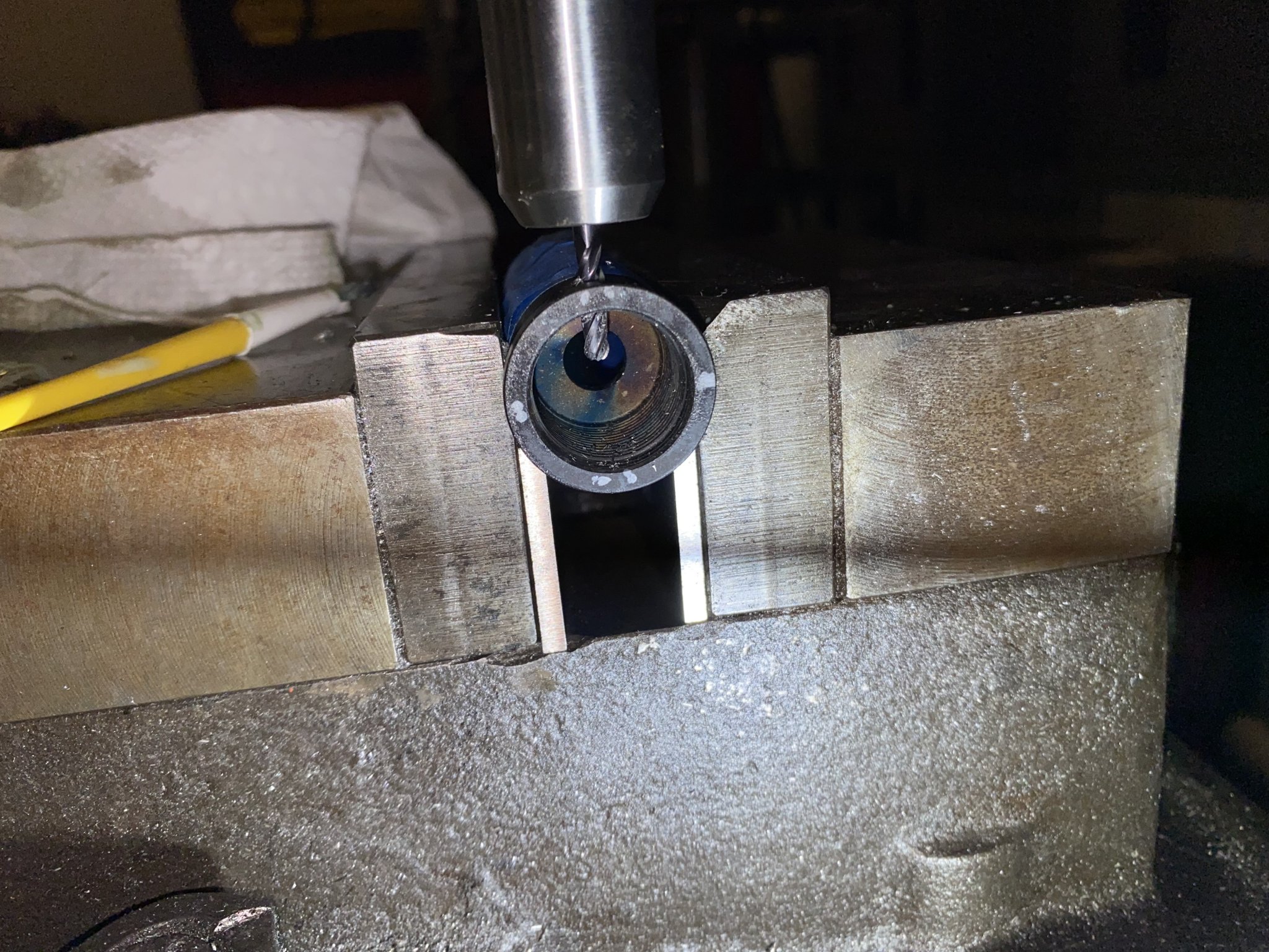

    1) Drill the muzzle device. Pick a spot that you can find later if you wish to undo the process. (Drilling at the 6 o'clock position with a 1/8" hole located 0.1875 from the back face is my preference.)
    2) Degrease everything and install the muzzle device and torque to final spec.
    3) Run a 1/8" end mill back through the hole and into the barrel threads.
    4) Drop in a 1/8" pin, mark the desired length with a scribe, remove, and cut to length.
    5) Prep the area around the pin hole for welding. Fancy coatings turn into contamination at TIG temperatures. Don't go overboard and strip half the brake.
    6) Insert the little nub of a pin back into the hole (probably after dropping it on the floor and losing it behind a workbench leg), and cover it with a small weld. You should have heat on it for a few seconds.
    It almost takes longer to type that out than it does to do the work... unless you're one of those "artists" who thinks that good gunsmithing requires coffee breaks about every 45 seconds followed by a rant about how the space alien lizard people killed the Kennedy brothers to help LBJ get the '68 GCA passed.

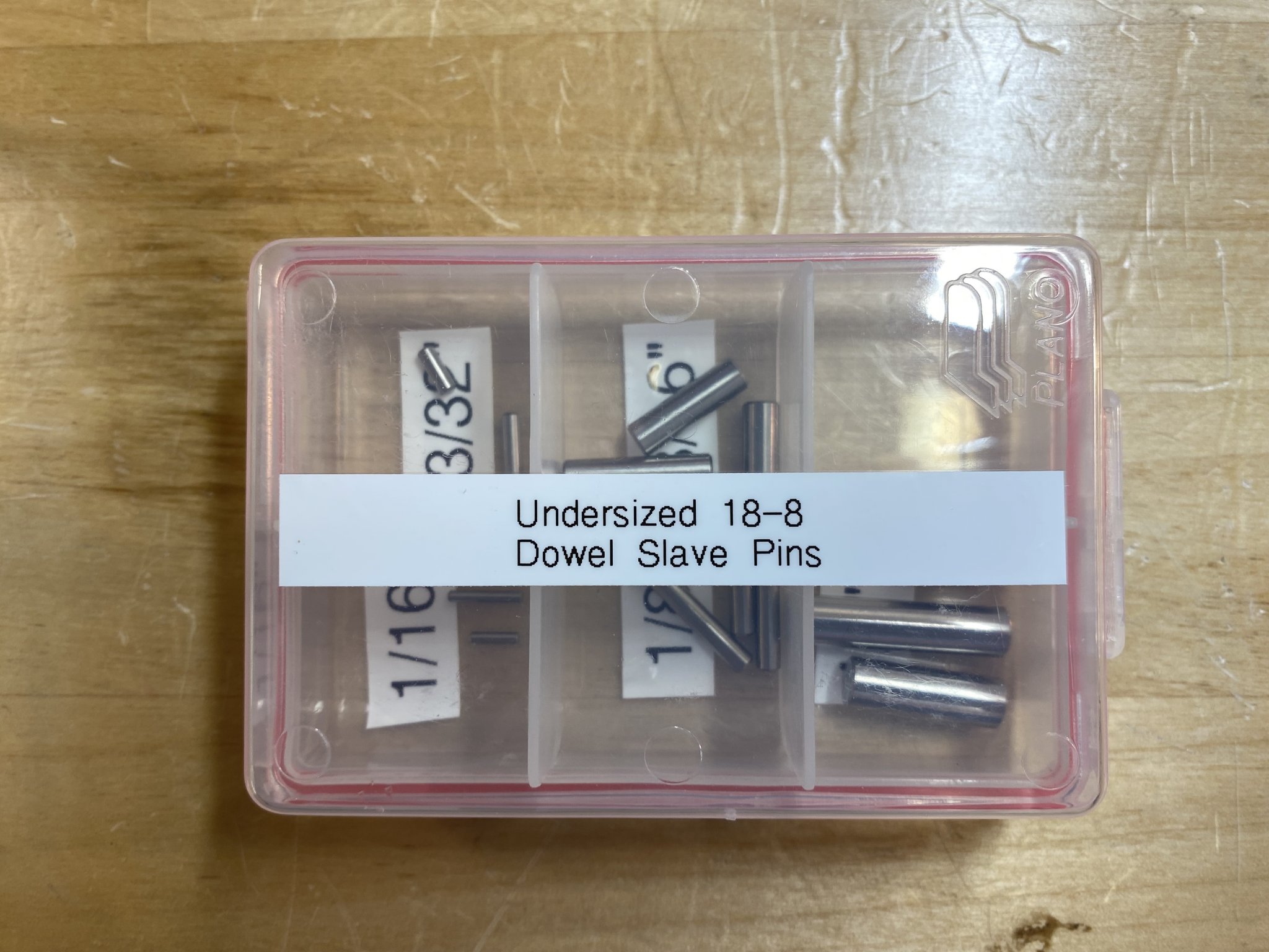

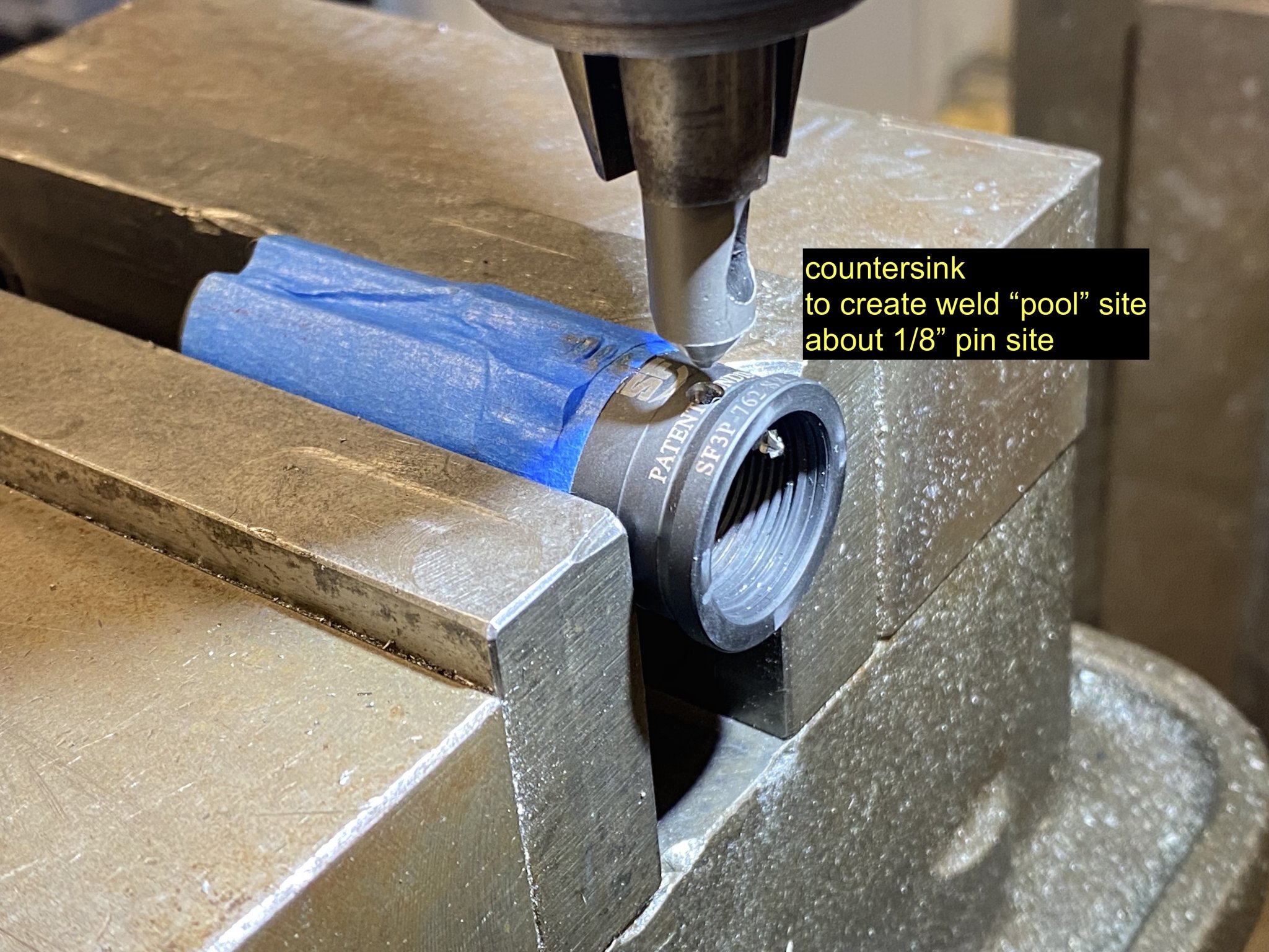

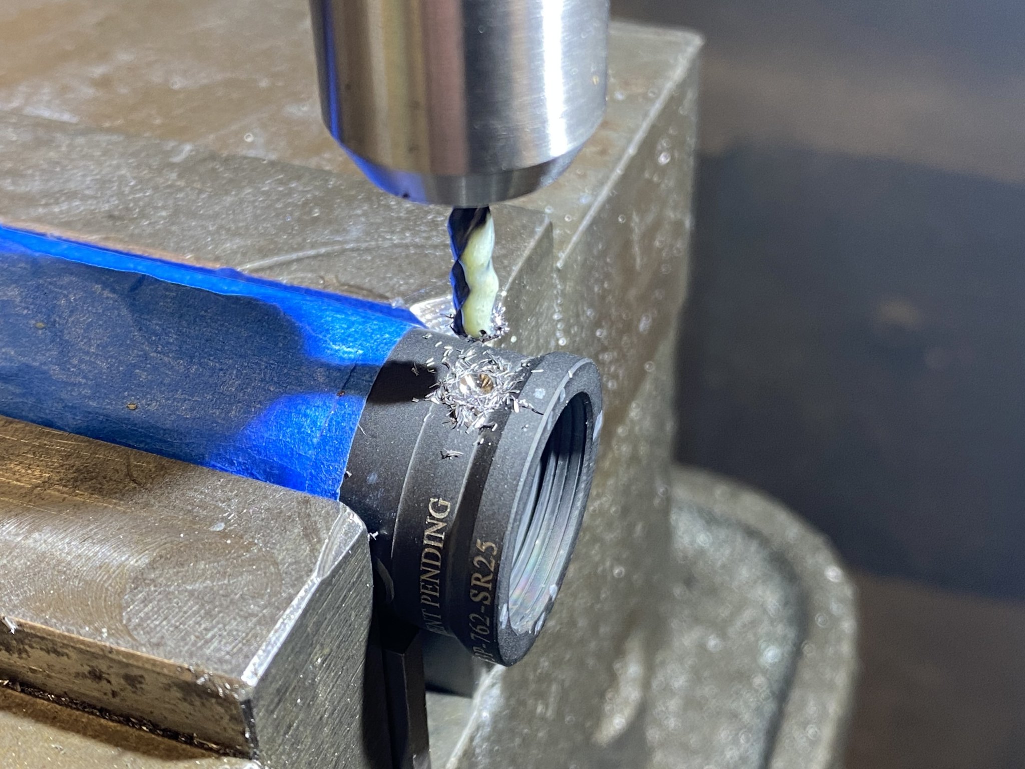

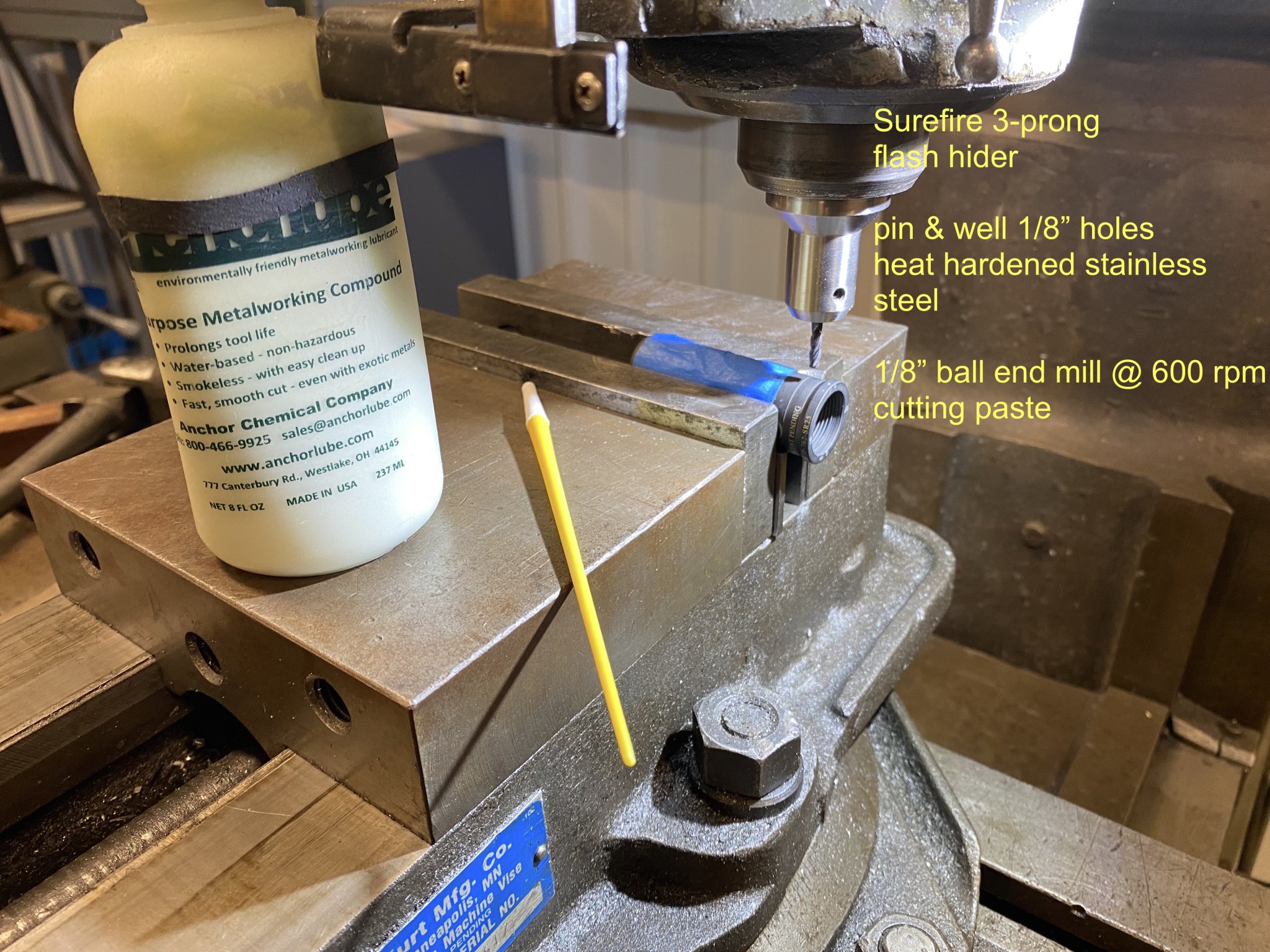

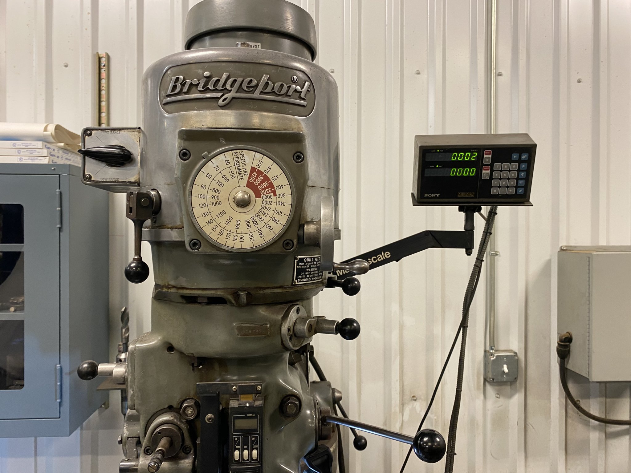

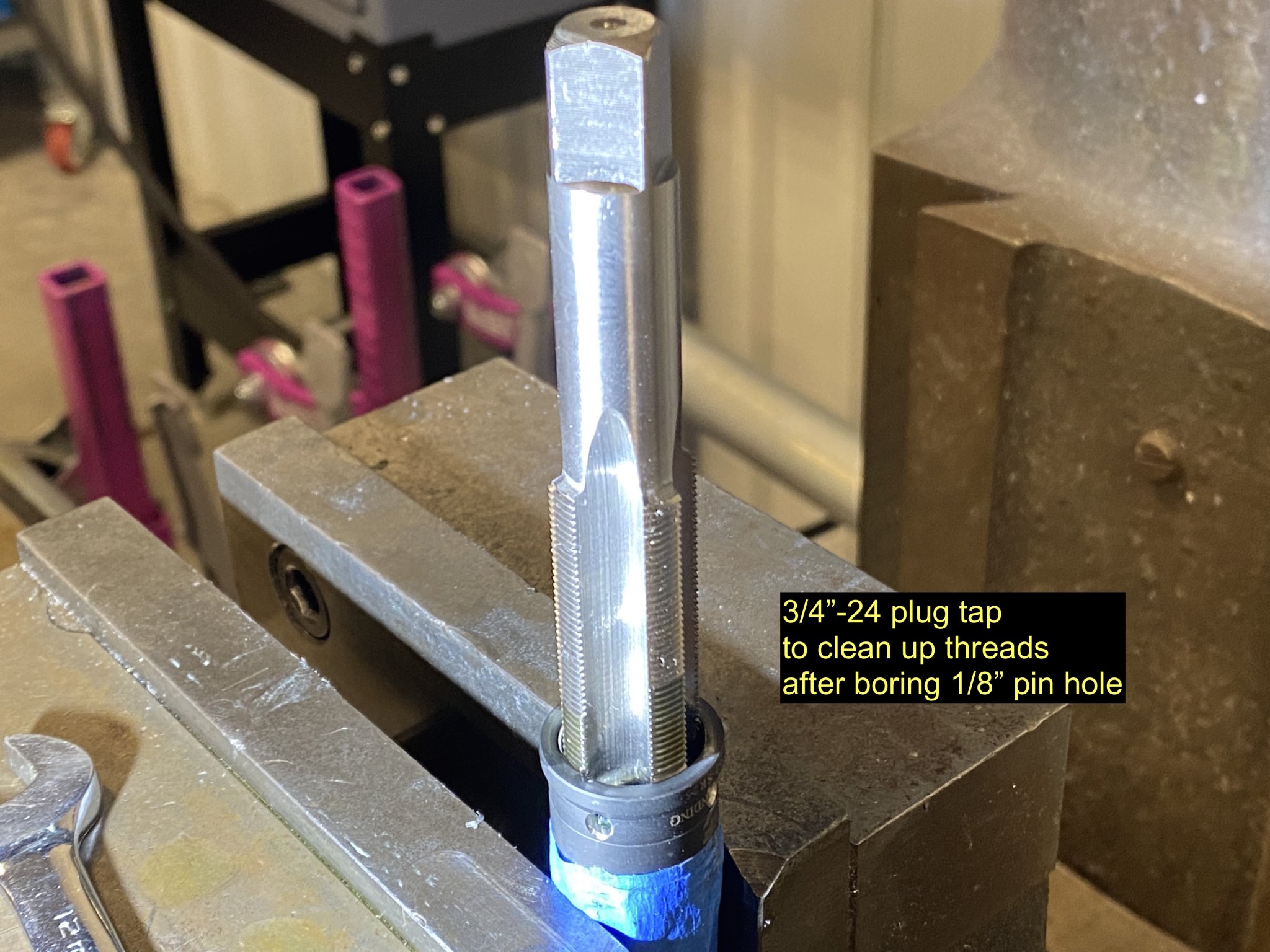

    When Form 1 times were much longer before current Eform1 dwell times I would P&W while paperwork was in the BATFE queue, I would drill the muzzle device 1/8" pin hole on the mill, assemble the muzzle to barrel, lightly create a detent in the barrel threads, use correct length undersized dowel pins, countersink a small area for TIG weld pool on top of pin, clean up threads with tap. The pin & weld is easily released with the mill when your paperwork arrives.
