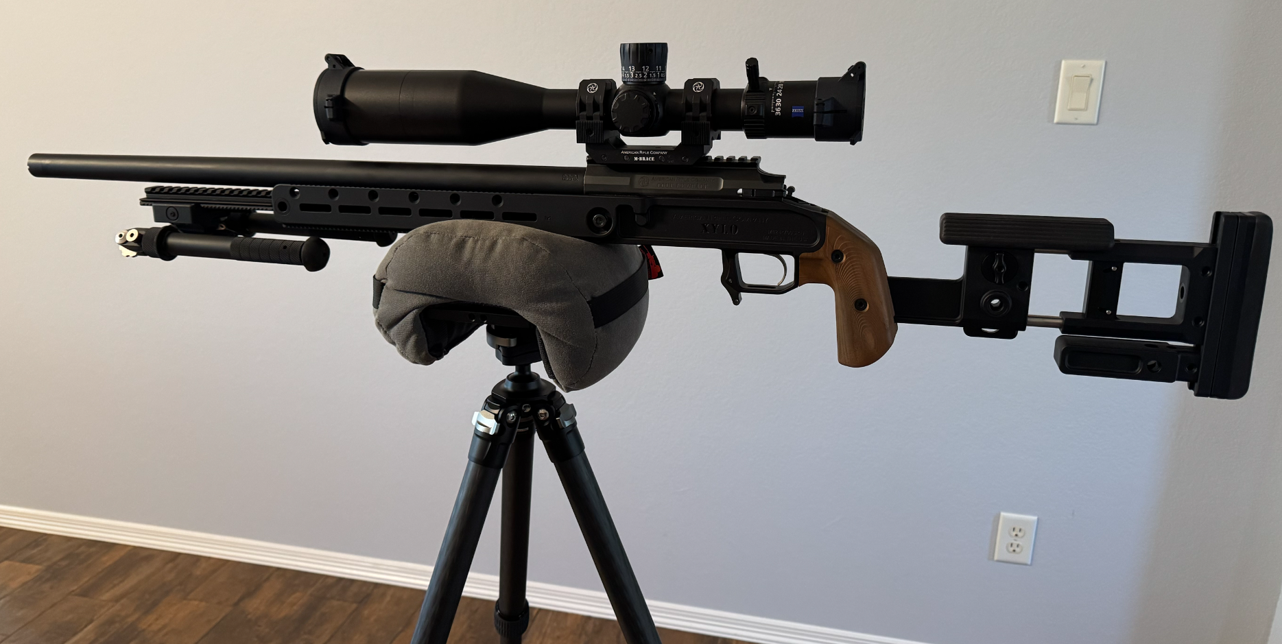

Skip the tac table. If you want to bag it, just place your bag over the top of the tripod head. Plenty stable without the need for a table.
I could take or leave the tac table for shooting off of. I usually will just throw a bag on the top of the leveling head if I'm going to shoot from the tripod. The tac table is nice for glassing though, I throw a bag on top of the table (with bag oriented vertically) and binos on top of the bag. With just the head it's a little harder to balance both bag and binos.

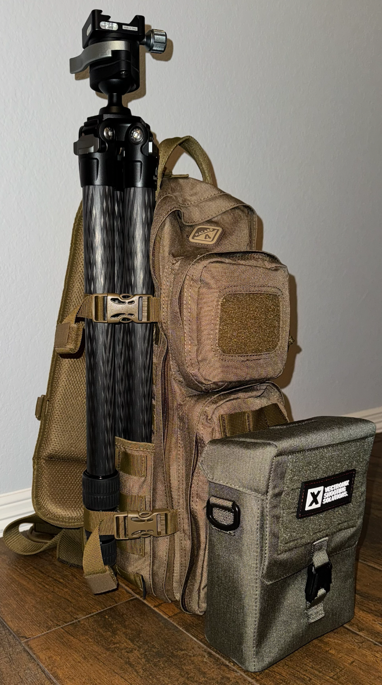

I use a Hazard 4 Plan-B sling bag to carry my SA-324C MA-40 tripod and gear from position to position on the range. It's large enough to carry a WieBad fortune cookie and other gear internally. The lower portion of two tripod legs will fit in the the side pouch and the straps secure around all three legs.

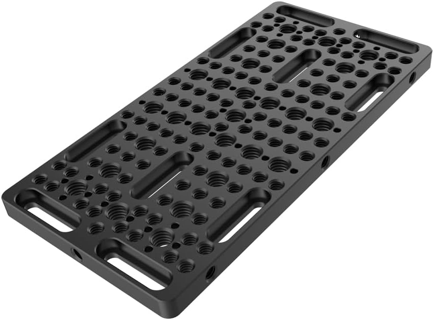

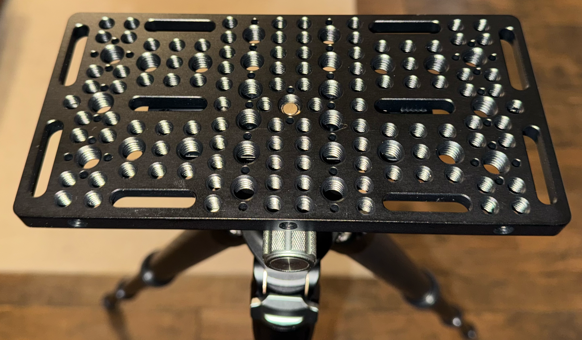

I made a tac table from an aluminum 4" x 8" cheese plate where all the holes are threaded, plus a few slots for straps. This gives me a lot of options for mounting other items.
Added an QD ARCA plate.

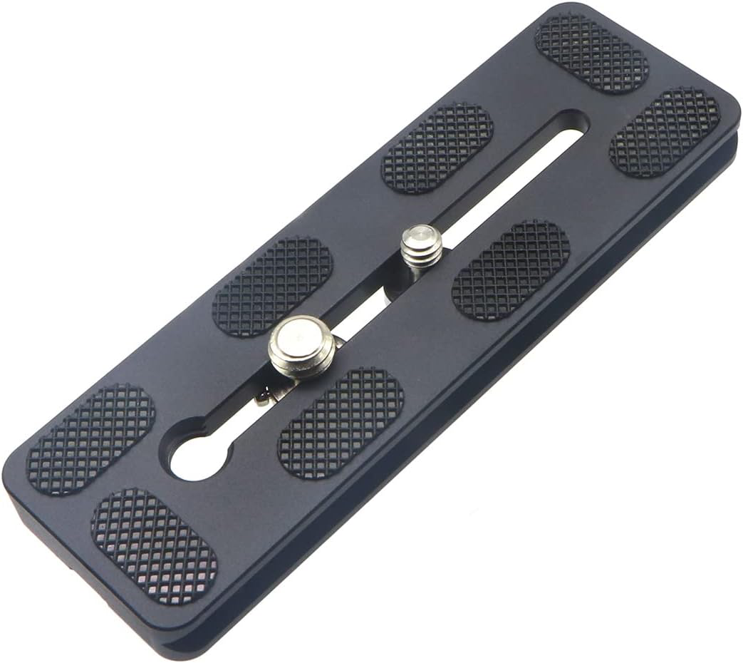

I was thinking more about the Arca/Pic clamp not so much the ball head. A twist lock for the Arca/Pic clamp portion instead of the lever lock. For times when you are switching between Arca and Pic rails that are slightly different widths. The twist lock is easier to deal with, but not as fast. Hopefully this makes sense.
Reactions: JR1200W3
I am referring to the STB-75 Rapid Lever Lock.

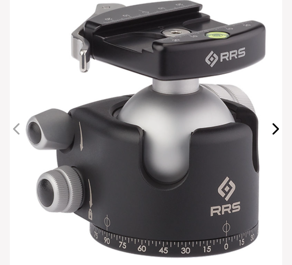

Just looked up the MA-30. I guess that head more closely resembles the RRS Anvil. You're the second person I heard speak highly about it. Maybe I should check it out.
Ah, I see. The MA-30 is almost an exact clone of the Anvil 30. The RRS Anvil 30 is nicer, but not by much. The biggest difference is RRS has a better seal & may perform better in dirty environments.
Reactions: strow and ID_Matt
My teammate and I have identical tripods with the RRS Anvile 30 on mine, and the MA-30L on his. I’ve used both. The MA-30L is too close to RRS’s design, so Leofot had to stop advertising it in the US. You can still get them through various vendors I think.
The RRS is definitely smoother, and the lockup is slightly different. Both are just as rigid when locked down, but the RRS has less stiction and more finesse at partial lock. We’ve had both in nearly identical conditions, and the MA-30L got gritty and sticky when the RRS did not. I tried flushing the MA-30 out, but couldn’t get it cleaned until I disassembled it. It’s all good now. The lever screw requires a 2mm driver to remove, and it was very soft - super easy to strip unless you have a precision ground driver (MIP tools or similar).
Where did you get the 4x8 plate? Looks like a good setup.
