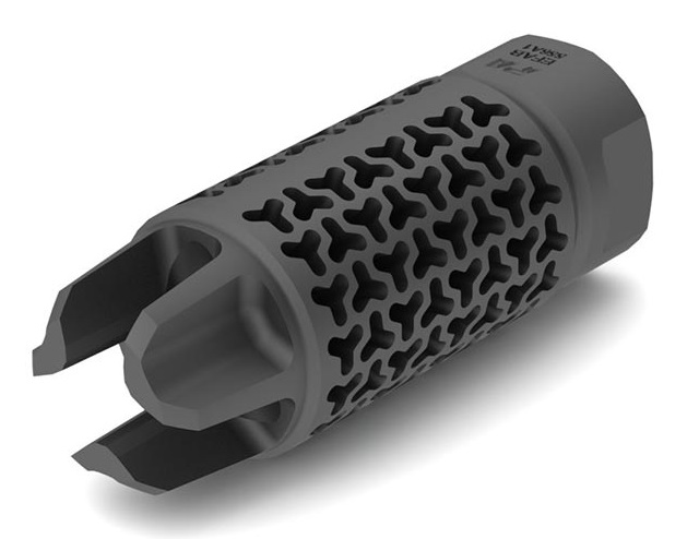

Have you tried an EFAB or Dynacomp? Lot less "Blasty" than a traditional baffled muzzle brake.

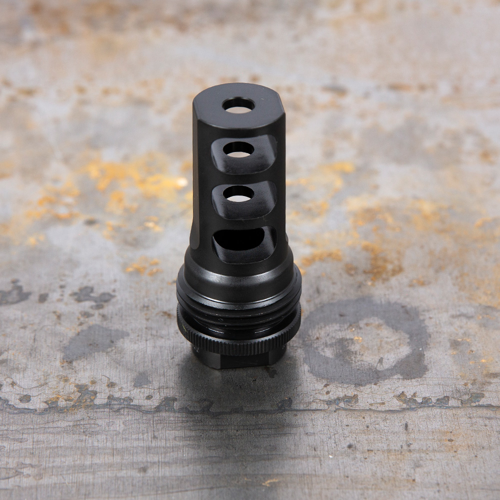

The ASR brake from Silencerco vents to the side instead of back. Less blast coming back at you and it does reduce felt recoil.

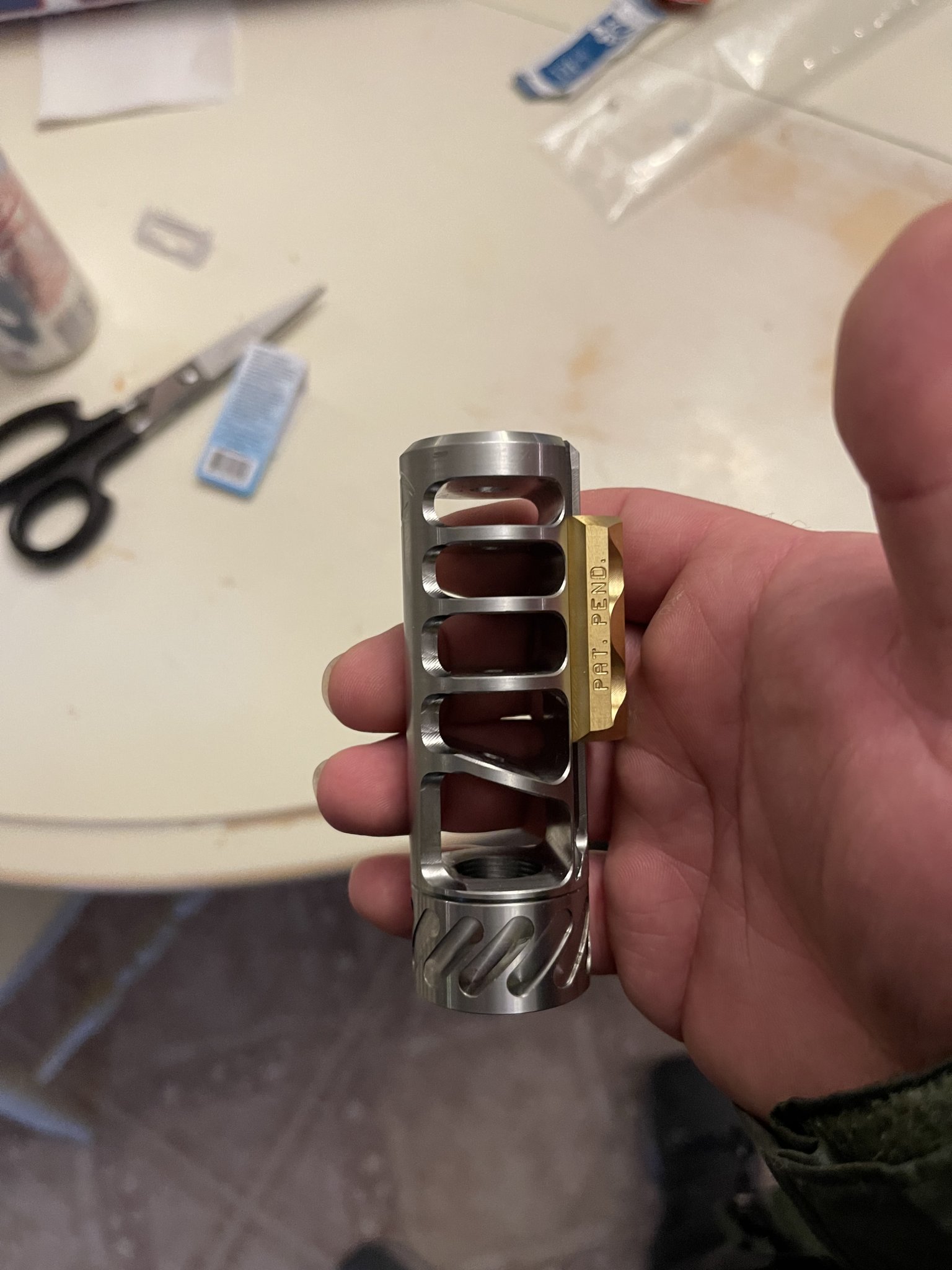

While the concussion is significant, I like the Fat Bastard. Not only does it sop recoil in its tracks it stops the muzzle rise. Lets me stay on target much easier. I'm going to order the Cone of Shame to see if it will cut back on the concussion.

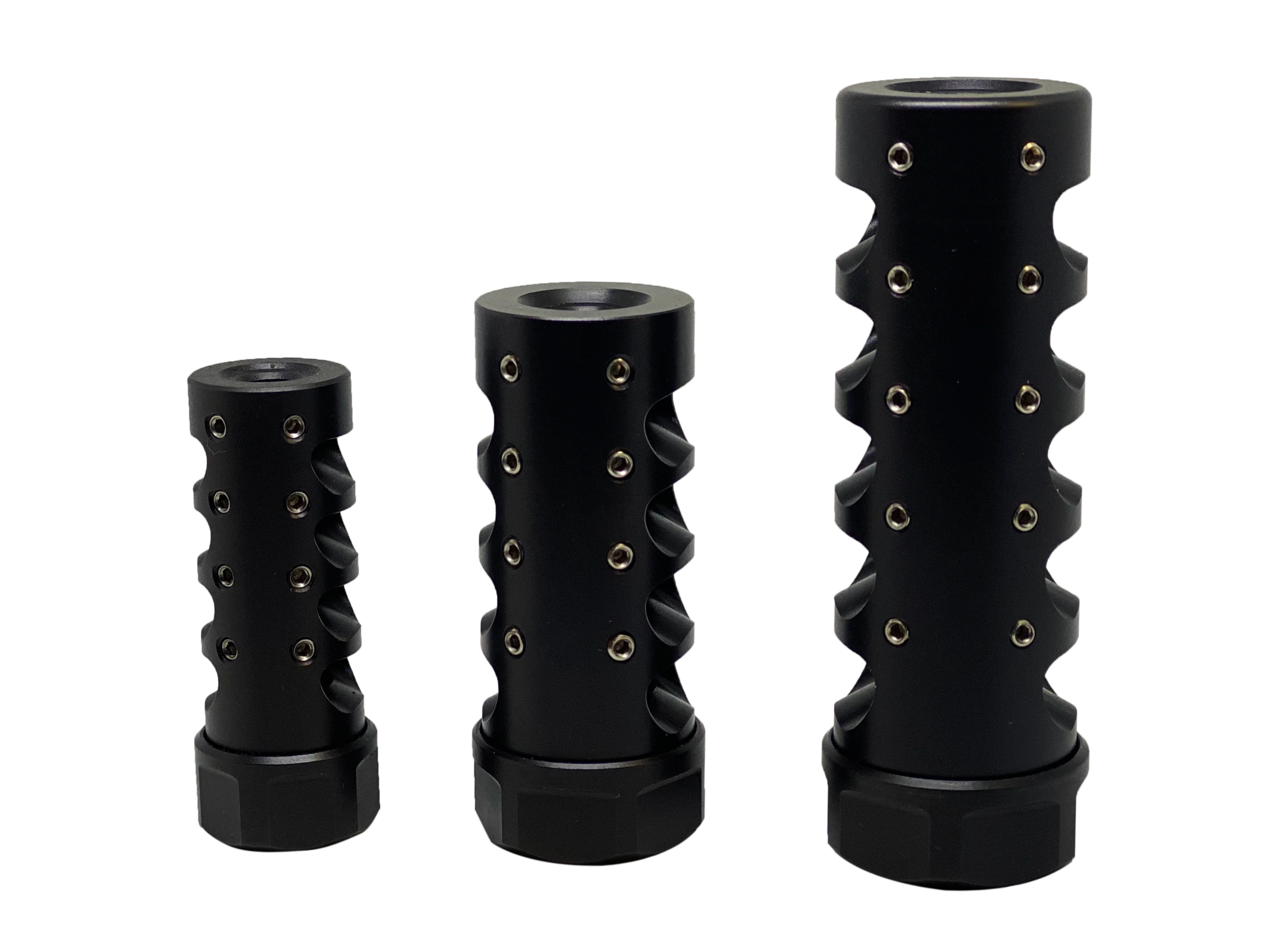

The ats brake was designed to keep concussion off the shooter. I demoed the owners at the war match and ended up buying one. Recoil reduction is on par with all the rest
I concur, I have them on several rifles. As a shooter there is no real concussive blast and as a shooter next to the rifle I only feel the warm breeze. A while back I was shooting and a guy came up with an AR (no idea on caliber, it looked like a small frame) and he started shooting and each shot was like getting hit in the head, I moved benches. No such issues with the ATS.

ASR is a muzzle brake but it is also the adapter to install some of the Silencerco suppressors. I thought that was a nifty idea.
My ASR brake does redirect recoil. The vents are not point back, so, I don't get a blast in the face.

However, even these are are much more concussive to me than any radial brakes I've tried. Of course, a radial brake will brake less. Lastly, I'd also go with an EFAB or AFAB if I want something more like a radial brake in function but didn't like the look of a radial brake.

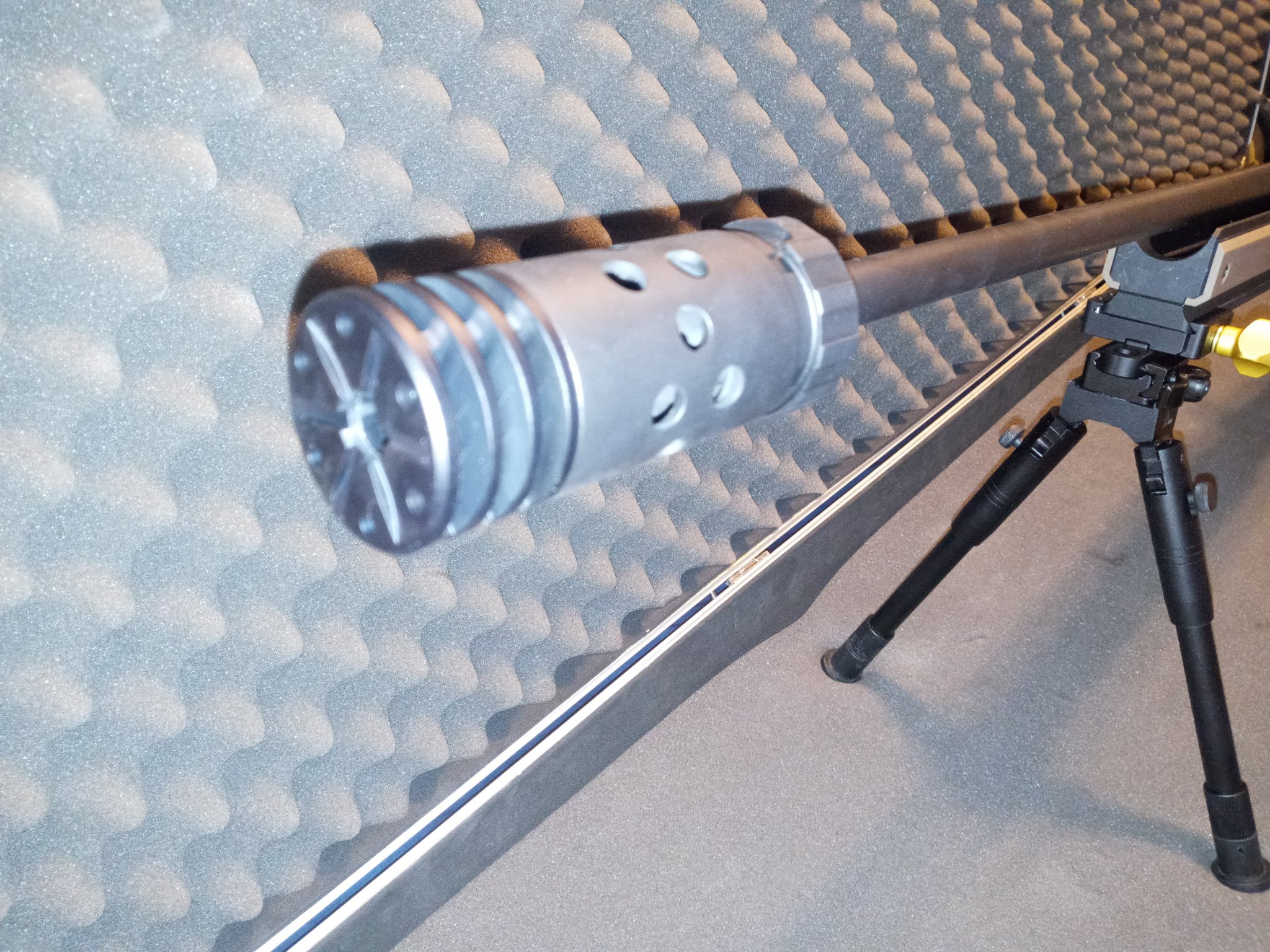

My only experience is with this model, which due to its straight ports and width, keeps me comfortable.
Plus I get to look like a Barrett and it is extremely easy to clean.

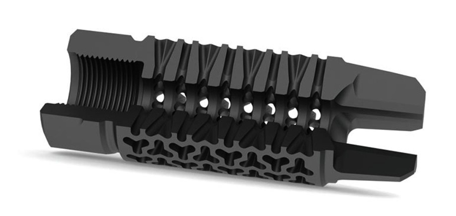

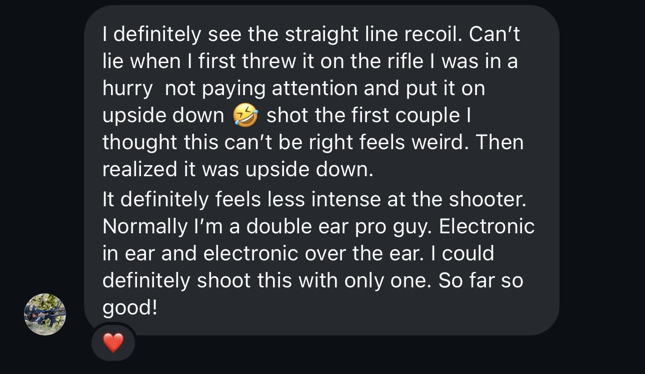

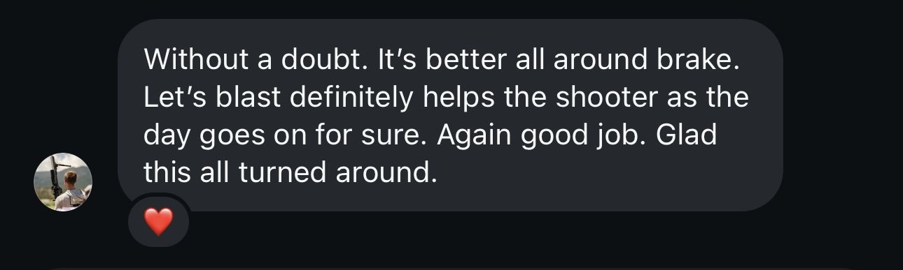

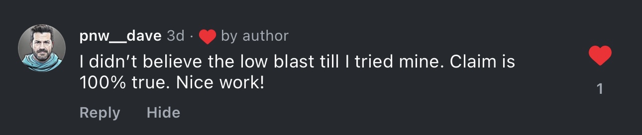

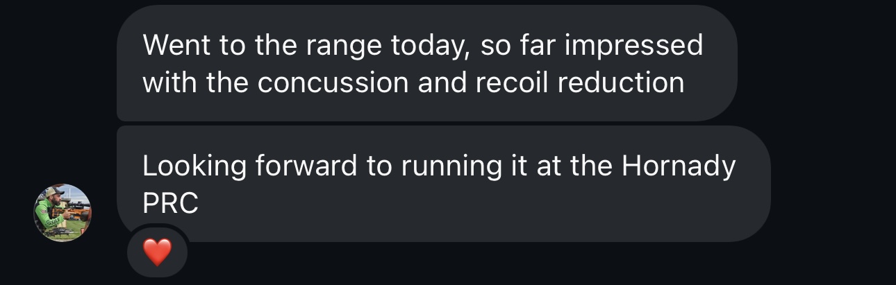

You're sure though? The claims are exactly what the OP is looking for, but I'm not sure.
How could it be snake oil?
It’s simple science.

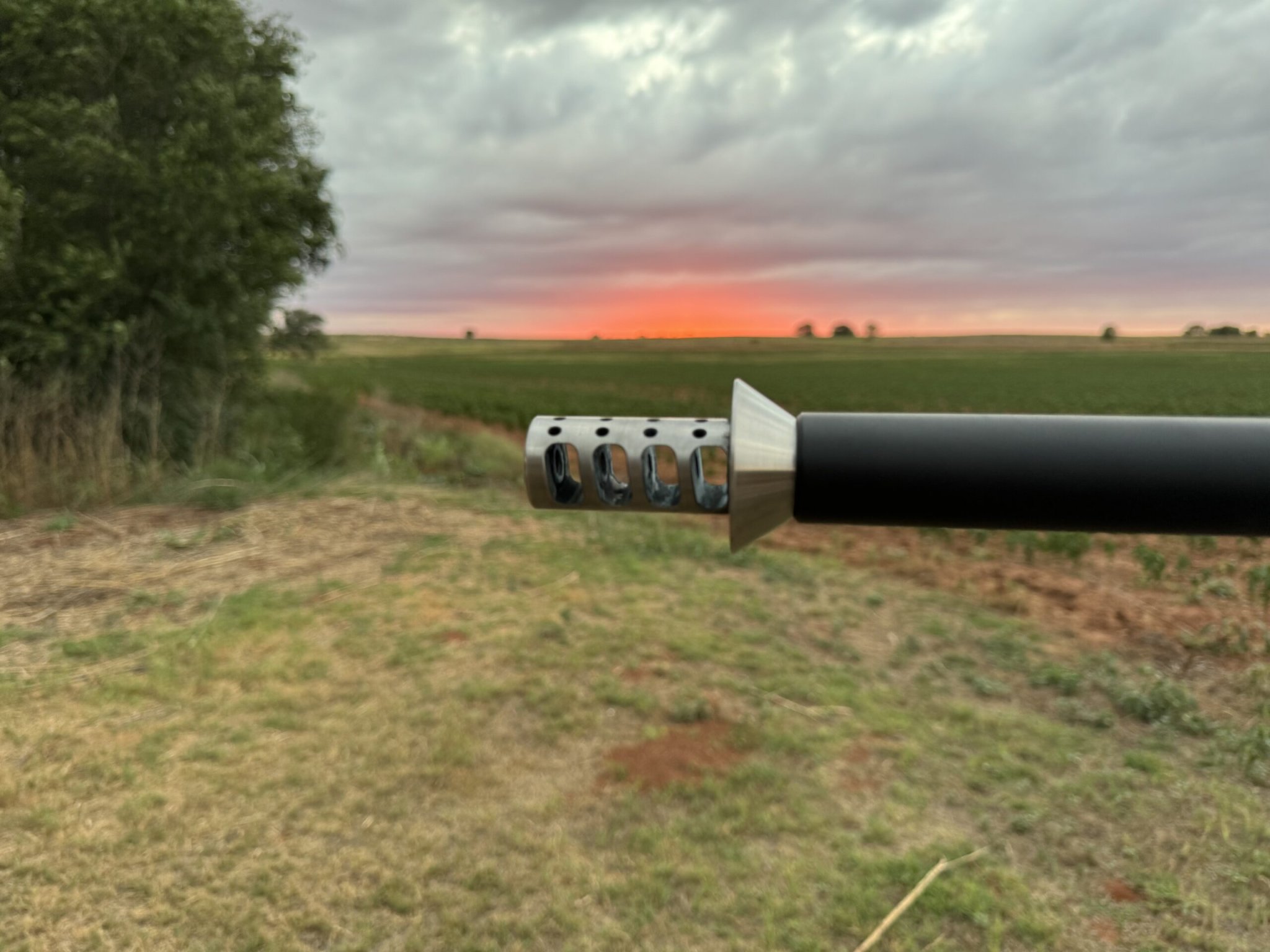

The blast is directed upwards over the top of your head, not back at you on the horizontal plane like all other rearward venting brakes. If it’s not directed back at you then it’s not going to blast you. Same as every other side venting brake.
If side venting brakes are low blast. Then so is the chad.

Have we all agreed on whether the Strike Without Warning CHAD brake is snake oil yet?
I’ve put over 400 rounds on my Chad thus far and It’s performing as it was advertised.
