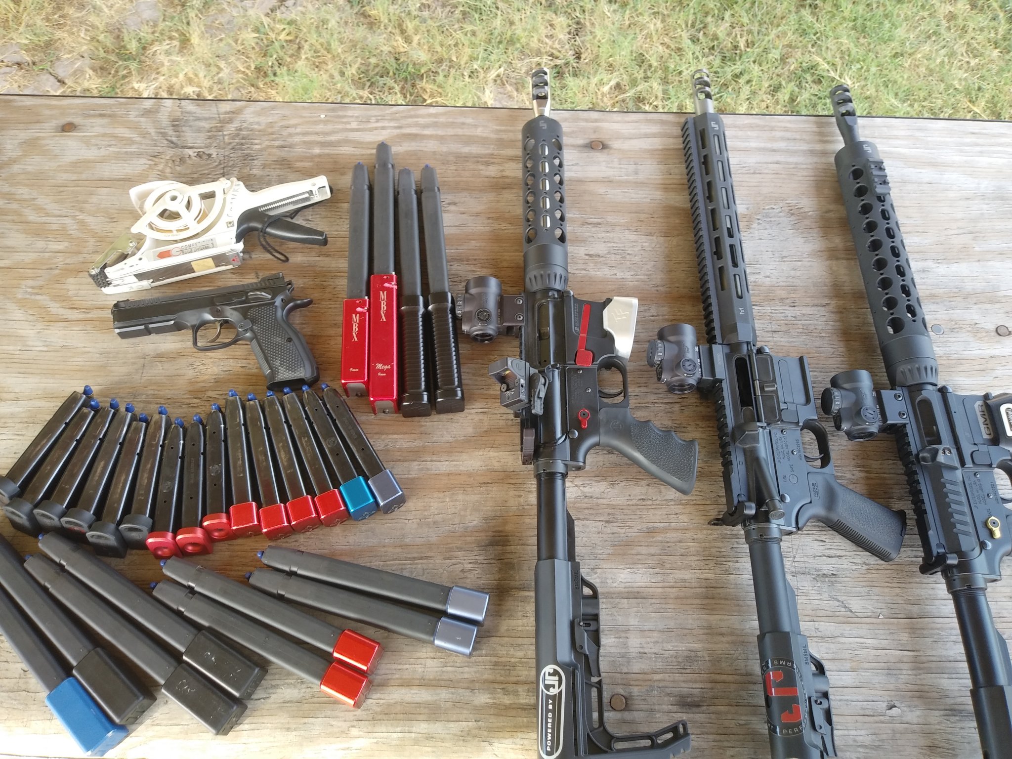

If you want a no nonsense rifle that both you and your son can both run invest in a JP GMR15. I have between 25,000 to 100,000 on various individual JPs and they just run. Loaned out at matches with random ammo or heavy practice sessions.
GLOCK mags, barrel that feeds anything 9mm you can shove in a mag and phenomenal fit and finish. 20190823_180913.jpg

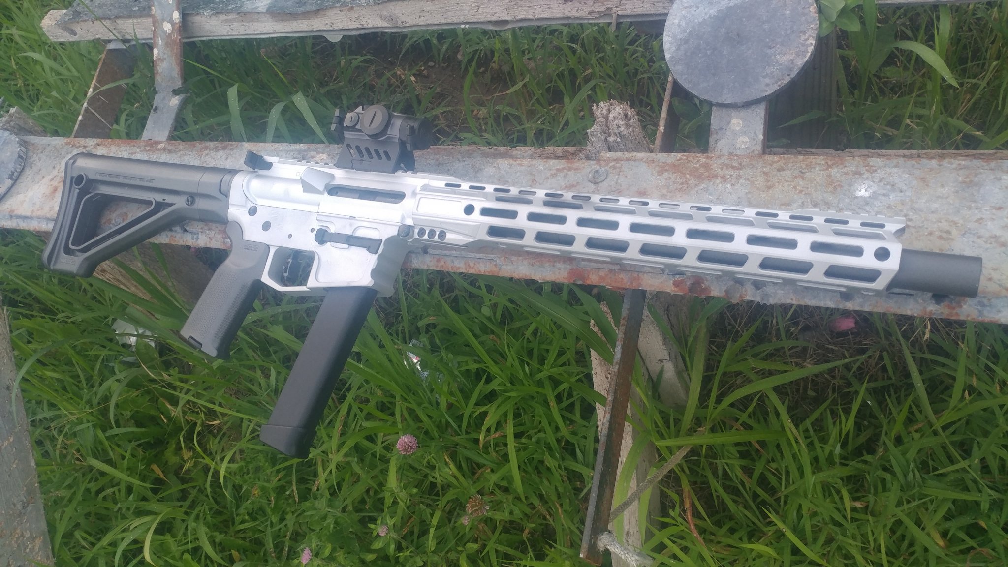

7.5" AR15 9mm with dedicated can is my sons favorite gun. He essentially steals it from me every time we go to the range. Runs like a swiss watch, virtually no recoil, super accurate. I run glock 32rd mags and have a few with the Taccom 65rd billet extension which runs great!!
Spartan AR15 Billet 9mm Glock lower
Spartan AR15 Billet 9mm Upper w/LRBHO
7.5" Wilson 9mm 416SS Barrel Threaded 1/2-36
Seekins 9" MCSR Handguard 1.80" ID to fit can under handguard
Spikes 6 Position Adjustable Buffer Tube
Magpul CTR
Geissele SD3G Trigger
Toolcraft Nitride 9mm BCG
KVP 17-4 Extra Power Buffer Spring
KVP 10oz SS Blowback Buffer
115 FMJ
165gr subs
