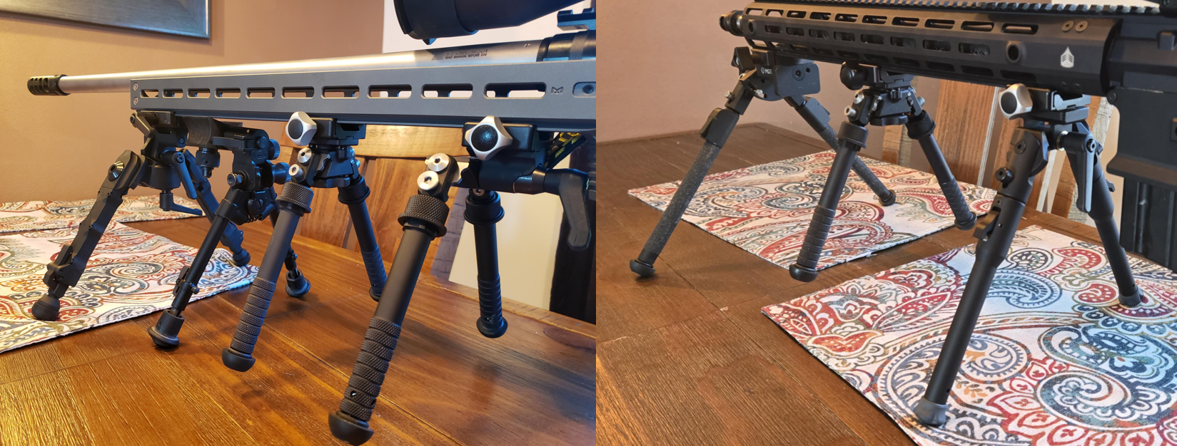

I've run lots of the available bipods over the years (Harris, Versapod, Accutac, Ckyepod, Magpul, Grndpod) and I think the most versatile bipod out there these days is the lightweight double-pull Ckyepod. More adjustability than any other bipod (save for the triple-pull) but relatively light. If you're on a budget, I really like the Grndpod, pretty much the same cost as a Magpul or Harris (with add-ons) but a much nicer bipod, imo, mostly for the ease of adjusting leg height when behind the gun. Pull out legs are just so much faster to adjust than something like the Harris. I run various Ckyepods on all my bolt guns and Grndpods on gas guns.
I have them all too. IMO…
Atlas or Elite Iron for long action magnums and high recoil rifles where you need to load the bipod.
Accutac for no loading comp guns shot free recoil and .22s.
You don’t even need to mount them to feel the difference. The bipods meant to load have slop that you don’t want on a low recoil gun and that you need on a high recoil gun. QED
There isn’t one that does it all better, but every single modern rifle I own has a full ARCA rail, which is a lot cheaper and more versatile than a bipod for every gun.
