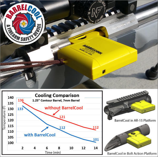

How about adding function to the rule. This might be a little much! HaHaa.
So I have seen a couple of these running around. Is there a legit added benefit, or you think its more of a gimmick?
I bought one from whoever it is (edit, chamber chiller) that 3d prints the other version of those fans and I would say that it does indeed bring the barrel temp down faster.
This summer in the texas heat doing some load development where I just sit at the bench with 4 minutes between each shot I noticed that not using it between shots took an appreciable amount of time to get the barrel cool enough to rest my palm on it compared to when I did use the fan. I never put a watch and thermometer to it but 90+ degrees 4 minutes with the fan got it comfortable, 4 minutes without the fan and the barrel was still hot as hell, too hot to rest my palm on it.
So the cooling effect is real. Now some people say that a hot barrel wont matter or shorten barrel life and that this is a gimmick with no actual benefit beyond the psychological. I feel that theres no way that shooting a barrel until its hotter than hades wont negatively effect its life but I cant provide any proof of that.
I think those "chamber chillers" or whatever they are called are a good idea.
However, for the life me I can't figure out why they are not shaped like a horn (fan at the large end tapering down to fit inside the bore).
Currently the fans look small and the airflow has to make a 90 degree turn.

I’ve got a Barrelcool like what is posted above. I’ll agree that it does seem to help cool the barrel quicker, especially on hot days. That is my absolutely non-scientific opinion, so take it with a grain of salt. The fan is very small and it doesn’t force a ton of air down the barrel, just enough that you can feel it exiting the barrel with your hand. I only really use it during practice or data gathering where I’m shooting long strings. For local matches I use a regular chamber flag.
