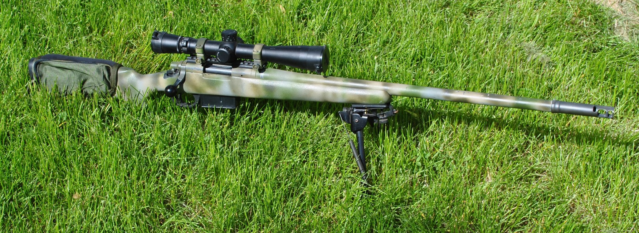

    This is a 700 Varmint that started as a 700 Police. I had the action trued and bedded, and a half-inch chopped off the rear of the factory barrel so it could be re-chambered with a shorter target throat. I replaced the factory trigger with a Jewell but it has a Geissele now.
    Badger is a solid rail. Mine has a Nightforce.
    Magnification is dependent on what you're shooting and how far.
    That was a barrel and stock ago.

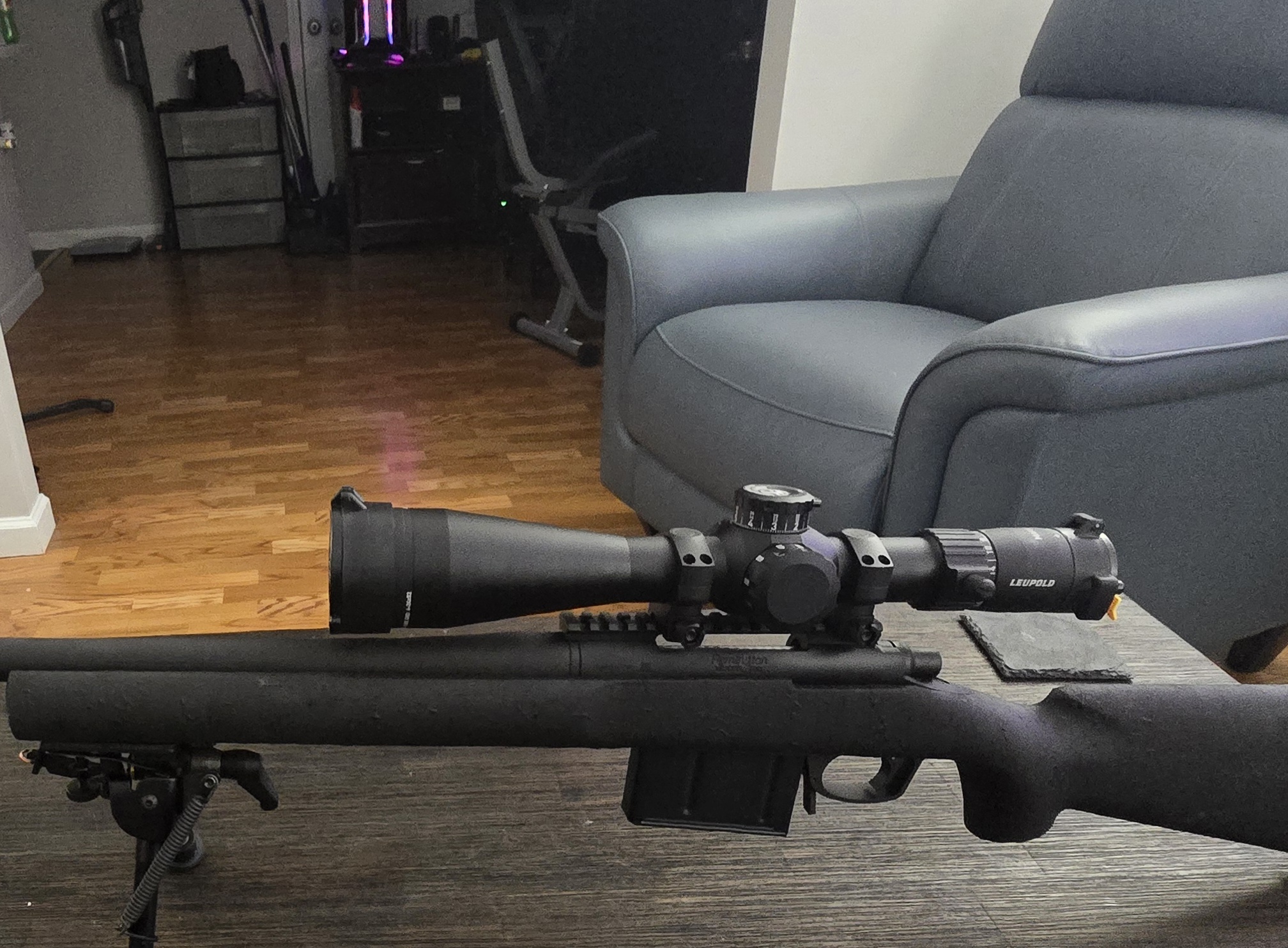

    I decided on the leupold mark 4 with pr2 mil reticle. I ordered leupold high rings for it, but kinda worried they will be too high. What I can find is they are 1.06" high. If that is correct height.
    Those stocks always needed some height added in the rear for cheek weld. If you got one of the new 52 or 56mm objective Mark 4s, your ring height of 1.06 (assuming that is what it is) is good on the objective side.
    On all of my old H-S stocks from 20 years ago I added a stock pack to get my eye up to the proper height.

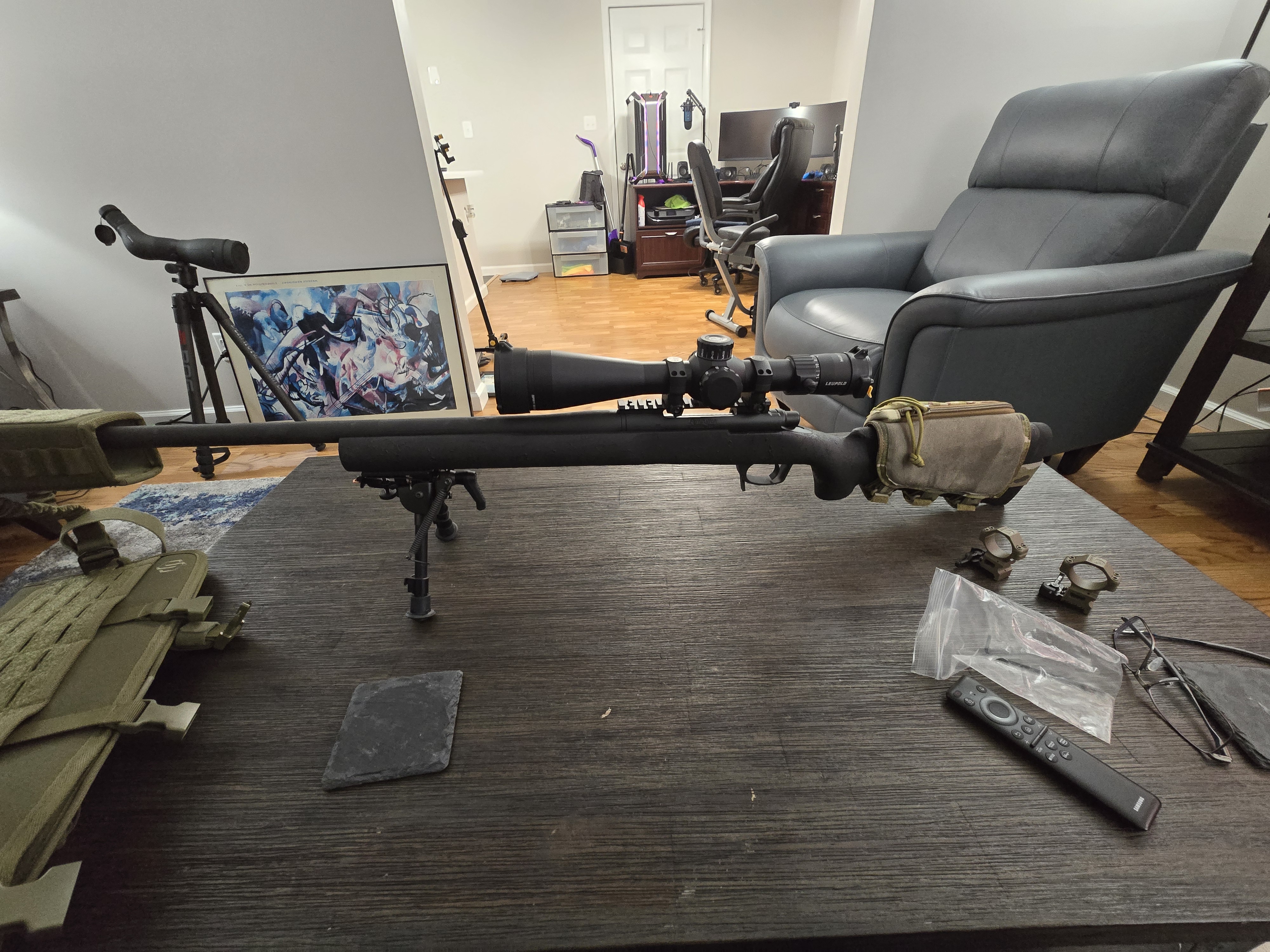

    Another l question for the fine folks. I have a vortex strike eagle 5-25 ebr7 inbound soon. How's the glass compared to the leupold mark 4 6-24 that's on my 700 currently. How much of a downgrade would it be to swap the leupold for the strike eagle?
