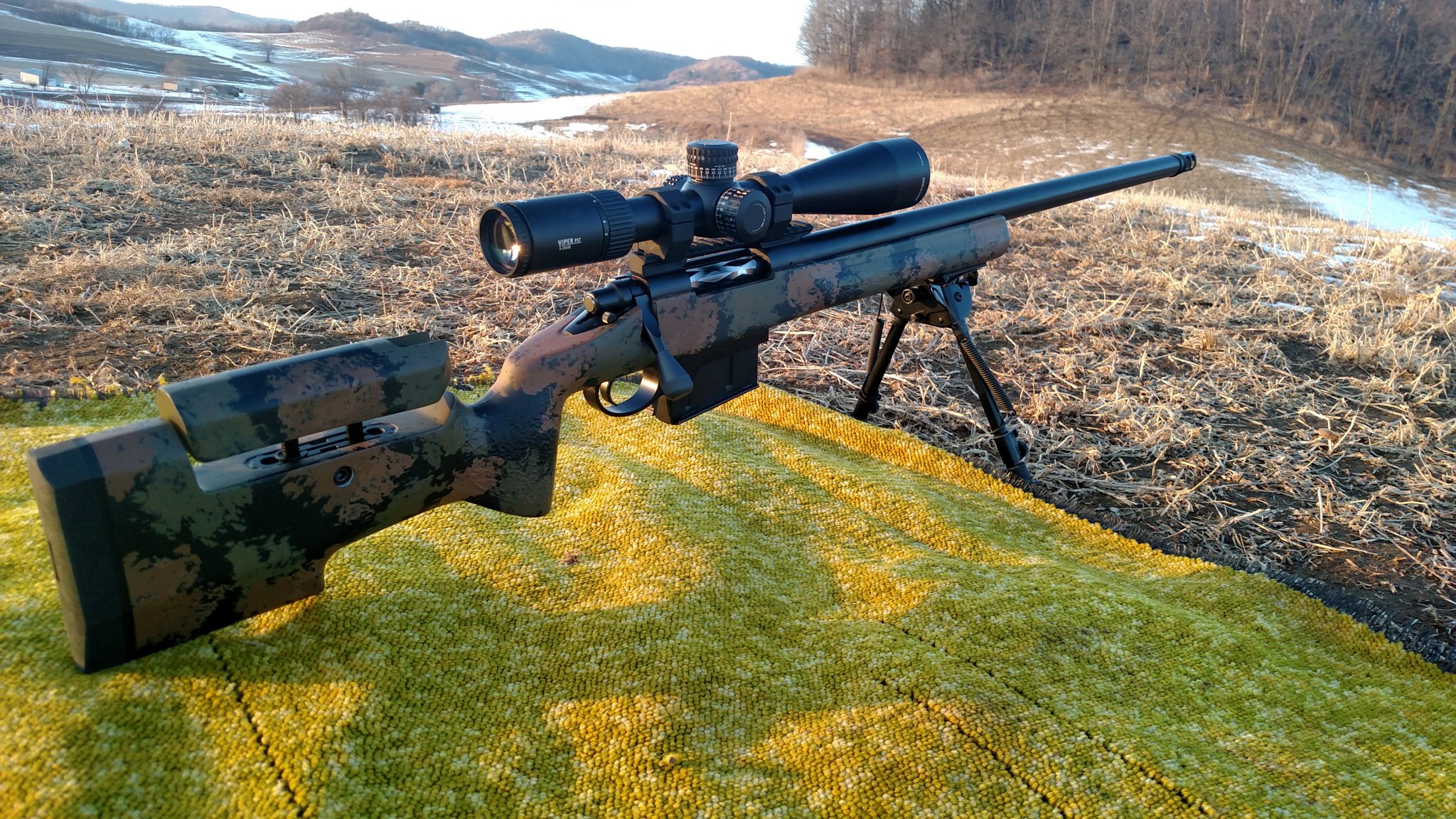

Pic of my first PRC

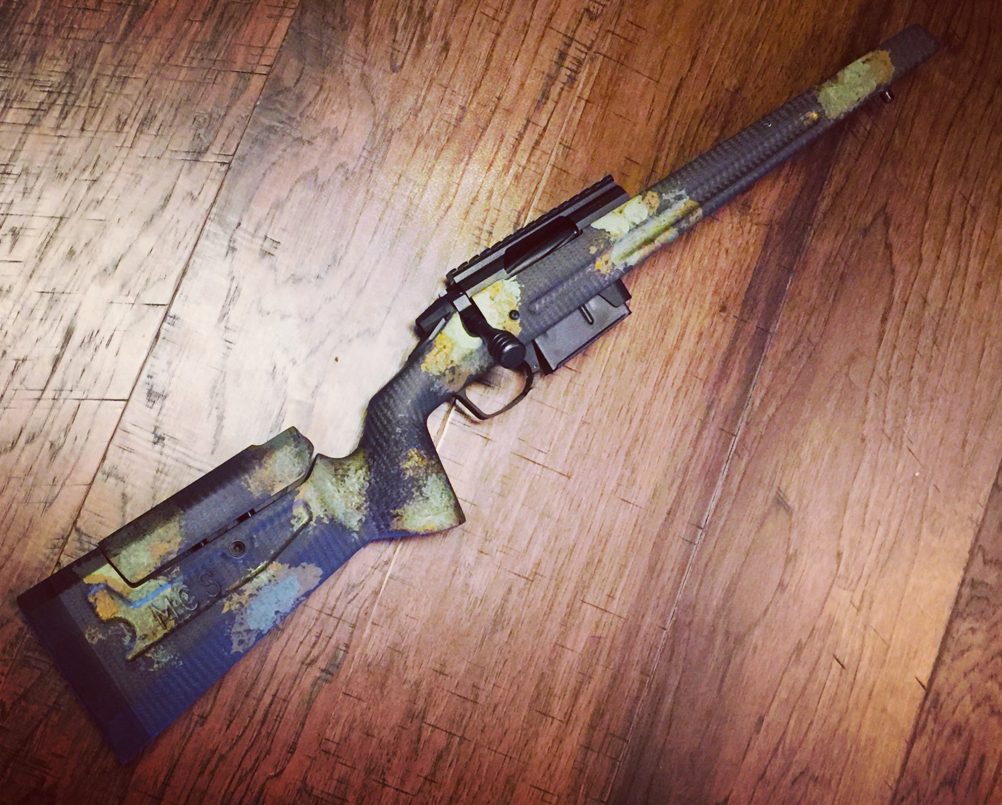

I just bought a Christensen MPR in 6.5 PRC. Seems to shoot alright so far. About half way through load development. 24" 8 twist around 2970-3000fps with a 147. My Accurate mag feeds great. My alpha not as well. I think the feed lips need tweaking.

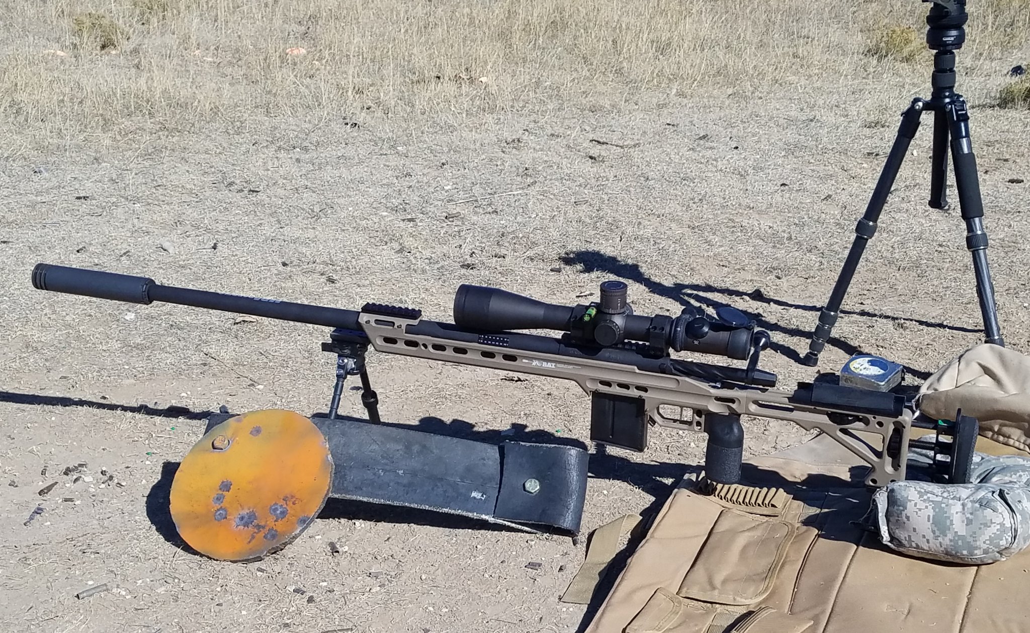

I have an off the rack MPA built 6.5 PRC. Curtis Custom Axiom (short action) M24 profile 26" barrel 1:8, MPA Competition chassis.
Factory Hornady 147 ELD at 2.955 COAL in AICS (no binder plate) mags feed and shoot fine. 3020 FPS, sub .5 @ 200 5 shot groups, and stay sub MOA at 750.
My final handload recipe is 54.14gr RL 26, 2.950 COAL, .0015 neck tension, Hornady 147 ELD also running at 3020 fps
Same loads set back to a 2.890 COAL to fit in a Ruger AICS mag with binder plate reduced my FPS to 2970, accuracy is the same.
I can not speak to barrel life as I only have 400 down the pipe, and am on hold until I find more RL26. My firing schedule is 6 shot strings then cool down.

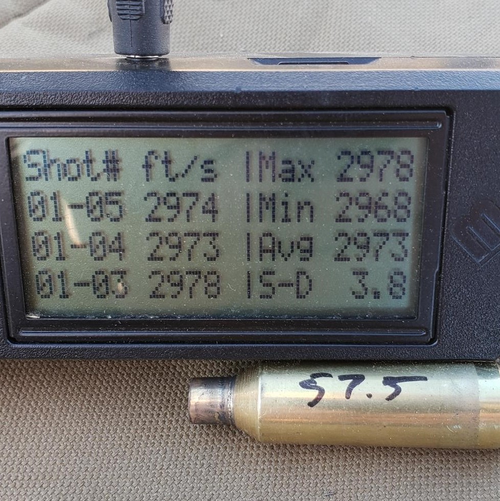

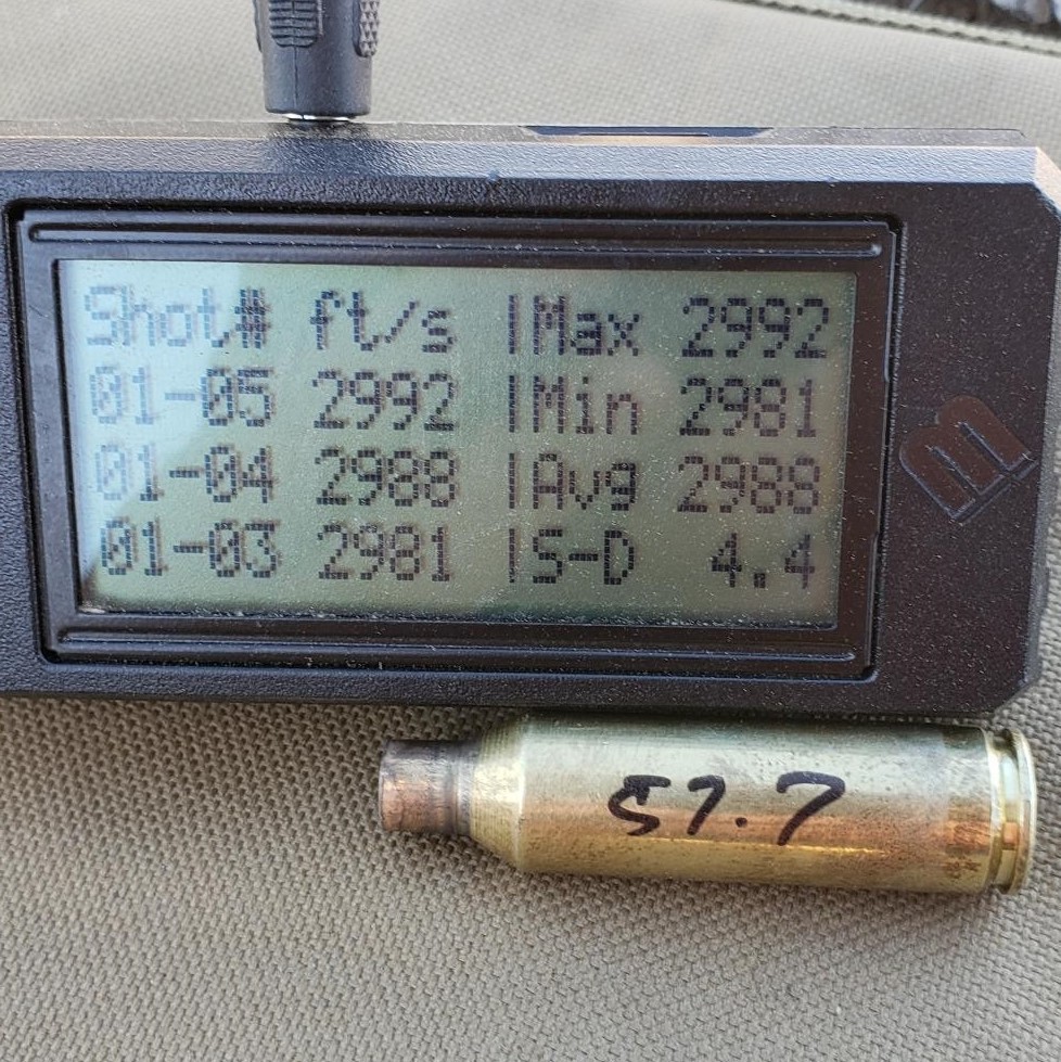

Nice!! That barrel must have sped up a lot!!! 54.1 grains of rl26 at 2.99” only gets me 2800 fps in a new 24” barrel. I’m really hoping mine speeds up. Sounds like they do after about 150-200 rounds
You sure on that 41 grains? My load development started at 44 IIRC and I was in the 2600s...I will need to double check my notes, but that seems right.
And yes, my barrel did speed up at around 80 rounds. Drove me nuts with my ballistics and load dev.

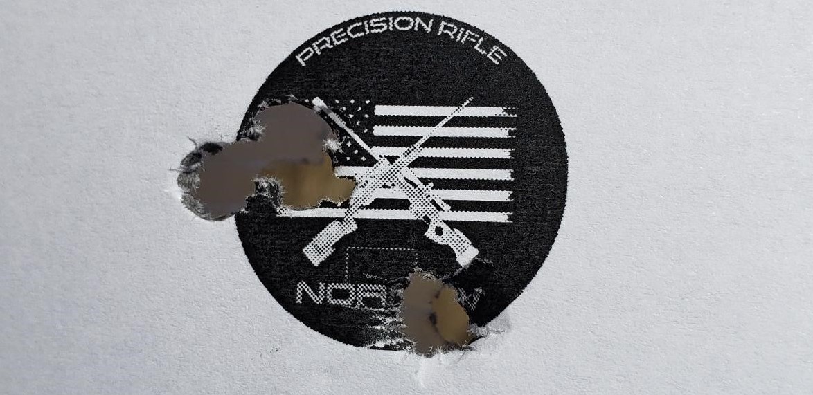

1" circle, that 5th one might have been me? typical group size.

Pic of my first PRCView attachment 6985493
Can you give me the full details on this rifle. I love the look of it and would like to duplicate it.
Reactions: Squibbler
Apologies for late response. Was going to try and find spec sheet I had for build, but have not located with first search. Off the top of my head it was a Manner's T4A in black forest camo and PTG DBM. AICS mag. Trued Rem 700 long with PTG bolt spiral fluted. Timney 510. Krieger #9 heavy target 26" 8 twist black cerakote, TBAC brake. Think it was precision armament 20 moa rail.
If need further details will have to try harder to relocate spec sheet
Reactions: dwamsley
