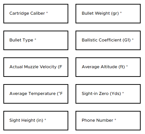

Just playing around and volume plinking... Steel out to ~300yd Max. Plate sizes vary. Rifle is a Bergara BXR002What are you using this 22 for?

I don’t love the idea of cds for rimfire cause your dope changes so rapidly and precise adjustments are needed. However I think the cds for the average centerfire rifle hunter is exceptional. If you put in the right info then there very accurate. I’ve set up two cds rifles for friends who just want to hunt out to 400yds or so for whitetail and the dials are dead on. For the competitor or guys that are into shooting at a different knowledge level then yes dialing is probably better for them. To say the cds system is stuck in the 90s is a ridiculous statement since for the masses with the right input it is fantastic.
Agree. For hunting out to appx 400 yds here in Pa, all of mine have been dead on on my centerfires. For a farm rimfire, I have almost bought a CDS scope to put on a 22 many times (and most likely would be using CCI-SV like the OP). Minute of a groundhog... Following...I don’t love the idea of cds for rimfire cause your dope changes so rapidly and precise adjustments are needed. However I think the cds for the average centerfire rifle hunter is exceptional. If you put in the right info then there very accurate. I’ve set up two cds rifles for friends who just want to hunt out to 400yds or so for whitetail and the dials are dead on. For the competitor or guys that are into shooting at a different knowledge level then yes dialing is probably better for them. To say the cds system is stuck in the 90s is a ridiculous statement since for the masses with the right input it is fantastic.

Leupold will cut a new turret with current data at any time. For a reasonable fee. I've watched guys gather data for 2 loads, 2 turrets needed, one free.The EXACT problem with the system is that most times the unchangeable input that made the dial is no longer accurate.

Hey. Yeah, ordered back on Jan-24. Leupold promptly shipped Jan 31. Been sitting on my bench. Had no chance to install and test yet. Will let you know how it goes when I get to the range with it.Op...did u receive your cap and did u have a chance to try it? Anxiously awaiting your results
I am asking sincerely here, you say extreme long range 22LR. Aren't most Leupold CDS systems based off their ZL or ZL2 turrets? Where the scope can have X amount of total travel, yet on ZL, only 14 moa available, or ZL 2 with 38 moa available to you, no matter where in the scheme of things the reticle is zeroed at.For 22 I like the cds for hunting or plinking and dial with exact weather for extreme long range or extreme accuracy.
