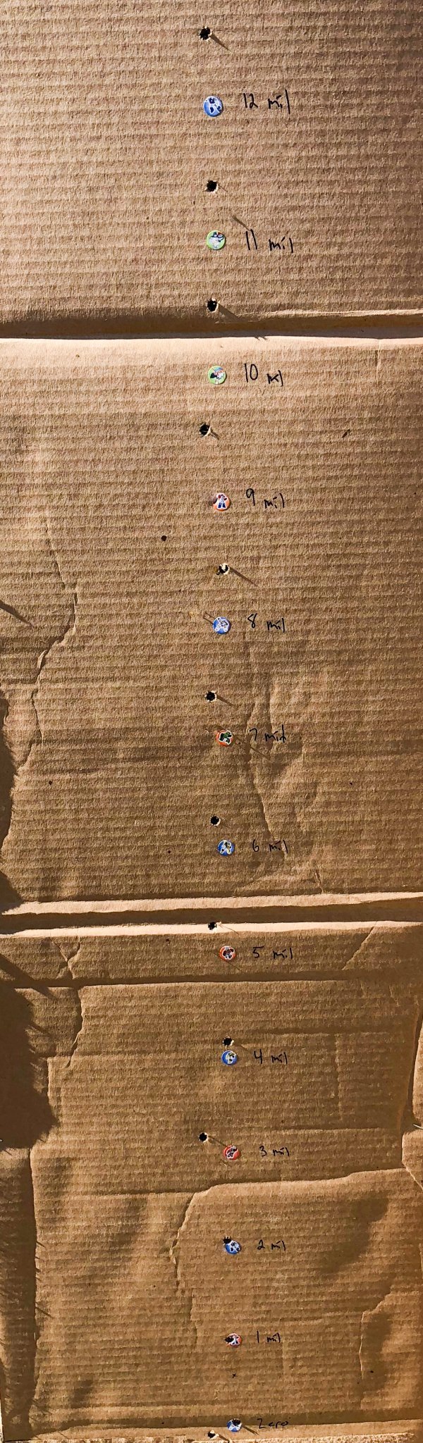

Good out to 2mil and kind of returns to zero.... That's pretty good right?! o_O
Back to Leupold it goes...
If you see some editing marks that's because I ran the test twice on the same target, this was the second run as my zero was off slightly for the first. The scope was at least consistently bad between the two tests... A 45" spread over 12 mils - or high about 1/2 mil with 12 mil dialed.
This was the 4.5-14 FFP TMR version. I really want to like this scope as it checks all the boxes for me in a lightweight hunting scope that has all the features of a precision rifle scope, but parallax is hard to get rid of and now the tracking issues... I’m quickly losing interest in it.
Hopefully Leupold makes it right.

I was looking for the same thing for a hunting scope.
I know it's popular to bash leupold these days but there is some basis for it, which is why I didn't go that direction.
I'm sure leupold will make it right for you. If you decide to go another direction, I've Been very happy with my LRHS. Not as light, but checks all the other features.
I ran a mechanical tracking test on a 6.5-20 LRP and it tracked well running a 5 x 10 mil racetrack. I still need to put it through its paces but so far so good.
I railed against this line when it was released and it's not hard to do when you compare it to some of its contemporaries. That being said the cch reticle is cool, it's light, ffp, and appears to track, so it's not all bad. I am no fan of leupold but I'll give credit where it is due.
Reactions: trob_205
I picked up a CCH 6.5-20 so kinda hopeing it’s shakes out the same. I havnt had a chance to play with it yet tho.
