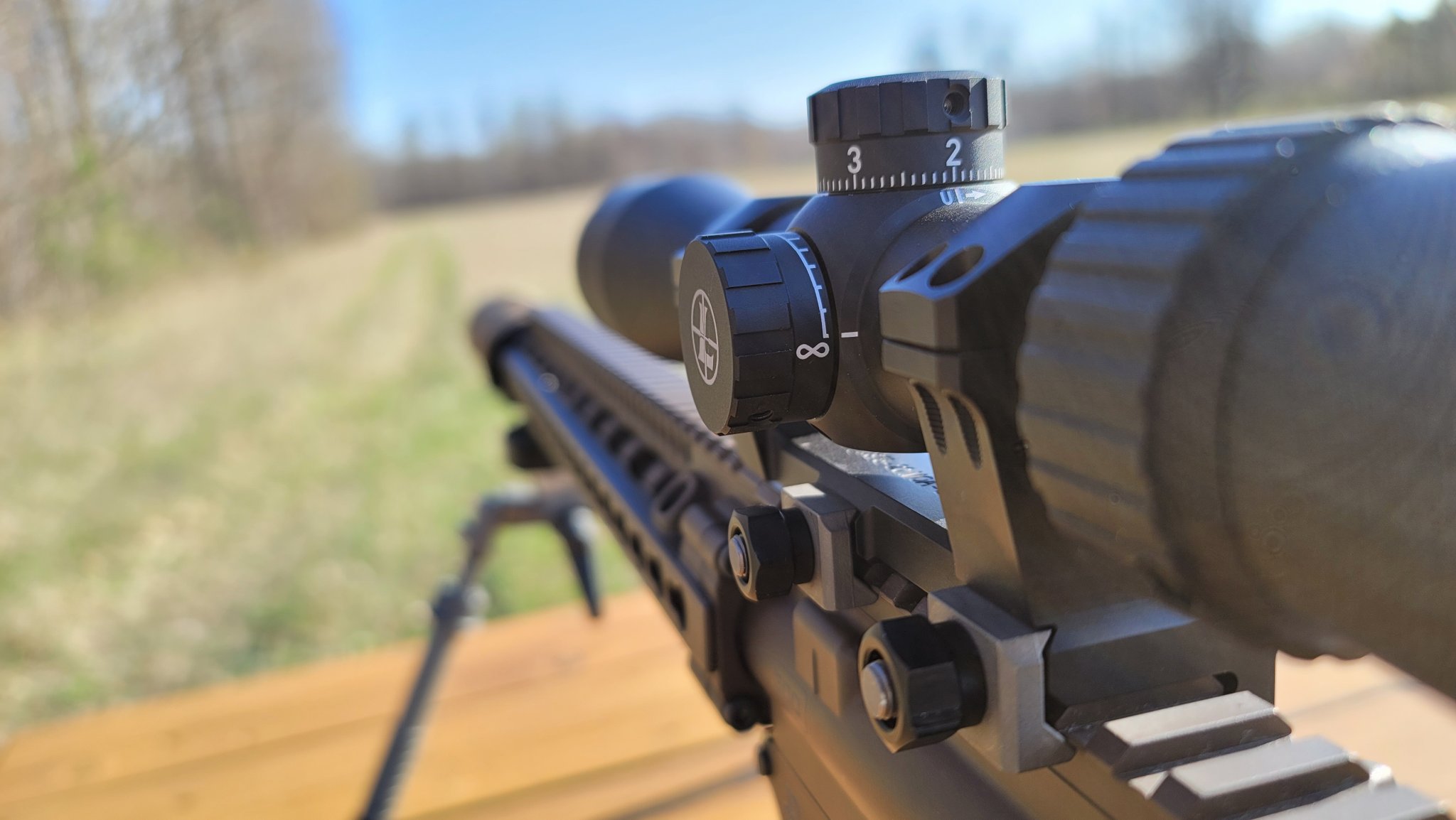

Well, got it a day early. If you have a VX-5HD, it is built almost the same, body and looks wise. Just a couple minor differences.
The MK-3HD 4-12x40 is built very similar to my VX-5HD 3-15x44. I know, I'm comparing an apple to a pear. One costs twice as much but it's the closest thing I got. Otherwise I would be comparing it to a 34mm Tract or a 1-8 NX8.
Comparisons with it unmounted for now till I get it mounted and out Sunday.
  • Elevation turret, the MK is more tactile and audible. Where the VX is just distinct, more subdued so it is not audible.
  • Windage is identical. They are both capped and suck, Squishy, mushy, garbage. Adjust and never touch again.
  • Parralax nob, is reversed/backwards to everything else I have ever owned. Which I saw long back when I ordered in Jan. Infinity is at the bottom. It is smooth, not hard to turn, but enough resistance I would not see any issues with.
  • Mag ring, is also smooth, not overly stiff. It is a quick short through, only a 1/4 turn from 4-12. Not as smooth as the VX though. I am nit picking here. You just feel the ring glide against whatever it is around. Throw lever is nice.
  • Diopter, is smooth, and stiff. I don't see it moving by accident.
  • Reticle, is thicker than I would like. For my purposes though, not a deal breaker. Going on a 16" 300BLK for the purposes of hunting and general plinking.
Other thoughts. More nit picking, it looks hastily put together. Oil marks in a few spots, and the parralax doesn't line up when rotated to whatever the minimum is. Which I can not find listed. But it spins waaay past infinity. I'll see if I can figure out what the minimum is. I'll post that after I have shot with it on Sunday. Two set screws looks like it loosens it. I'll probably adjust the minimum line for 100 Yds even if it will remove paralax with clear focus at a lower yardage like 50 or even 25. Like I said, it spins way past infinity with where the knob is set now. They are only lines all spaced evenly, not numbers like on the VX-5HD.

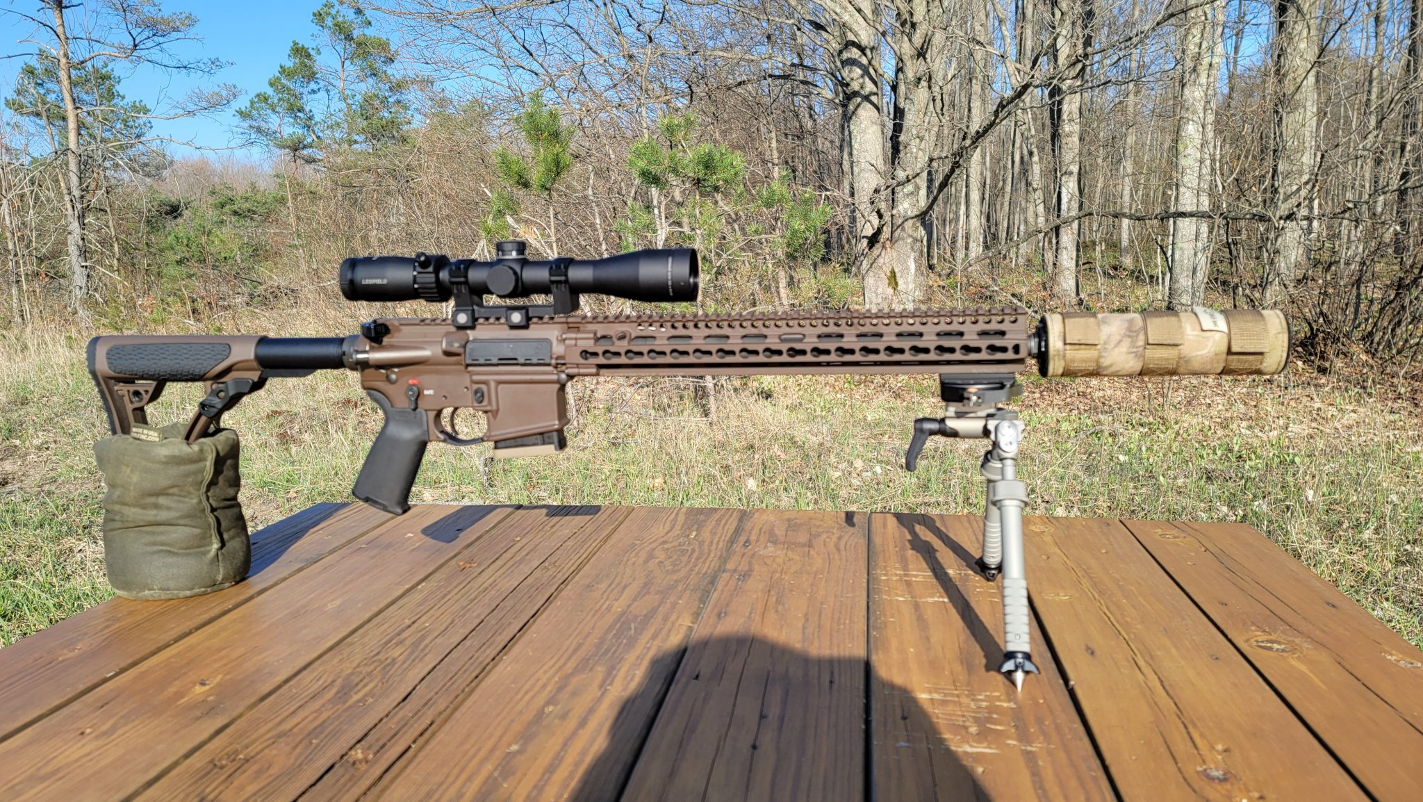

Got the rifle sighted in. In continuation of my initial thoughts. (Thanks phone, but I was trying to get a picture of the rifle, not woods. Sorry for the slightly blurry rifle.)

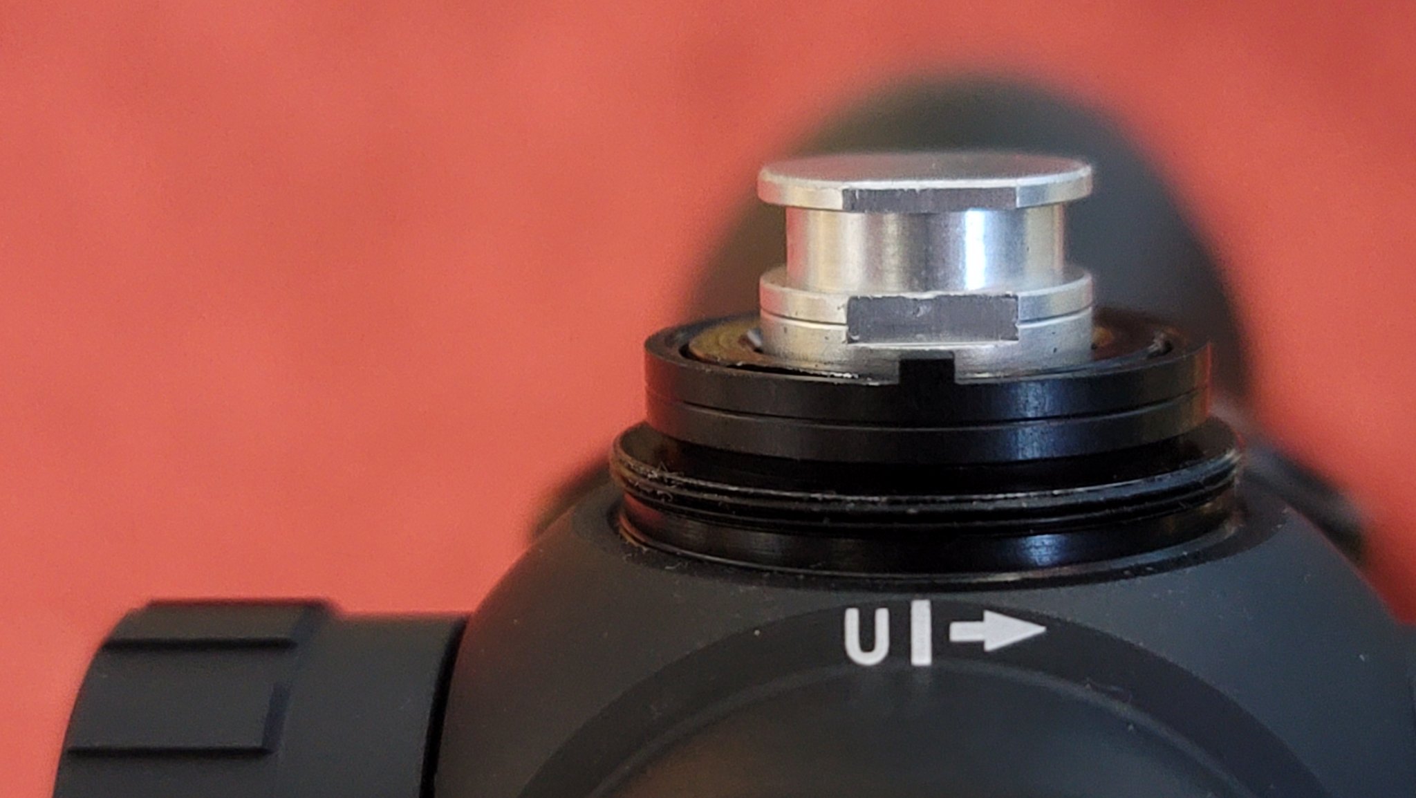

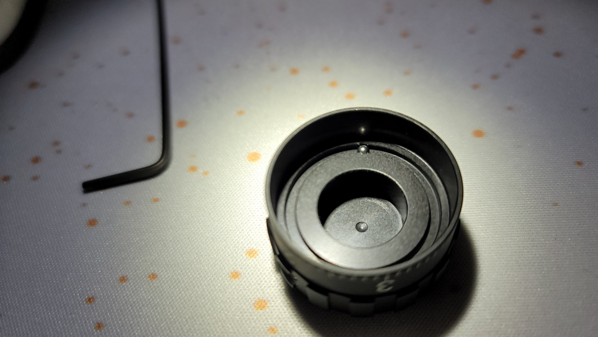

Zero stop is simple. Just a pin under the turret cap that contacts a ring with a pin sticking up on the scope. This only allows for 5.6 Mils of elevation. Does want to go past 0 just slightly, not sure if that is something I can adjust as the stop on the scope looks like a pressed on ring.

300BLK with 150gn Fuocchi FMJ, I was only able to get 3/10 at that distance, but I don't blame the scope, or the rifle. Ammo is definitely not match. Unable to test return to zero. That will have to be up to someone else.

I got mine and will be returning it, I did not realize I could only be getting 5.6 mils out of this scope. Which just seems INSANE to me.
I got this for a light weight hunting rig, and the thought of only being able to use 5.6 mils is a no go for me.

Did you confirm what I wrote, or just go off what I said? Cause I could just be an idiot and not know what I am doing lol. Like I said though, zero stop is simple.
That could be there by design. The ability to go .2 or .3 mils "below" 0 gives some flexibility when switching ammo or changing conditions affect your zero.
agree, it’s a nice feature on my MK5’s...

As much as I would like to fix the little bit of over travel as well at 0, I don't want to screw anything up. Not sure how the zero stop ring is on there.
