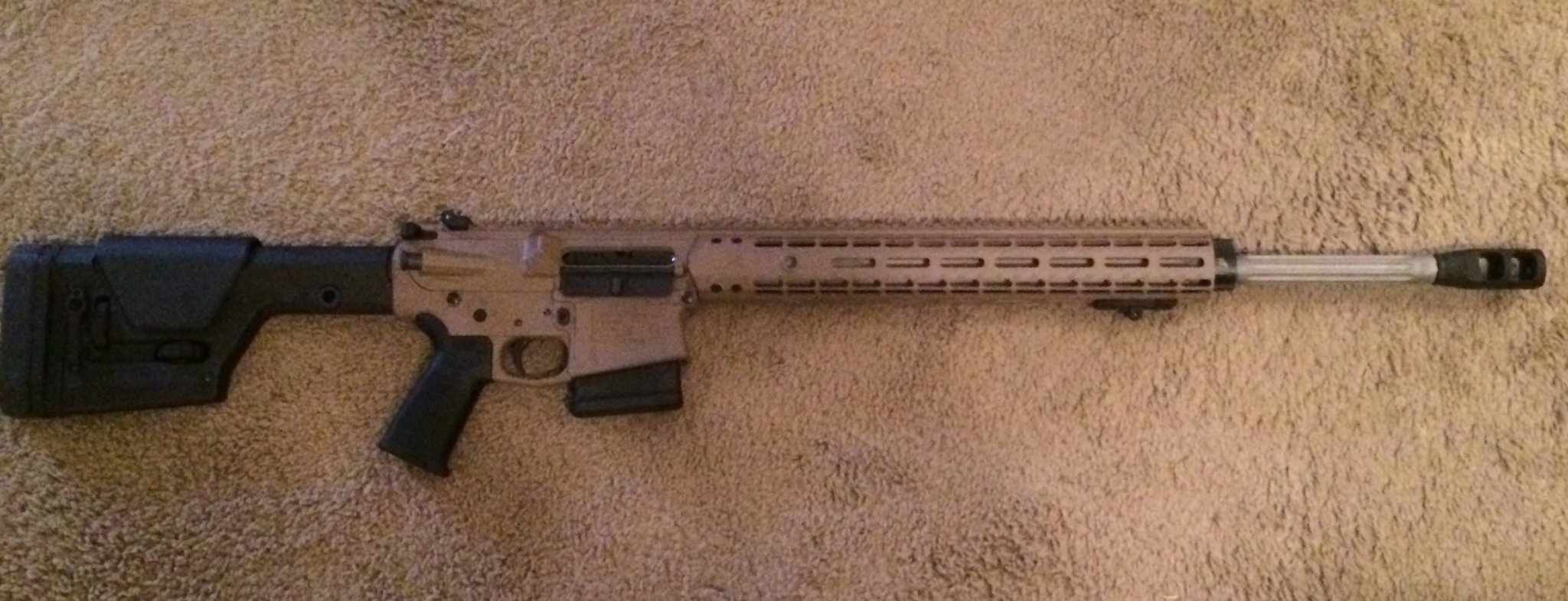

Options I'm aware of are the Leupold Mark 6 cantilever mount, Spuhr 5602 or 5616 cantilever, American Rifle Company M10 QD-L, MPA BA, and Vortex cantilever. I don't believe the MPA mount is high enough.
Cantilever is nice if you don't have a full rail or don't trust the receiver-to-handguard transition to be solid and repeatable. One piece mounts (cantilever or not) usually have options to cant the scope for increased elevation travel in the scope, where standard separate rings usually don't.
The Spuhr is likely the most expensive and likely the best, followed by the ARC M10, but the others would work just fine as well.
