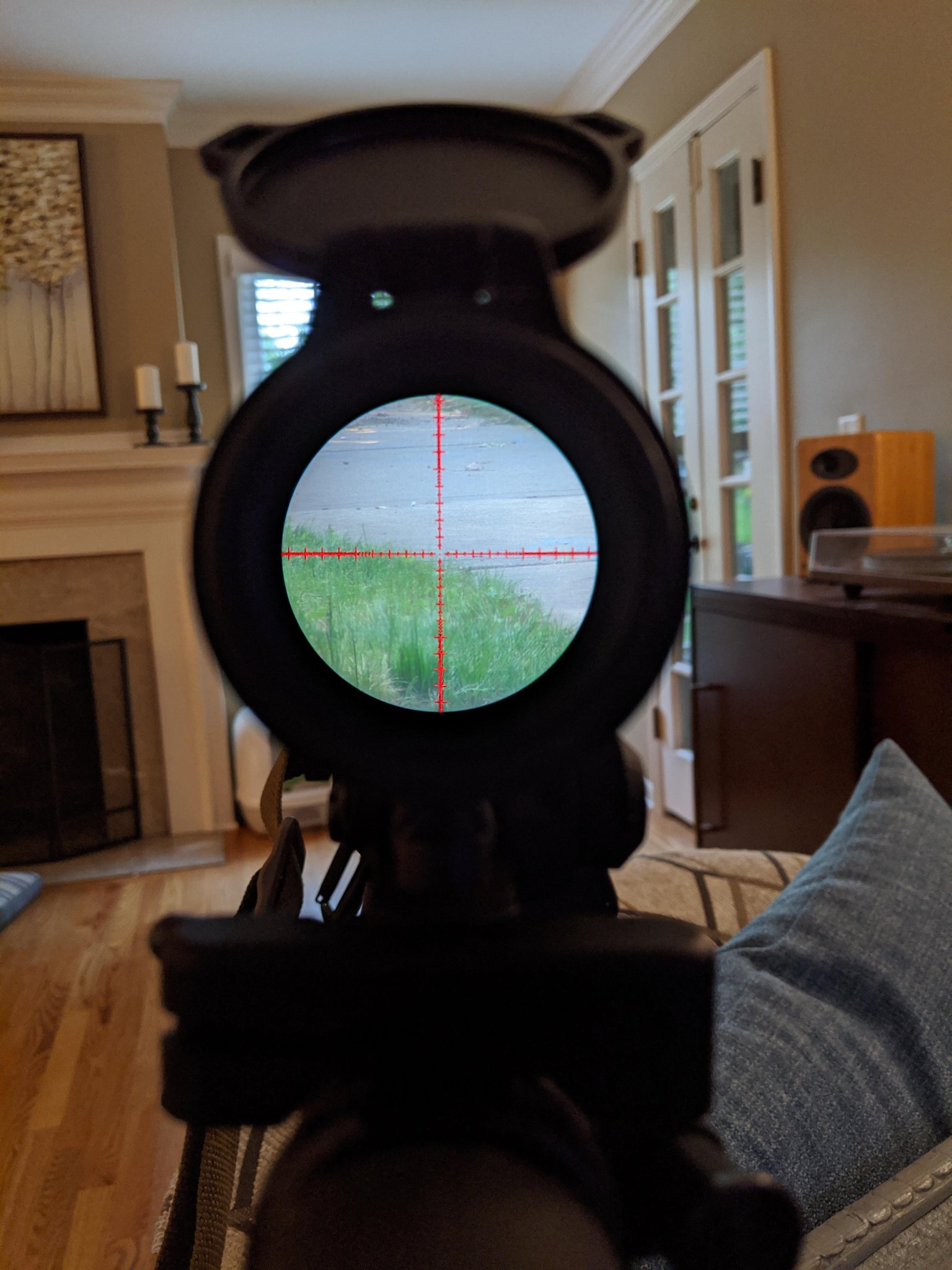

Pr1mil illum reticle is better than tmoa illum. Compared both.
