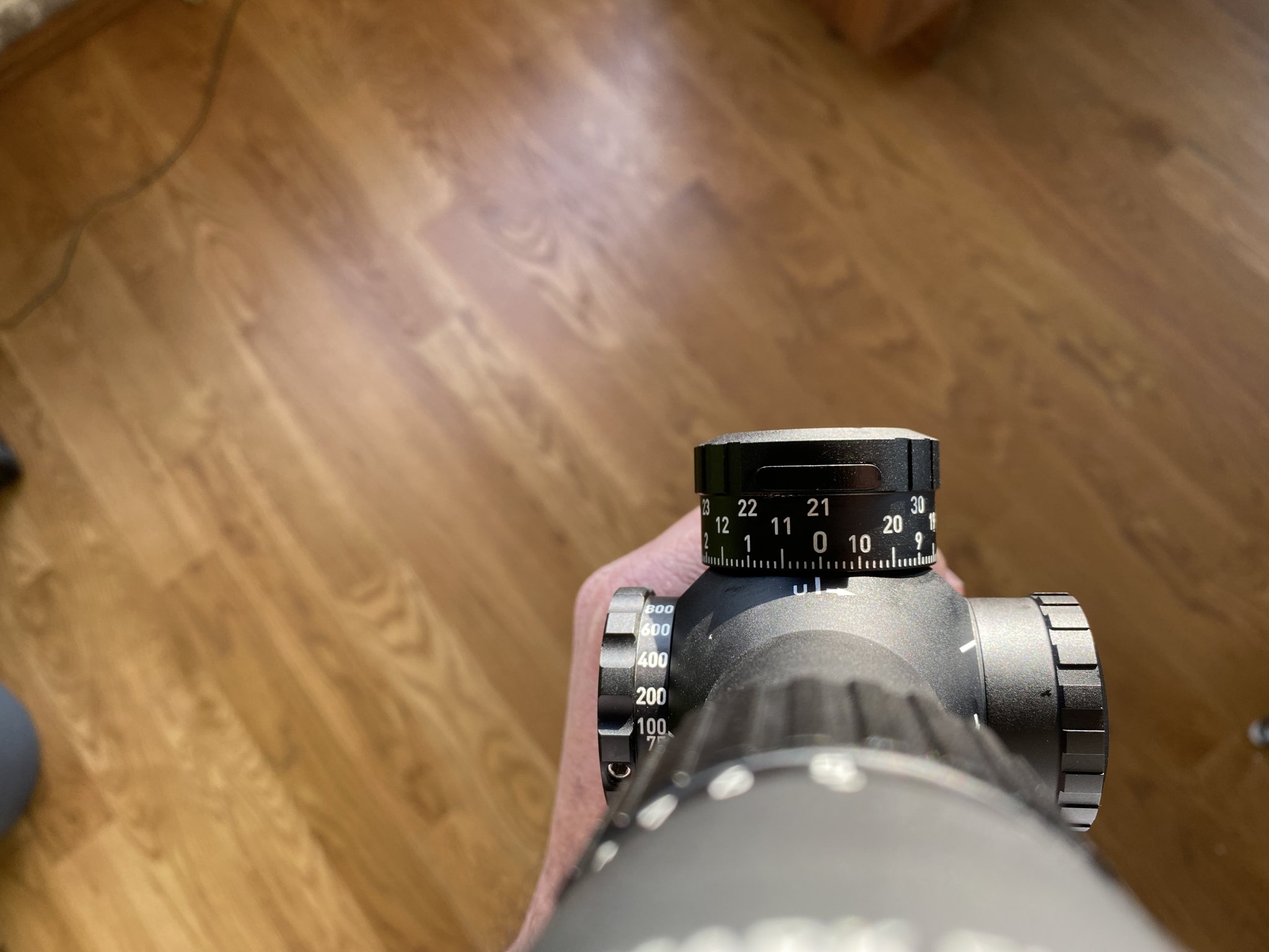

    What are the turrets "supposed to be like" on the Leupold Mark 5HD? Do the tick marks perfectly align? Does each click correspond directly with tick marks on the elevation knob being directly aligned to the reference mark on the scope tube (i.e., you don't have to spin one click past your destination and go back to get alignment)?
    I want to make sure my expectations of a $2,200 MSRP scope aren't... out of line.
    Story:
    I just received my second Leupold Mark 5HD. The first one delivered to me had a bad turret that wouldn't unlock (without a lot of force) and would only turn just shy of one revolution before getting stuck again on the lock. The tick marks on said elevation turret were also very misaligned -- in fact the entire turret structure below the elevation turret was slightly off vs the reference mark on the tube. I contacted Leupold, they said they'll warranty it. Fine... except I have to be without my brand new scope for (according to them) about 6 weeks. I mean shit happens and Leupold's staff was nice and give me an 2-day shipping label there but... the next 6 weeks for me is the most time I'll have all year to go shooting so I asked the reseller... exchange? Thankfully, after a bit of a "debate", the reseller exchanged it.
    Welp... received the new one today. The elevation turret on this one is kind of loose feeling. The tick marks are again misaligned vs. the reference mark on the tube. This time less so... that is until you get to about where the 6 MIL tick is and then the alignment is just completely off. On top of that, when I turn the dial, I have to manually place the elevation knob's tick mark in alignment with the reference mark when I reach my destination (it's like... a gummy feeling turret) -- they don't just line up, you kind of have to go one click past your end point and return once in order to get the tick marks lined up properly.
    My Nikon FX1000 is better than this and it cost me 1/4 the price. Most of my hunting scopes are Sightrons... the tick marks line up perfectly all the way around the dial.
    Is this how Mark 5HDs are? Or am I just riddled with bad luck here?
    ANOTHER bad one. In a row. I don't get it...

    The play you are describing is what I have, yes. When you advance a click, the turret tick mark is actually almost entirely past the reference on the tube. I have to manually go ever so slightly backward to realign the turret. Even at 0 the tick mark is not dead aligned. All of that is absolutely infuriating right there... but eventually the tick marks just don't align no matter what starting at about 5 MIL then it gets bad by 9 MIL almost advancing into the next tick mark when it shouldn't... then mysteriously cleans up again as you get closer to the 0.
    The play, though... on a $2,200 MSRP scope... when I have Sightrons, for example, that cost 1/4 of this thing and they line up AT THE CLICK every single time and have next to zero play. I get that play is a thing with these zero stop turret designs and what not but common... mine is bad.

    I don’t have the misalignment issue that you’re describing. I just ran through the range of adjustment and it is aligned throughout. Although I can induce the the faintest bit of play, if I release the pressure the turret is centered.

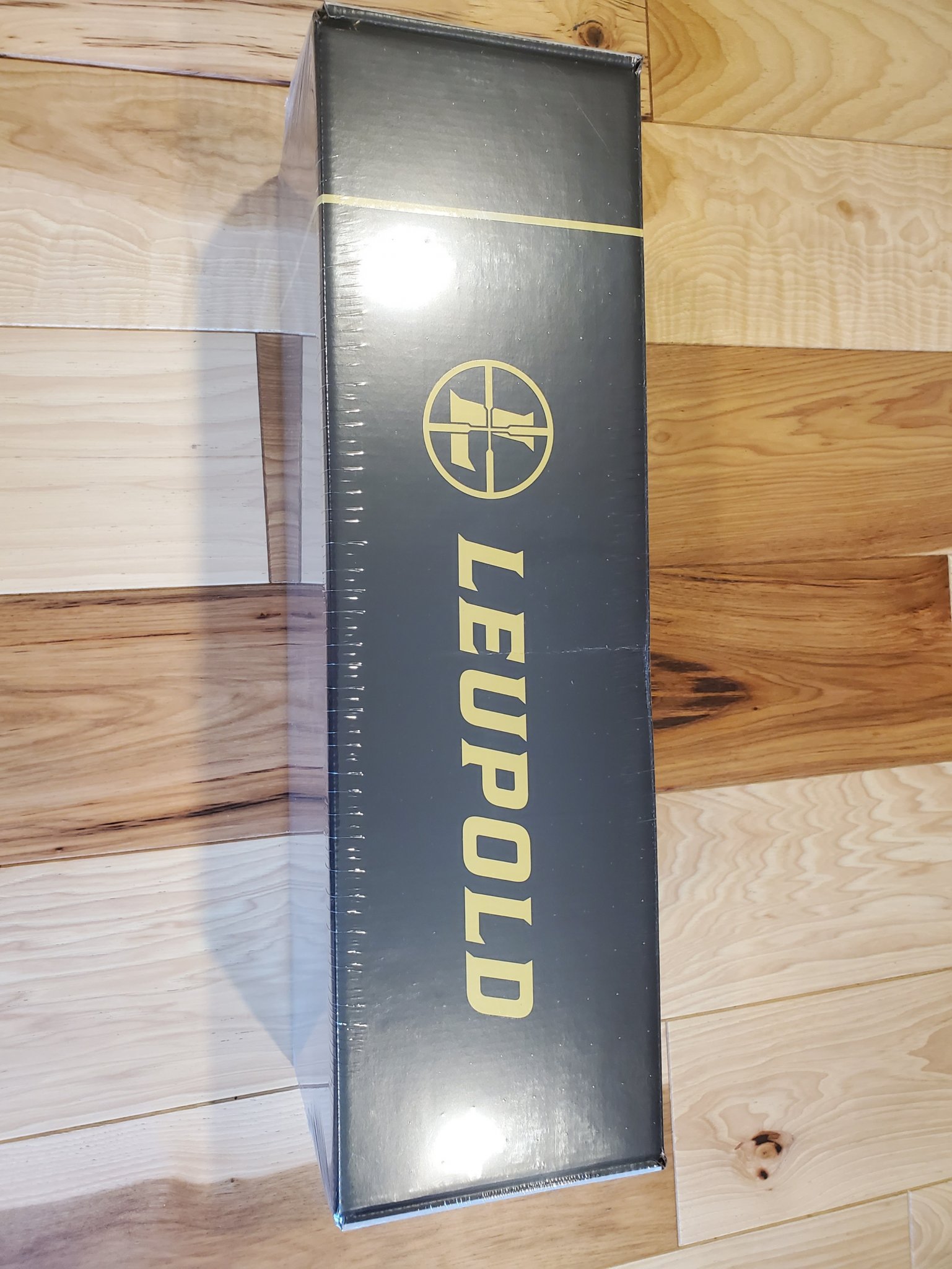

    The photo below is the first scope I got on the zero lock straight out of the sealed box. Lift off the turret and you see the lock detent is off-center, too. The second one I didn't take pictures of -- I was pissed to high hell and boxed it back up and emailed the reseller demanding I be refunded so I can move on. If they refuse, well... then I guess it'll get sent to Leupold and hopefully it gets squared away so I can finally have a scope.
    If the reseller doesn't refund me, you'll find out who they are. They exchanged against their "no returns" policy already so they haven't earned a public roasting. The scopes are coming directly from the distributor which is called Hicks, Inc., a major outdoor stuff distributor.

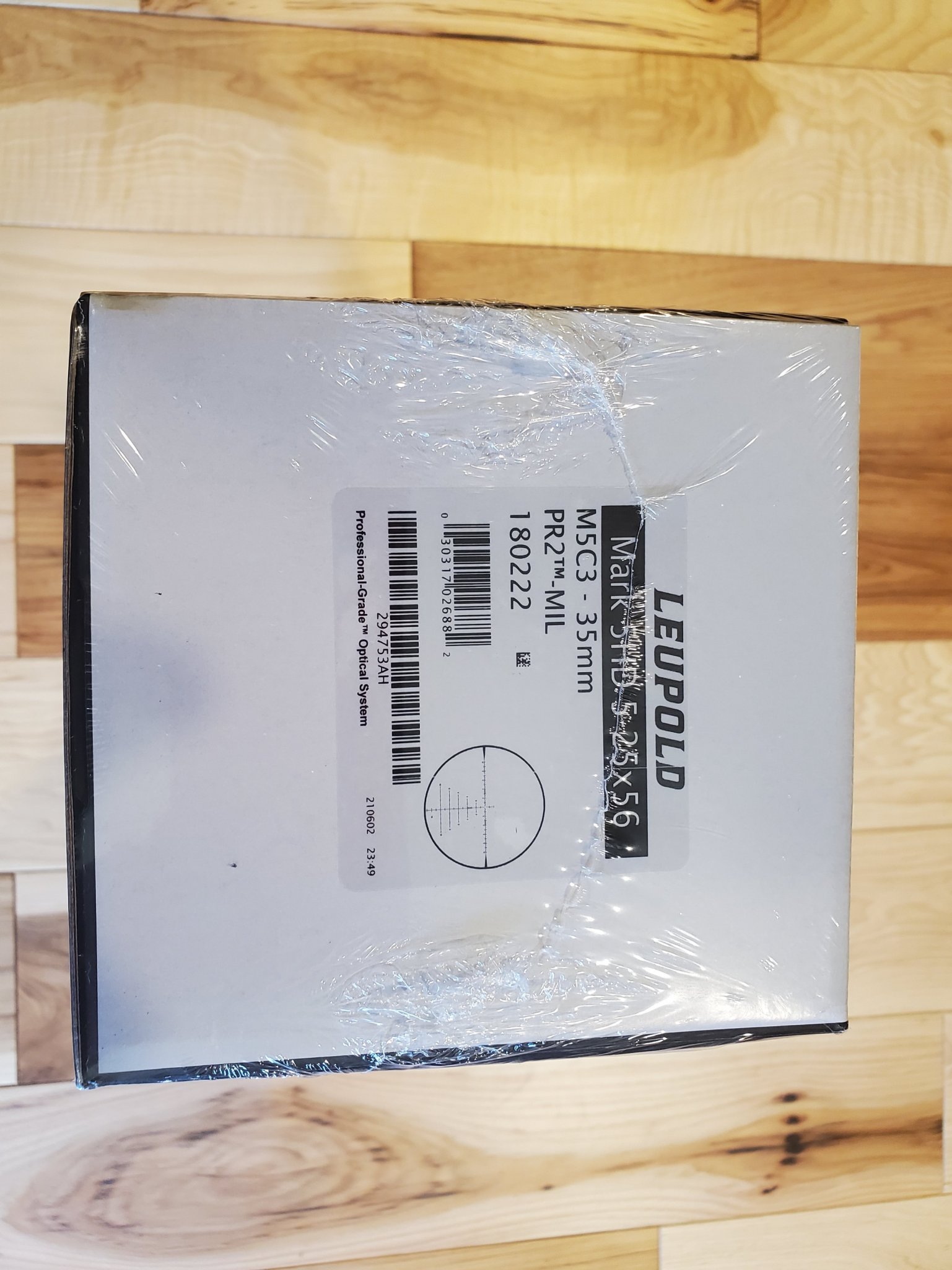

    To be fair, the second box he received was indeed opened, no plastic blister pack so either they repaired or gave him a used scope in return. I know when my MK5 had issues, it took Leupold forever to come to a conclusion and they did not like the idea of sending me a new optic as replacement, even though this optic was defective straight out of the box. It took alot of persuasion to get a new optic so that I could just sell it and move on.
    The second box I received wasn't opened. They both were shrink-wrapped sealed. The problem is there's evidence the first one had been repackaged (you can easily re-shrink wrap a box... the back room of any OfficeMax has a shrink wrap machine). The first one had SO MUCH dust on the scope including the lenses and smudges on a few places that were lazily wiped. The second one appeared unopened.
    So... the second one is on its way to Leupold now. I've asked the turret be trued up to the expectations I think I am allowed to have for a $2,200 flagship scope and the tracking to be validated because I now have zero faith in this scope and am out the money I paid for it now for over a month now with nothing to show for it except a 35 min wait in a Post Office line. Hopefully they get me squared away!

    slacken off the lock screws and take the slack up then tighten , there should be about 1/4 MM slop when the lock screws are slackened off .
    Tried that because my Nikon Black FX1000s need you to do that to get the turret just right. It had zero effect. The turret tick marks are almost exactly in-line until about 6 through 9 mill, ends up totally off, then returns back as you pass 9 and head back toward 0 again. The turret or the mechanism is bad. It's also so sloppy compared to the Mark 5s I've had a chance to experience just yesterday that I cannot accept it as-is. I'm frustrated, to say the least.
