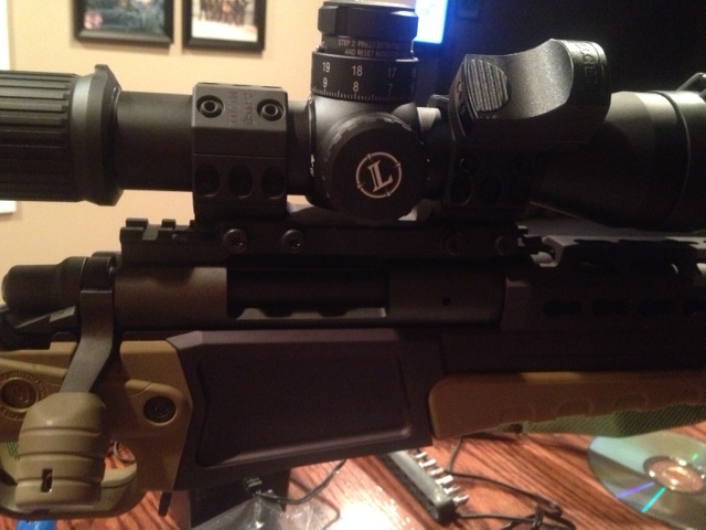

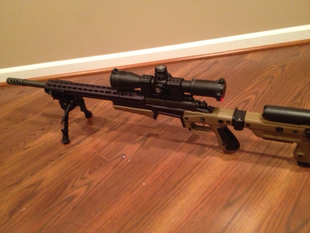

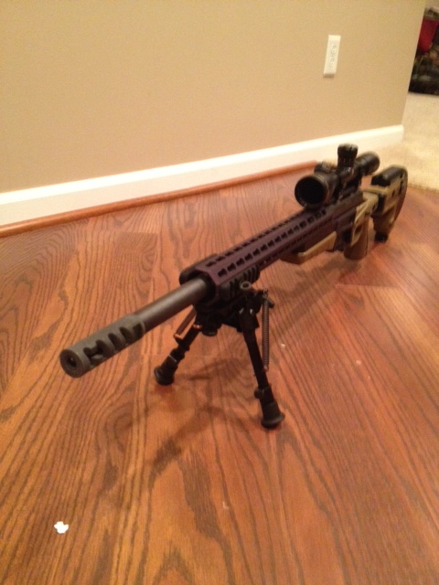

The windage is right also. Should be around 13.8 mils. Can you post a pic of your setup? I don't think it is your scope but is an issue with the base and or rings.
Here you go... A couple of the set up with a close up on the mount and then the scope and rail data...
