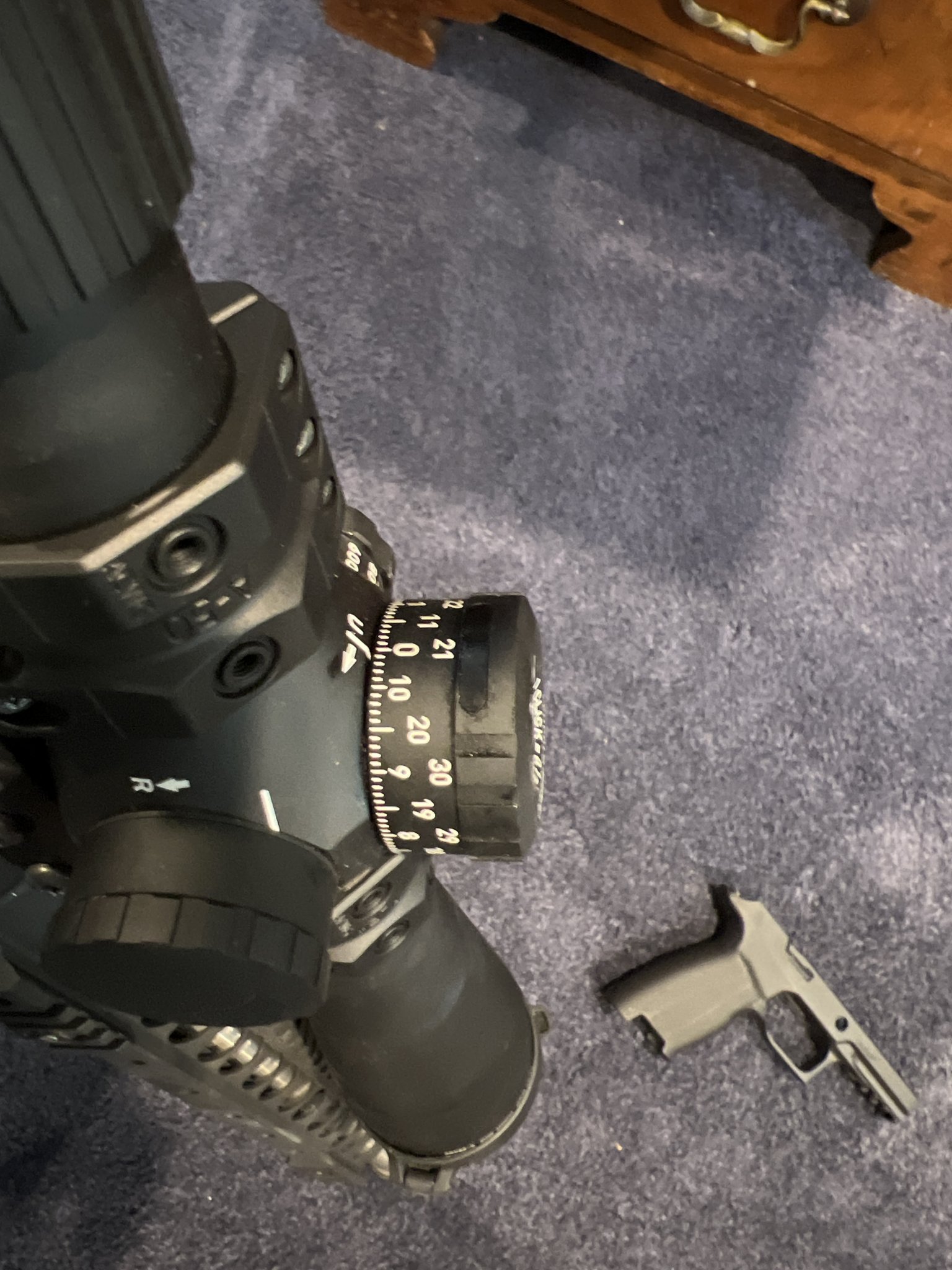

Yes. Running a sphur 20mm base which puts it 2.5inches height over bite. I didn’t notice any screws when I removed the turret to zero, just remembered it was covered in grease. Let me snap a picture
Here is a pic with the turret off

If you remove the turret you can dial the travel all the way down, and then reattach your turret to get full travel, however depending on where it zero's for you you may end up not having 3 revs of travel from your zero spot. (you likely won't)

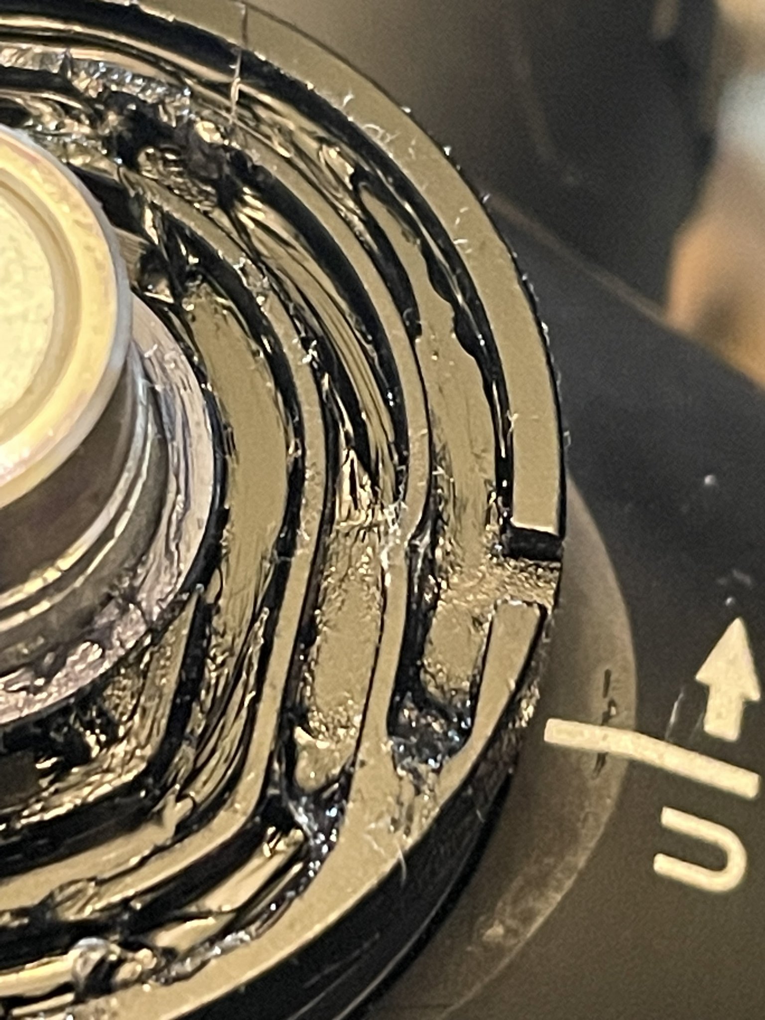

Or, if you bought a used one like I did and someone hamhandedly smacked that turret release button on the front of the dial (and didn't tell you about it prior to sale) it can dent the track that the pin travels in, inside the turret, and only allow a single rotation. (Unlikely if you got a new scope, and Leupold took care of the issue mine had.)
I added the pic of what mine looked like before Leupold fixed it.
