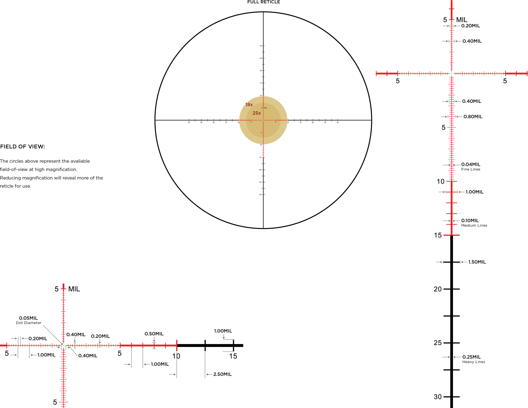

    I think the 6-24 is pretty spot on for NRL22/PRS Rimfire. I run mine at 14x most of the time, but it's nice to use 24x when ammo testing. I think you could be quite happy with the 4.5-18 though. That's plenty of magnification for both NRL and PRS. The built-in Electronic reticle level system* @David Lott mentioned is available on the 4.5-18, but only for the PR1 reticle (the PR2 is the Christmas tree).
    PR1 vs PR2
    *The Electronic Reticle will flash when the scope isn't level, promoting more accurate long-range shots. It can also simplify the mounting process.
    PR1 vs PR2
    View attachment 8481271View attachment 8481272
