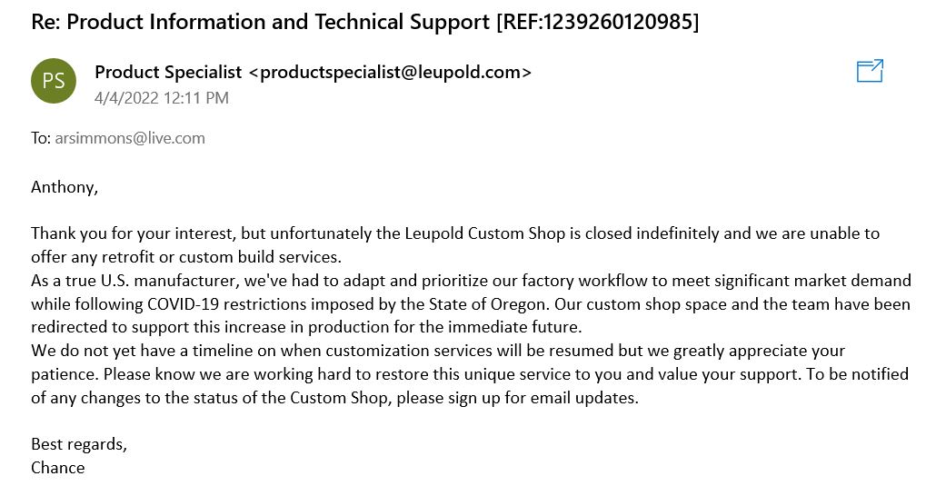

    I think you can only get an mrad reticle in the mark 4. I emailed Leupold yesterday about having a reticle installed in my GR and they said their "custom shop" is closed and will not be operating for the foreseeable future.

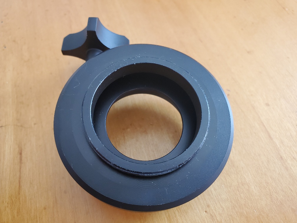

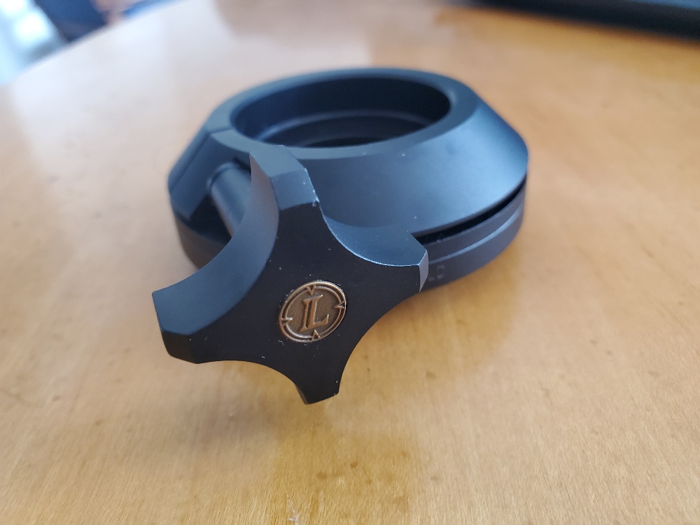

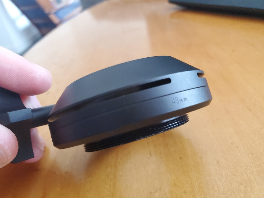

    Anyone know how the Leupold Digiscoping adapter attaches? This came with a used GR 60 I bought and can't figure out how it attaches.
