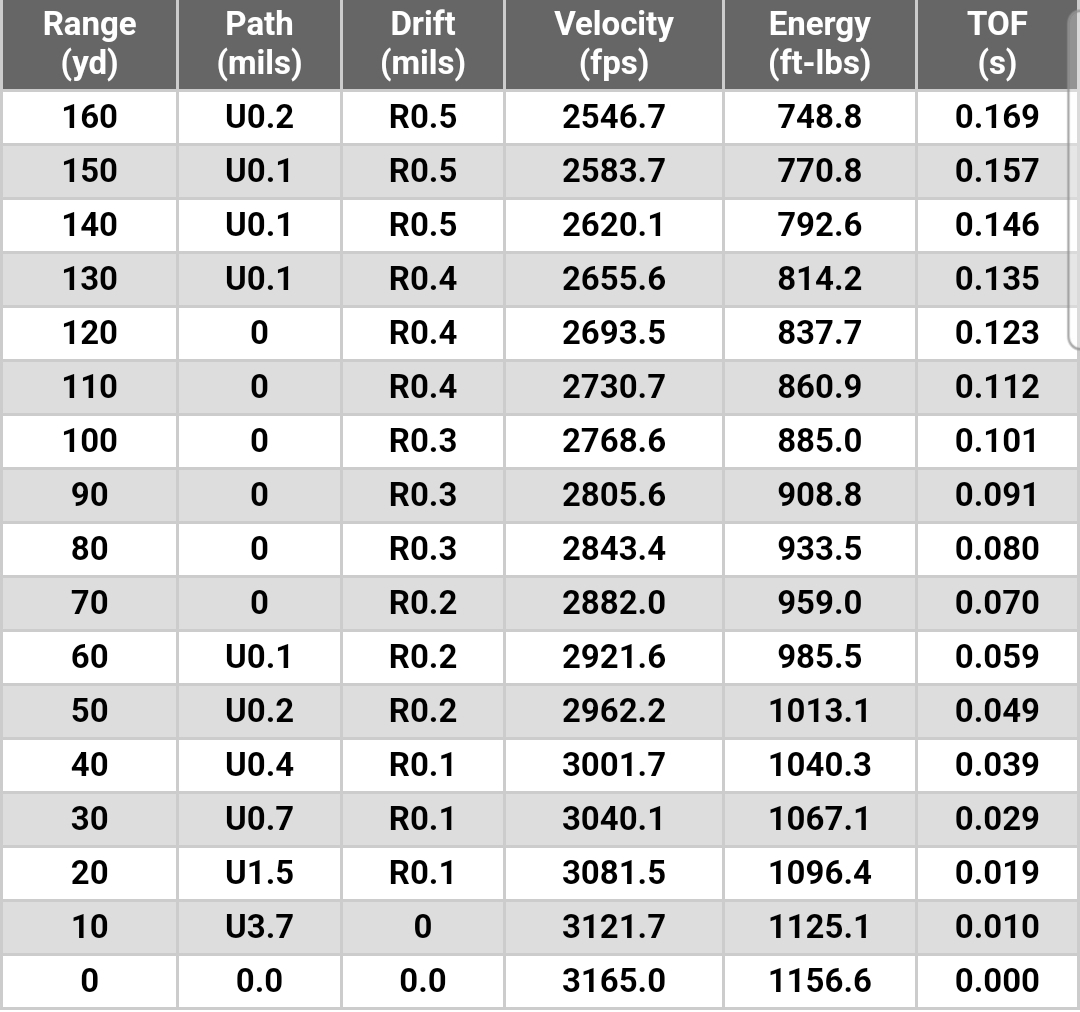

.223 doesn't drop hardly at all at 160yds. My gas gun shows only 0.2 at 160yds or top of head hold max on a fox size skull. Taking a heart and lung shot.....basically aim dead on. Your stated use case requires little holding at all unless super windy. Close in, the size of the animal eats up most if not all of your holdover/holdunder.

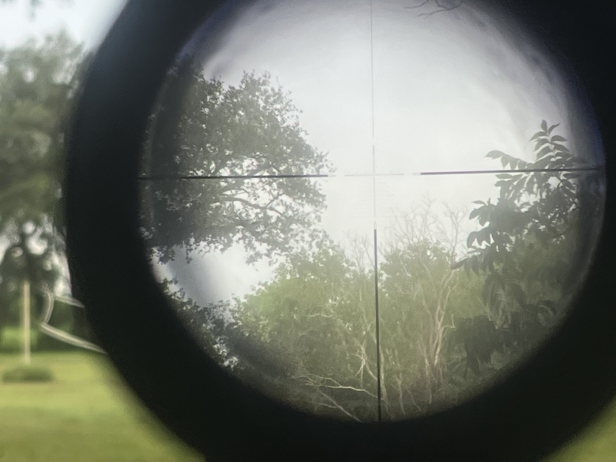

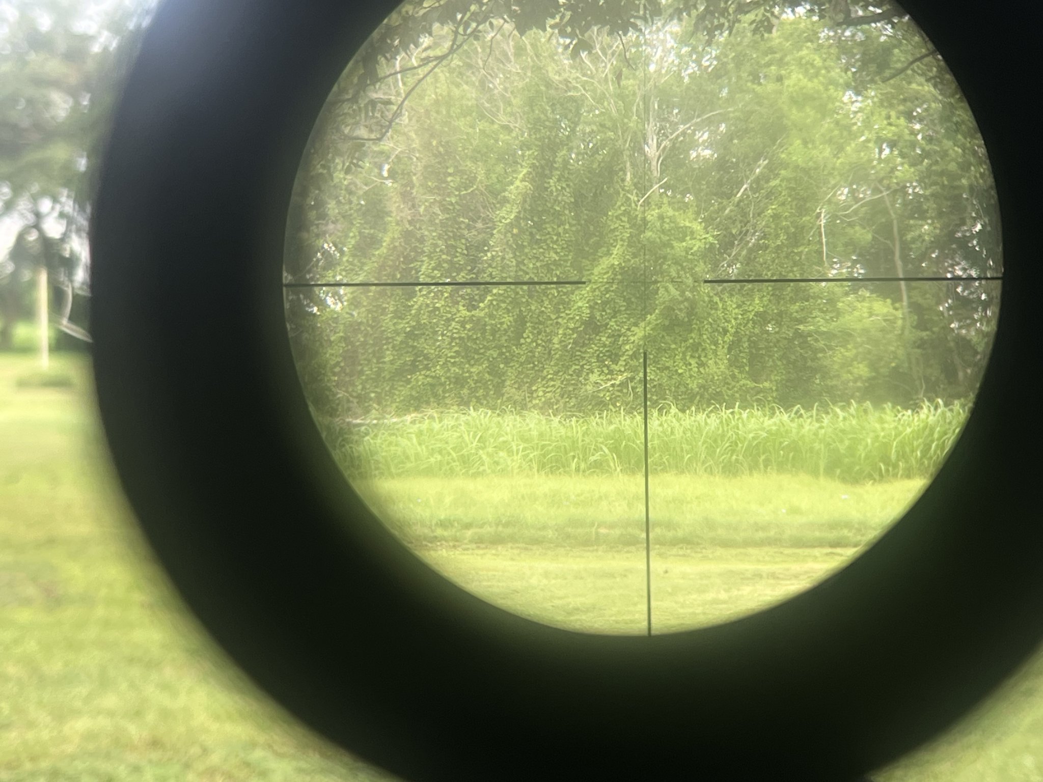

Stay away from FFP scopes for your use. Your concerns are warranted.
Here is a through scope shot using a 3-15-44 Vortex PST Gen 2. At 3x the reticle is just usable in good light and this is with the thick and very bold .06mil EBR-2D reticle this scope uses. Most FFP scopes are using much thinner .03mil thick reticles that are colored much lighter than what I posted. It’s the perfect recipe for a disappearing reticle.
3x with a bolder and thicker reticle than industry standard pointing at the sky. (Scope lenses were fogged over from condensation)
Same reticle pointing across open land to a tree line 125yds away. Remember most reticles will be much lighter and thinner than this example.

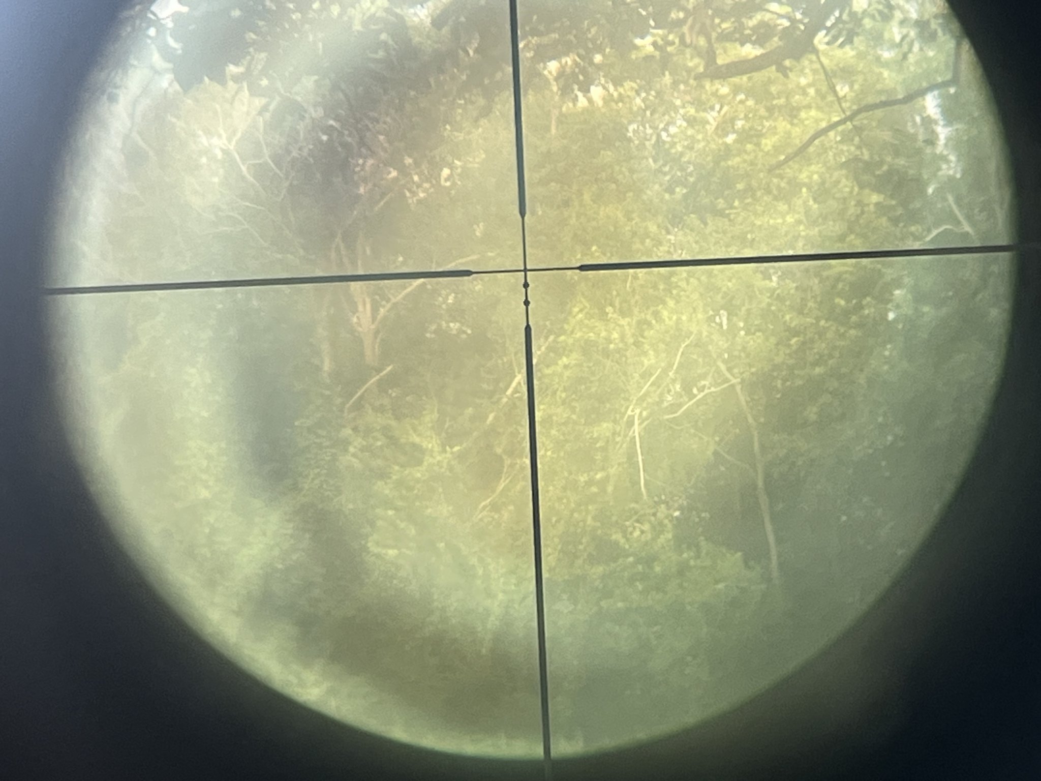

@Ac-13 is concerned with reticle visibility and FFP scopes are handicapped here at low power. This isn’t subjective.
Only a dishonest man would argue that this:
Is better than this for close up low light shooting. It’s not even close.
