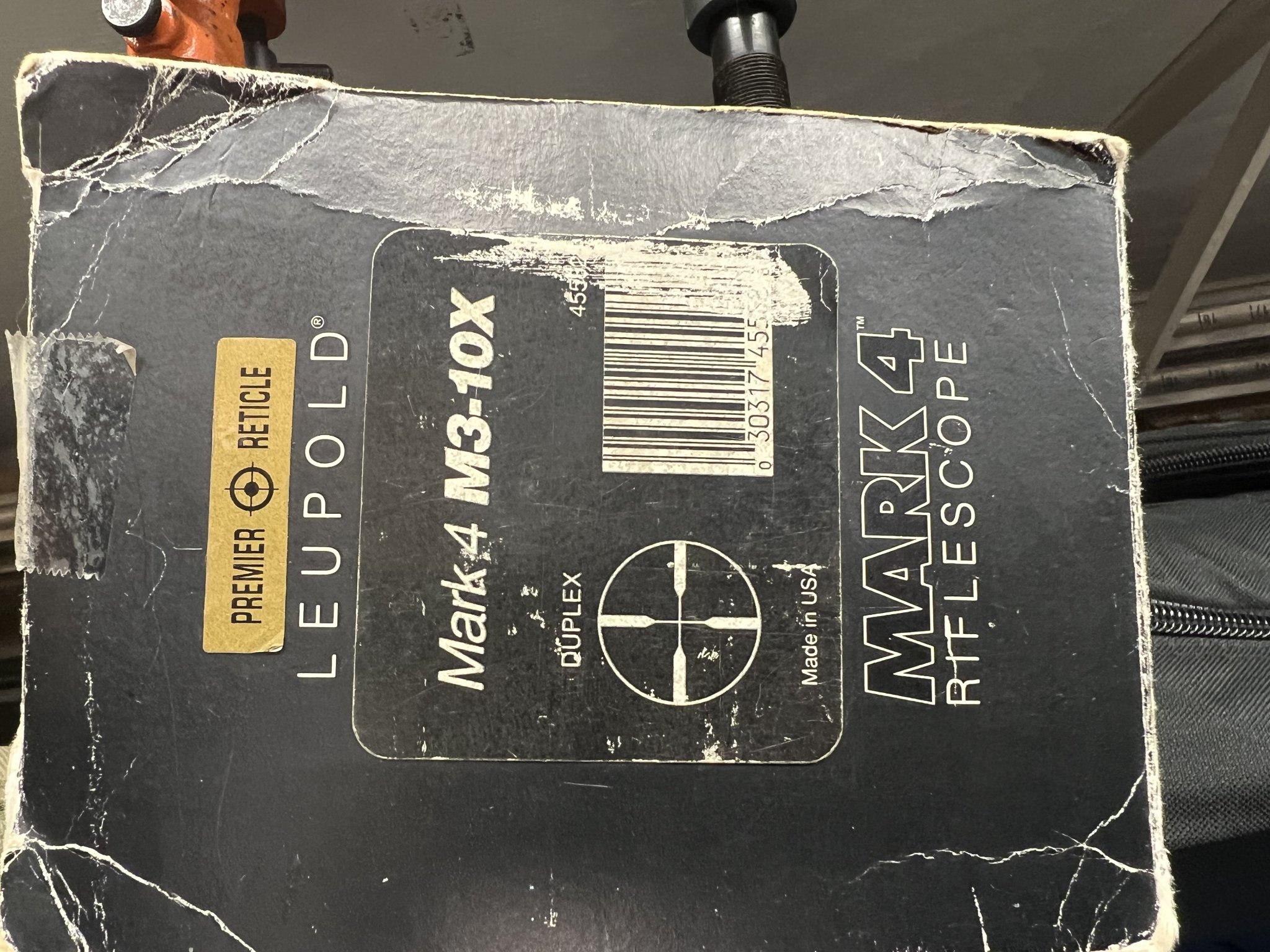

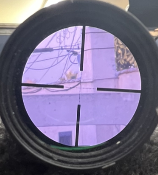

Does anyone know if Premier still exists? I have an older Mark 4 10X and would like to see if they have any information on it by serial number. The box it came in has their sticker above the Leupold label. It’s now a mildot that looks like footballs. Also, the spare elevation dials are counter clockwise but it seems to operate clockwise up now.
Sorry for the off-color picture, but it had the laser filter on it.
Any contact information would be appreciated. Thanks

Premier Reticles went bankrupt around 2013 IIRC. They do not exist anymore and I am not aware of anyone who would know much unless someone here has that exact scope. Premiers early business was replacing Leupold’s sucky reticles with something more useful. Chris Thomas (whose father founded Premier) is still around and working for an obscure defense contractor I believe but largely uninvolved with the optics world anymore.
Thanks for the information. Seems like kind of a dead end but ya never know. The scope kind of stands on its own, but always nice to dig anything else up. Going on an XM-25 clone that’s been quite a project so far.

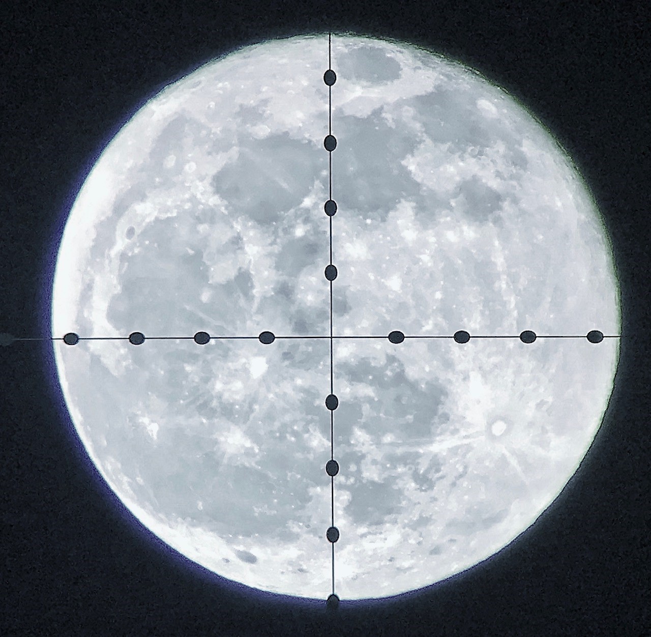

I have a golden ring spotter they did with the FFP football mil dot reticle. I never was able to find exact data for the actual size of the football mils and spacing. I assumed 1 mil spacing from the center of the dot to center of next dot and .75 spacing between the ends. I bought the spotter new in case but there was nothing inside with the paperwork. Just a sticker on the outside saying Premier reticle installed or something like that.
