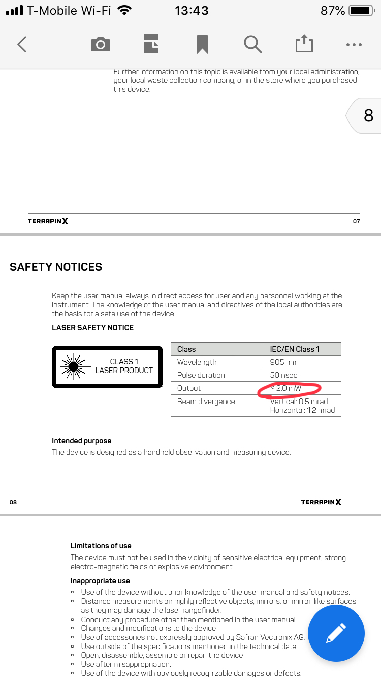

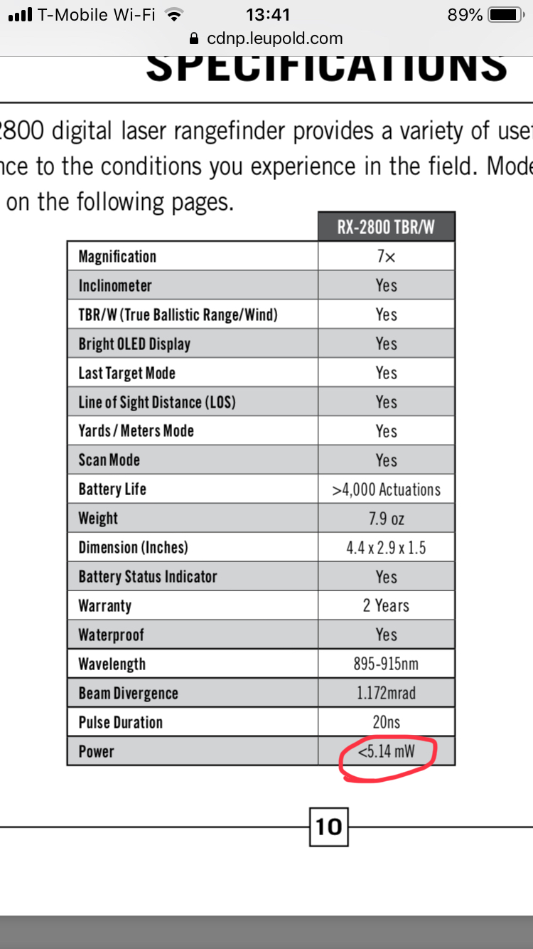

    From the Rx2800 & Terrapin-x owners manual. I’m not well versed on lasers enough to say which is better even though I use class 4 lasers that can burn your eye out at 11nm away. It seems the RX2800 has more wattage than the terrapin-x.
    5.14mW vs 2mW

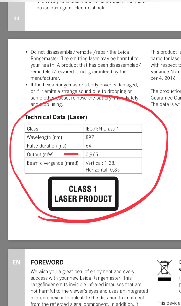

    It’s true you want a tight beam divergence especially if the laser is under powered, but the RX2800 seems to be powered beyond what I’ve seen in a handheld laser. So it’s fine for its divergence to be a little sloppy. The Leica 2700B isn’t even 1mW and it supposedly does pretty wel.

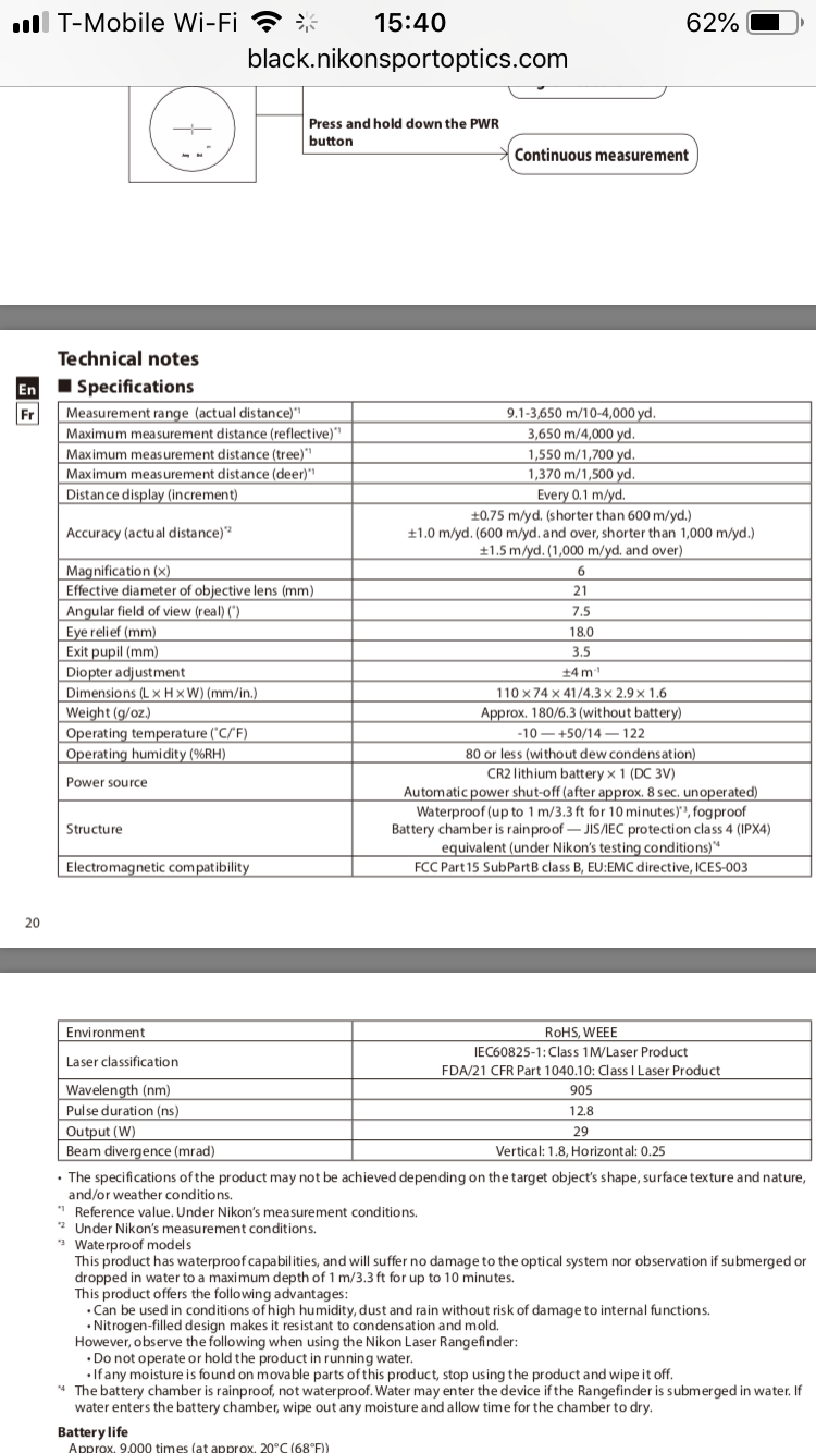

    Black 4K says 0.25x1.8 beam divergence.
    Also say 29W but that can’t be correct. So many reasons that’s wrong but it wouldn’t be a class1 laser pumping out 29W off those little batteries.
    Reactions: darth_ritis
