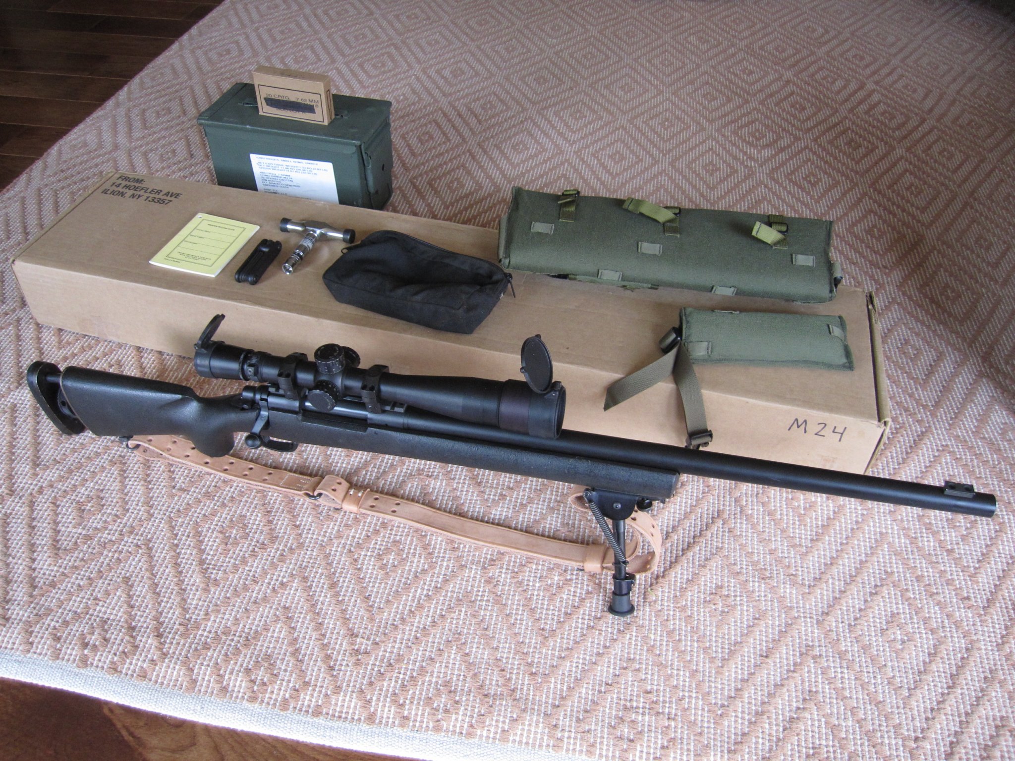

Like the title says, were the Leupold Vari-X III 3.5-10x 40mm Tactical scopes ever used on M24 military rifles? I assume these are strictly commercial scopes but I was told by a Special Forces sniper of 19 years that these scopes were supplied by Leupold to replace the fixed 10x scopes sometime around 2004. He told me that this scope was "correct" for the M24 but I have my doubts and can't find any evidence to support that claim. I've never seen any M24 rifles with anything but a fixed 10x scope.
My first USGI "modern" sniper rifle:

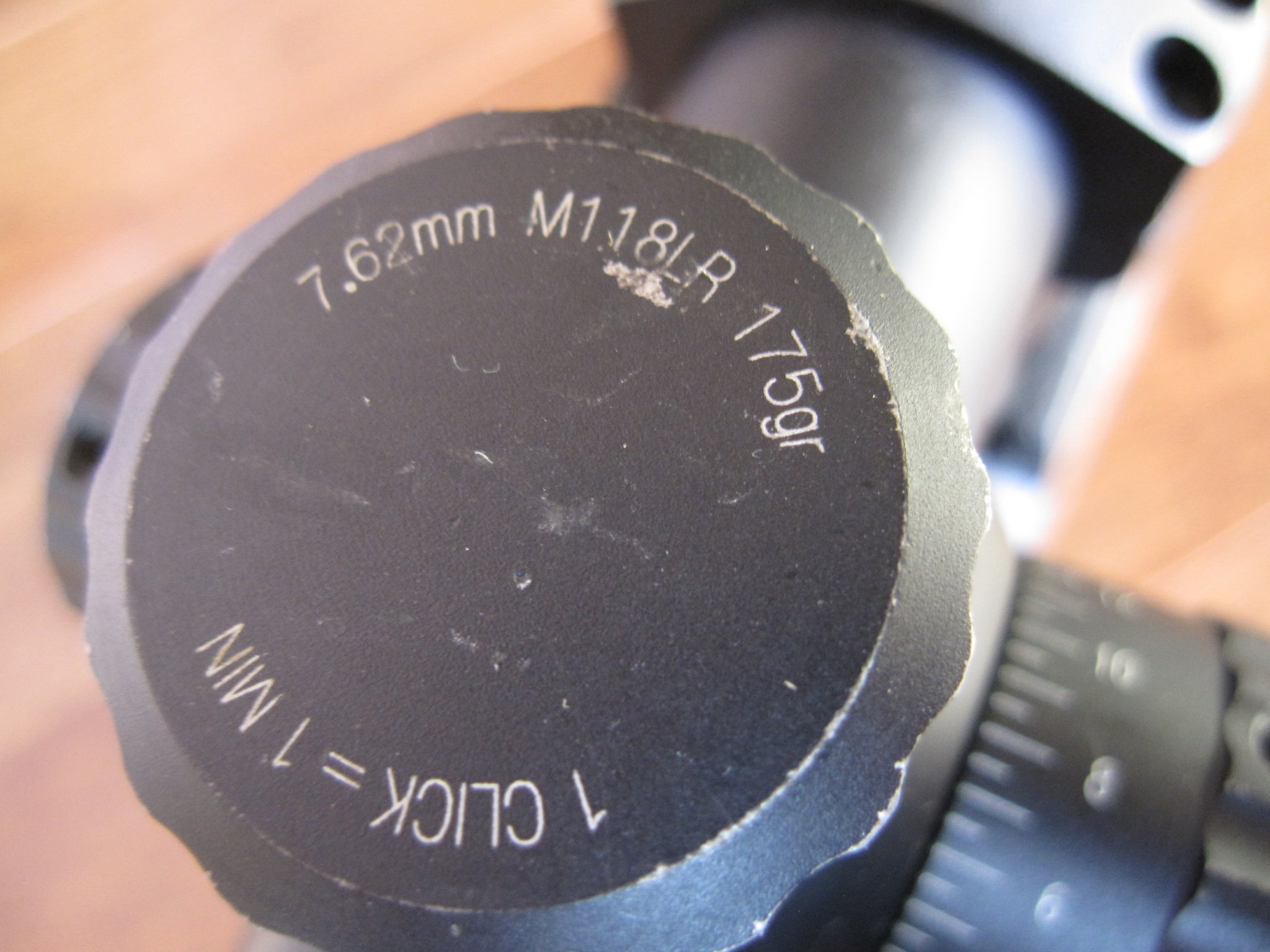

Interesting details, gentlemen! Thank you very much. The turrets on this one are 1 click = 1 min.
They seem a bit coarse for such a precision rifle.

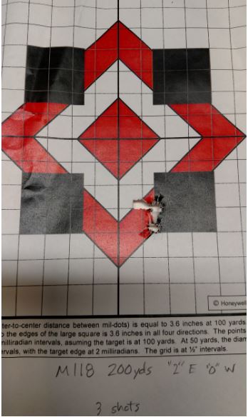

I'm very pleased with this rifle so far. I took it out to the range yesterday and tried some of my reloads against the M118 LR. I want to find something a little less expensive and easier to obtain than the M118 LR ammo. The scope works quite well going back and forth from 200 to 300 yds. My groups were consistently less than 1 MOA with the M118LR and even with my reloads, except for the last 3 rounds I shot. Not sure what I did on those but I did notice that I was having trouble with the reticle moving side to side on the target from my heartbeat. It might have had something to do with hurrying down and back from the 300 yd targets carrying this heavy beast. Need to work on that.
I usually try to do 5 round groups but I only had 3 rounds of the M118 LR and 3 rounds of my reloads left at the end of the day and two fresh targets at 200 yds. I can't see the holes very well on these targets through the scope but was very surprised and happy with the M118 LR when I saw the target up close.
Best group of the day! Wonder what 5 rounds would look like though.

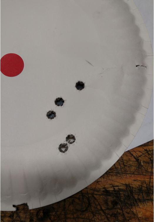

I shot these 3 rounds immediately after the 3 M118 LR above. Yikes! Not sure what happened as these rounds were performing just as well as the M118 LR at the 300 yd distance.

The M3LR is a fine scope for its intended purpose -- quickly hitting a man-sized target (the Army E-type silhouette) to the doctrinal 800-Meter range of a 7.62mm sniper rifle. You might improve your grouping if you use a solid fore-and-aft sandbag arrangement to isolate your pulse.
M118LR runs hot-and-cold. USSOCOM would not have specified Mark 316 Mod 0 175-grain (Federal Gold Medal Match) if M118LR quality hadn't declined so badly.
Thanks for the advice. I was shooting from a bench off the bipod. I did try holding a small rear bag with my left hand directly in front of the trigger guard which seemed to help but I was still seeing my pulse. Need to work on my breathing and probably my fitness!! :)
