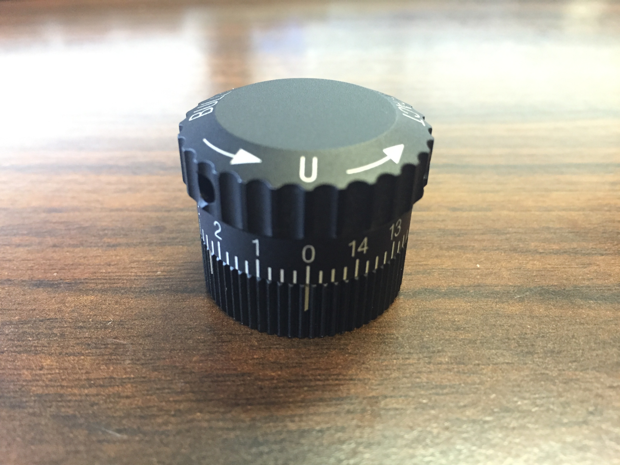

A lot of the old screw on dials pics are probably mine from my 4.5-14x550 vx3.
When I got mine it was 50 bucks for each turret and they were shipped to my door in a week.
They offered two versions:
1- was a zero stop model that is (sort of) limited to one revolution (14moa)
2- was a non zero stop model that allowed for multiple revolutions.
(I have both models but only internal pics of the non zero stop model, only difference being a tiny zero stop bearing pressed into the top cover recess)

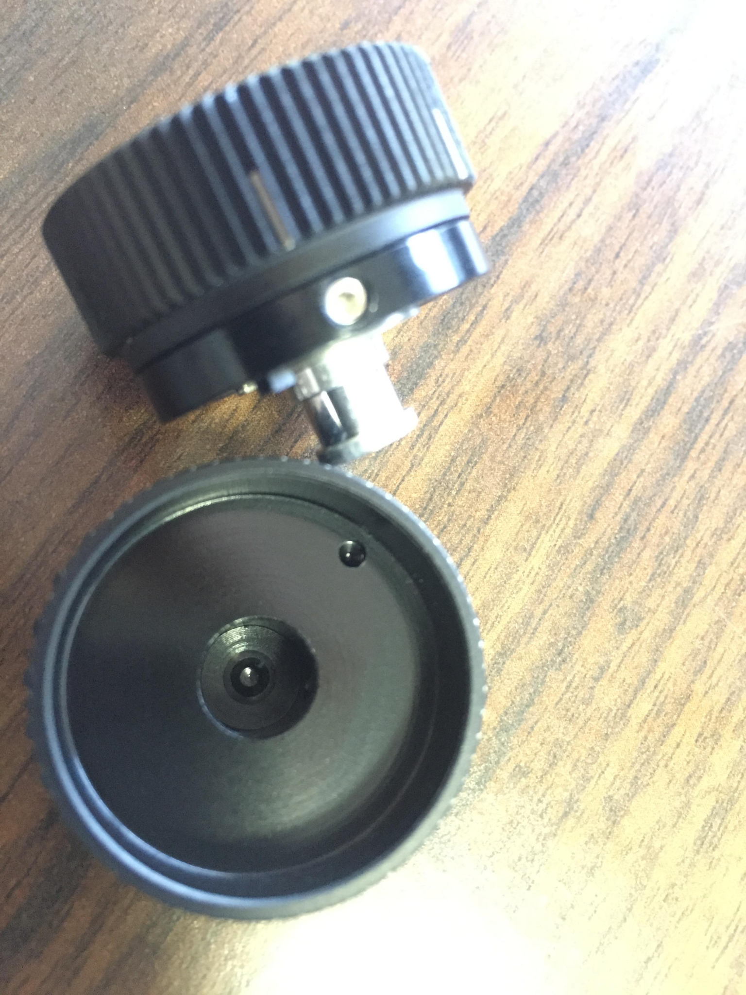

Assembled turret off the scope- it has 6 white dashes all around the ridged bottom- that allows you to vary the amount of tightening in order to to get it to line up. You have a small foam squeezy thing on your scope already that the cap presses agasint to weather seal it. This still presses against that seal but the seal is squishy enough for you to get the line lined up properly for you while still keeping it sealed up.
7098498

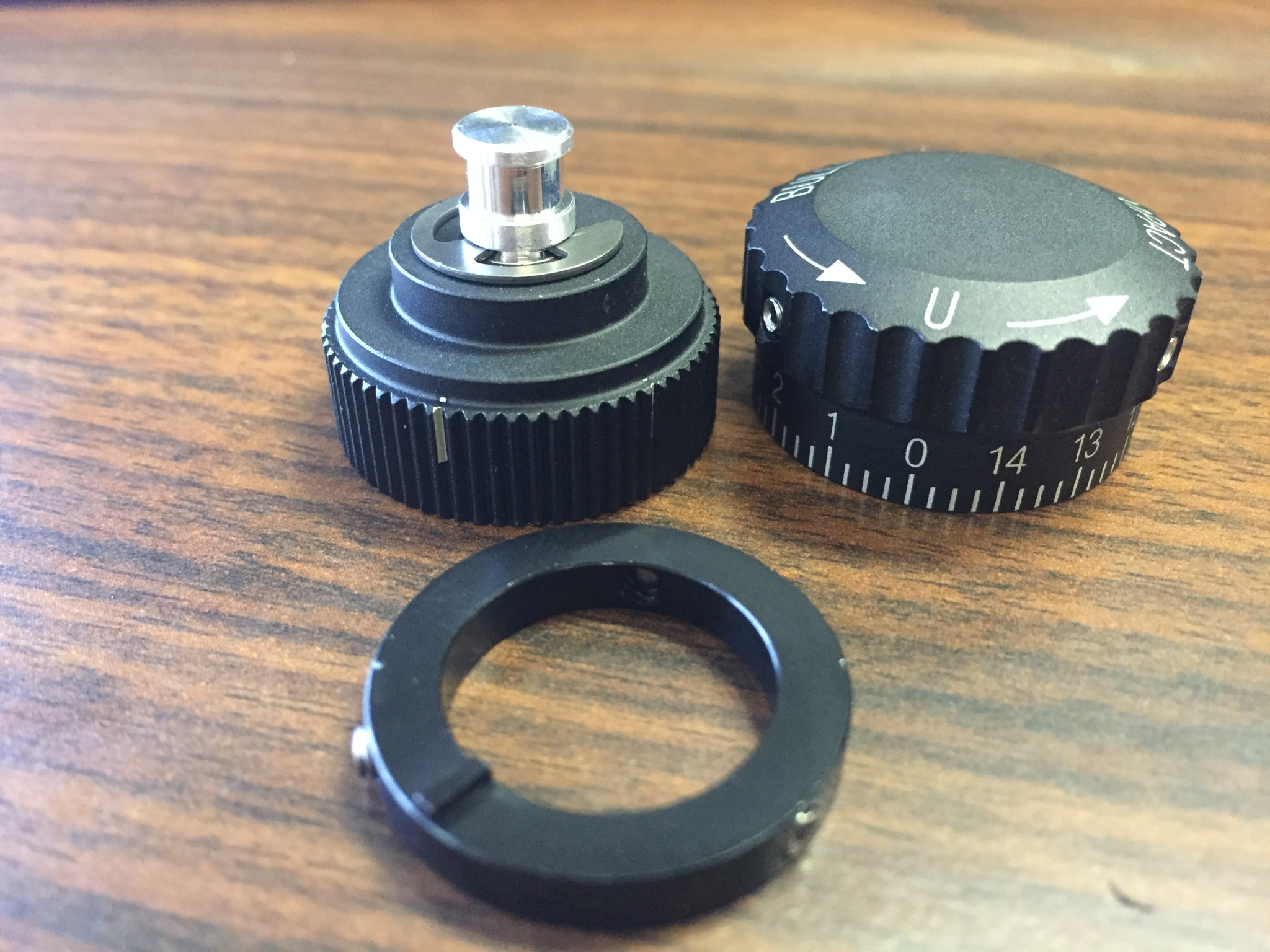

In the three pieces-
The top left is what actually screws down onto the scope, that silver rod has a raised ridge in the other covered up end that slips into the flat on the scopes actual adjustment
The bottom is the zero stop ring, it slides down over the first piece, notice the raised bump, thats the stop but it also serves as a block for a second revolution.
The top right is the cap that goes over the before two pieces, the zero stop verison has a ball bearing presed into it that hangs down to touch the zero stop rings bump, the non stop version is just missing that bearing.

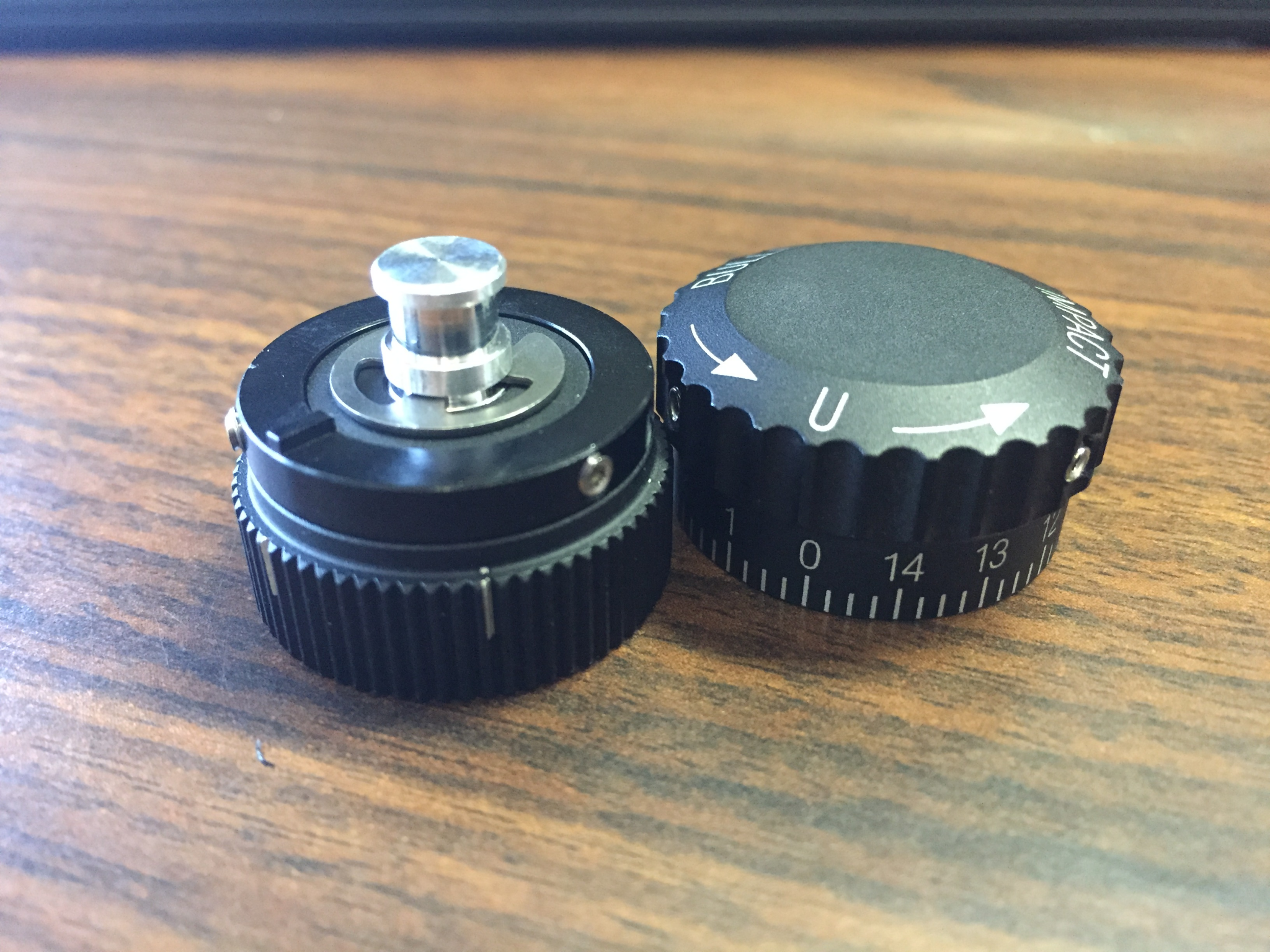

7098499
The zero stop ring installed on the base.
7098500
This is the bottom of the top cap, you can see the recess, that is where the bearing for the zero stop goes.

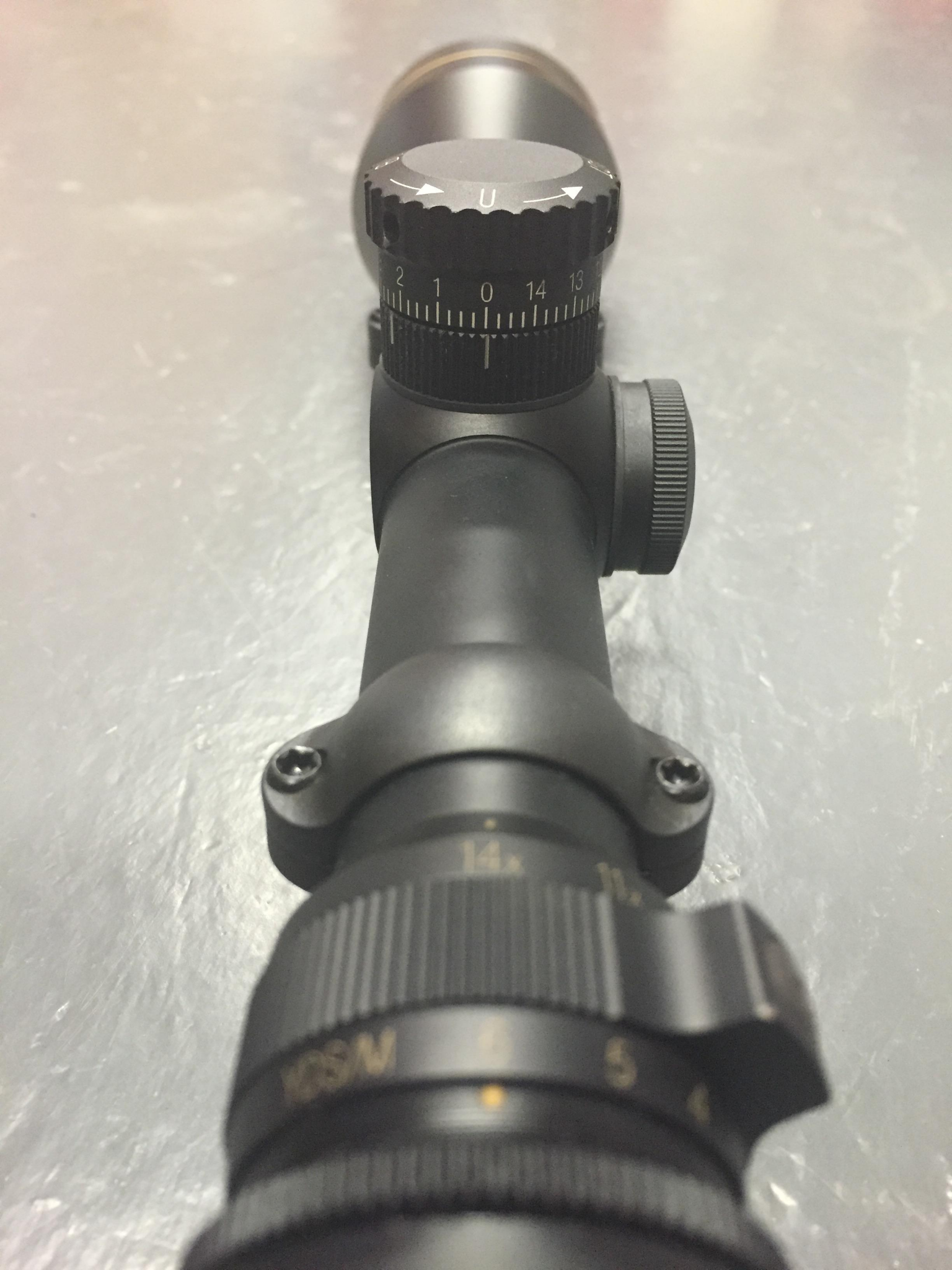

7098501
Installed on the scope. Notice that there is a slight gap between the bottom piece and the top cover piece. There is a bit of play between the top cap and the bottom bases silver spline. If I were to install it all the way down it would be limited to one revolution via zero stop catching the tops bump bearing. But because there is a bit of play on the siler spline I just lifted it up a tad before tightening down and now I hit and feel the zero stop but if I keep turning it the ball bearing runs over it to let me have access to a second revolution. You have to keep track of where you dialed like this since it has no rev marks and you hit the zero stop on the way down from the second revolution as well but it does let me dial more than the 14 moa I would otherwise be limited to. So maybe when installed high its more accurately described as more of a MTzC (More Tactile zero Click) turret than proper zero stop.
7098502
