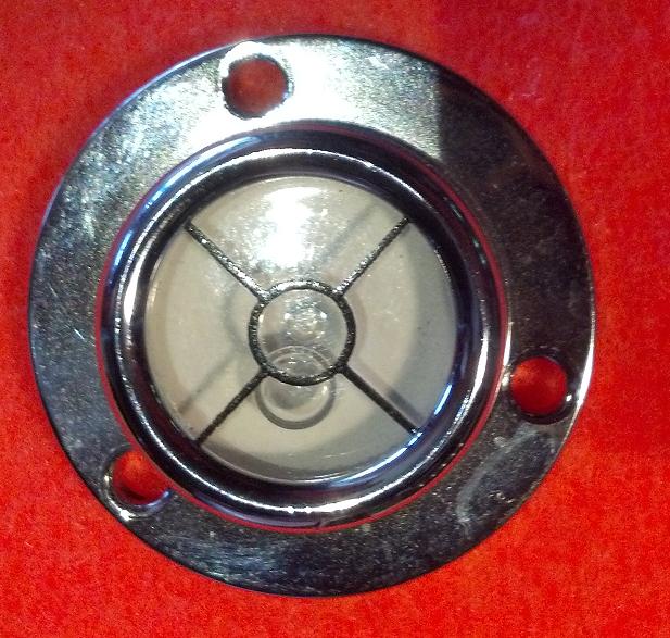

In my experience in fabrication and machine shops,
1) most levels are questionable in accuracy
2) most people can't read a level very well
3) when you drop a level that you knew was true, you have to re-verify it
4) keep your true levels and treat them well
I picked up the level pictured below off a discarded Test & Measurement microscope. It's a machined surface on the bottom, very easy to read because it has three circles (internal point, black ring and bubble) which will line up concentrically when you have it dead nutz.
I put it on my rail, level everything from there, then align the vertical reticle to a plumb line at 25 yards.
