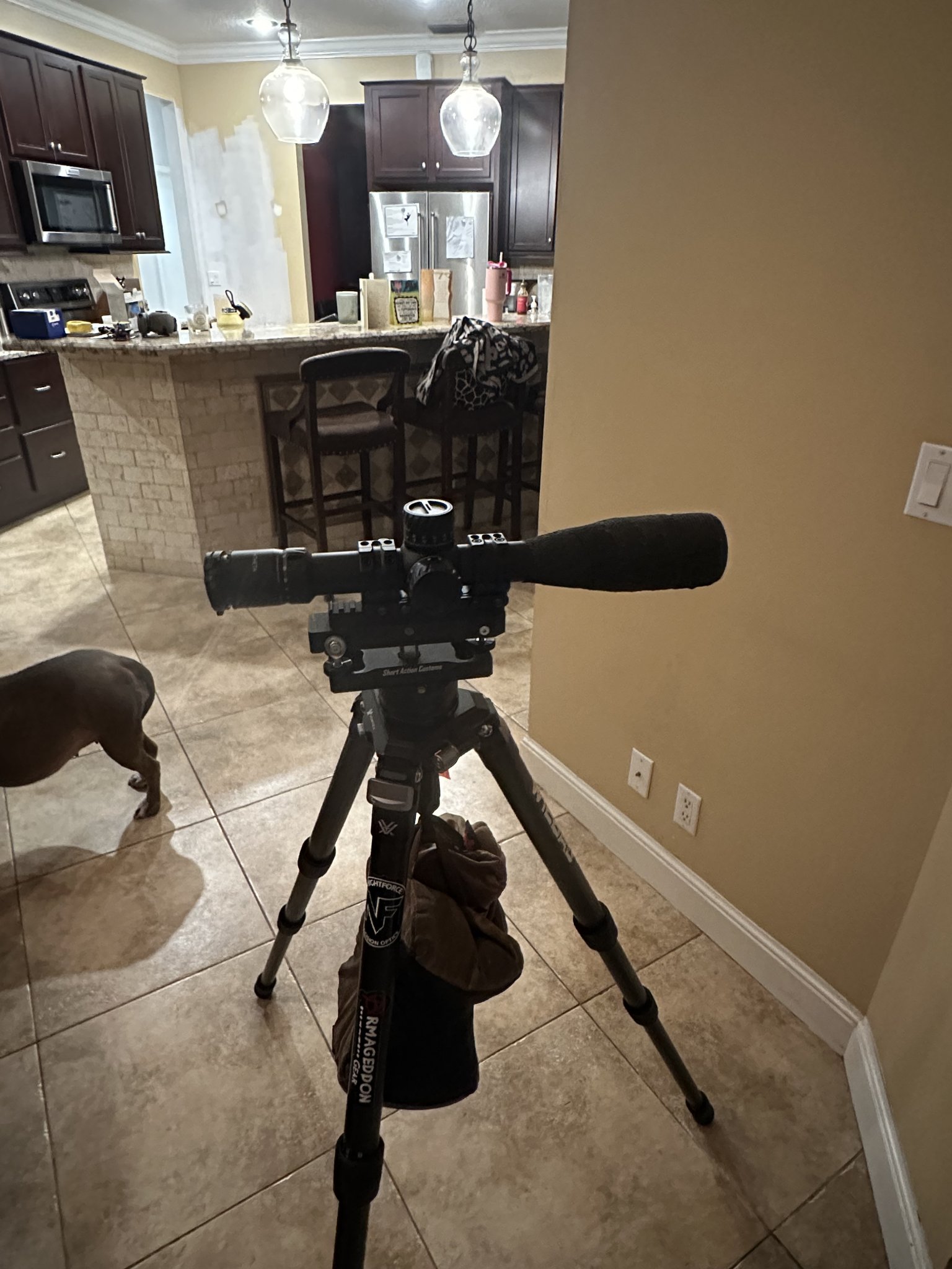

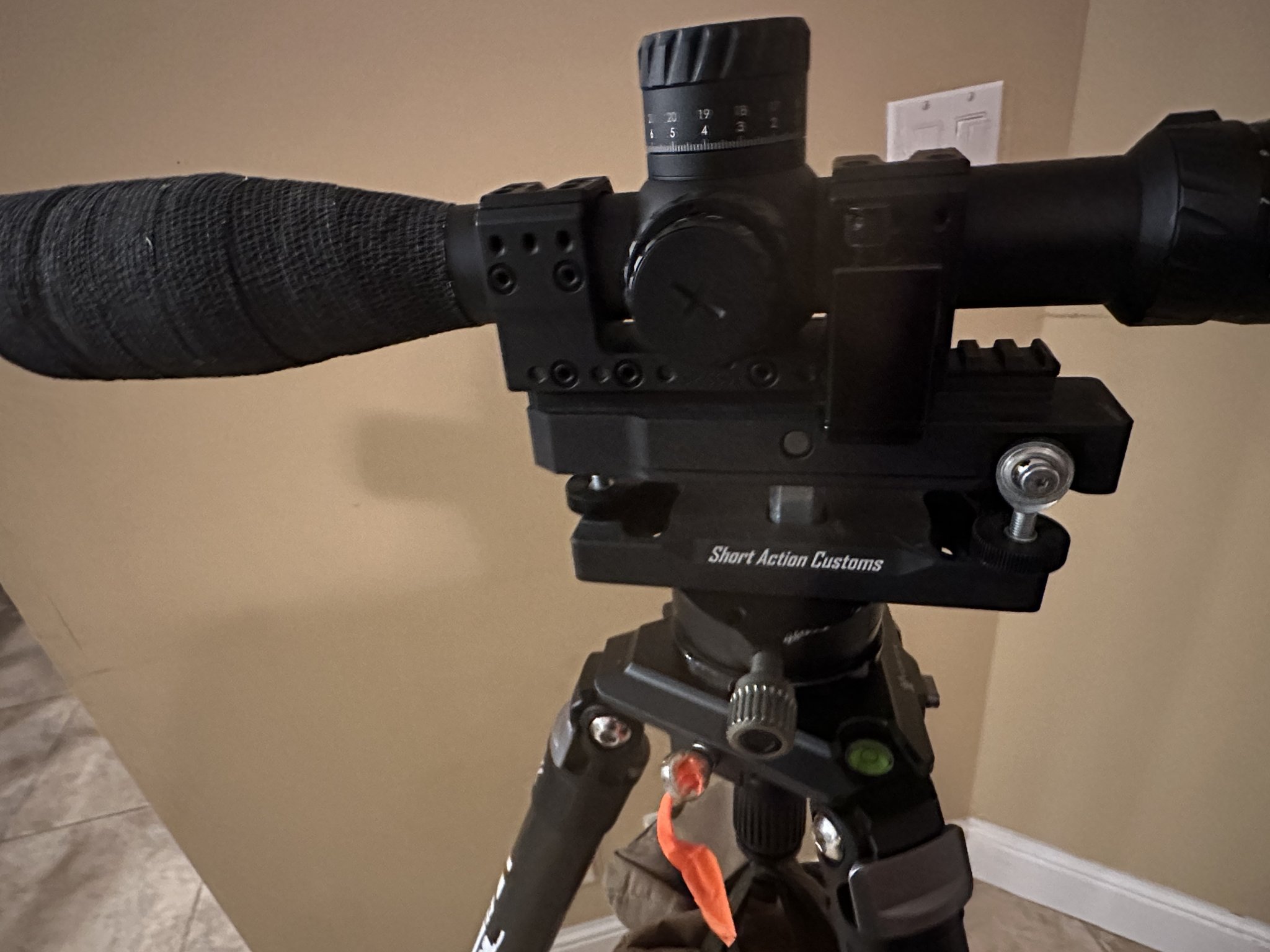

Can I see a picture of how you have the scope level setup? Also try putting the plumb bob closer. No need for it to be 50 yards away
I took everything down for the night, but I will send you a picture of how I have it set up. I think the reason I had it set at 50 yards is because I sit on my patio in the shade and I put my plumbob hanging off my Archery target out my yard. But I’ll just put both of them in the patio.
Reactions: simonp
I did checked the diopter and parallax
The scope base is leveled from front to back and side to side

What did you put the level on when leveling the scope?
I think it would be more important to have the reticle level, as long as the reticle stays on the line when you dial the turrets. If it tracks weird, the reticle is off from the turret. I know it's like comparing apples to raisins, but my Razor HD LHT is off a couple degrees when the turret is level (turret cap removed). I lined the reticle up with a plumb bob and dialed the scope as far as it would go both ways to make sure it tracked true and it did, so I ignored that the turret wasn't truly level.
Reactions: oldrifleman

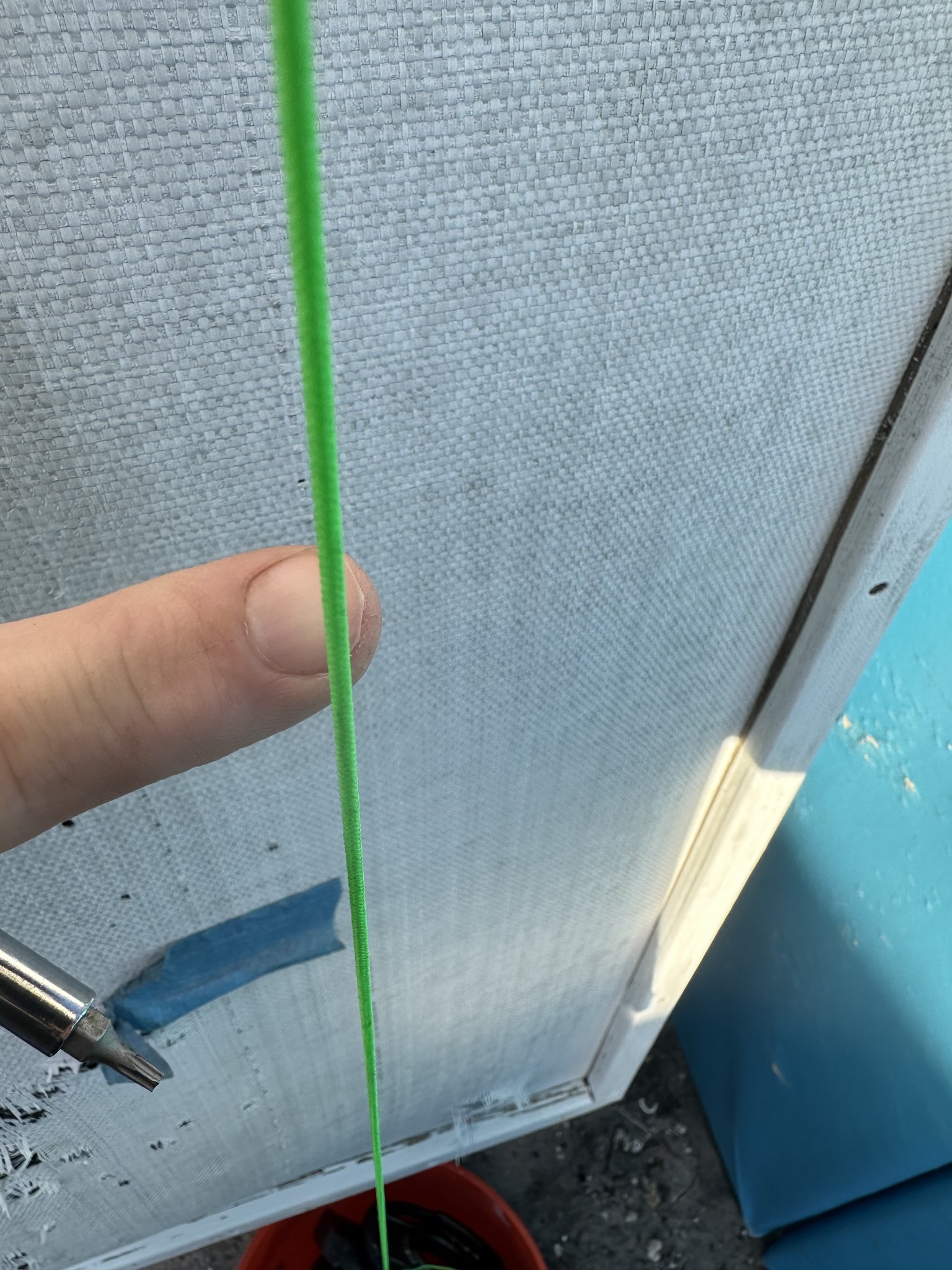

This is the line I use, it’s Archery D Loop material, it is a 16th of an inch thick. So I am running my radical parallel with the line and I’m gonna shoot it. When I start with it in the middle of the line I dial 28 mils up and it’s still touching the line.

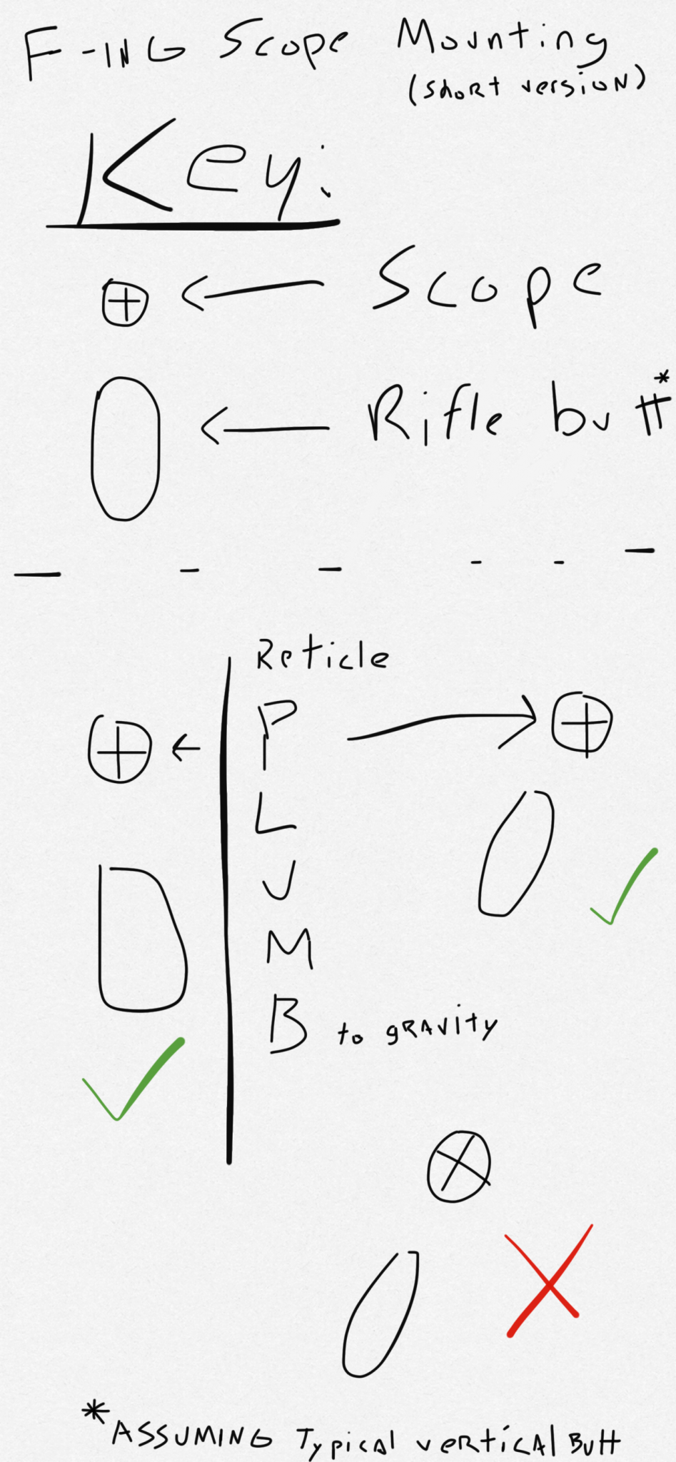

@Lowlight has written that unless the shooter already knows he cants his scope in the rings to compensate for how he shoulders the rifle, they level their student’s scope mounts, mount the scope, and then plumb the reticles to a known plumb object.
It doesn’t matter if your turret or scope base is level to whatever. All that matters is that the reticle is plumb to gravity.
Link to lowlight’s long version in post below:
Reactions: Taylorbok and WB300
