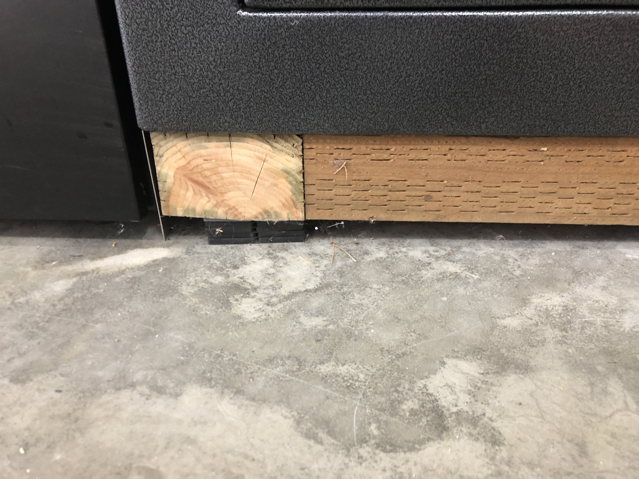

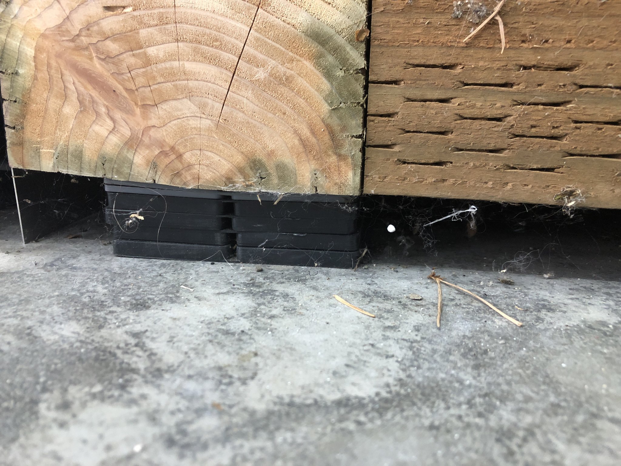

    You could build a 4x4 frame. Level the frame with construction shims, have the safe installed and have them drill through the frame to anchor. Nice to have the safe up that high. Worked really well for me.

    Mine frame is 4x6 but doesn’t really matter. Doesn’t need to be completely solid in the middle.
    My safe isn’t as large as yours but still around 1600lb and with the door open 90deg. it’s easy to tip it forward with one hand.
    When I had mine delivered the guy highly recommended to not let it set directly on the concrete slab and leave an air gap or the temp change would cause it to sweat and rust out the bottom and also cause the humidity inside the safe to be very high. Luckily my slab is pretty level and a 4x4 on each side is all I needed.
