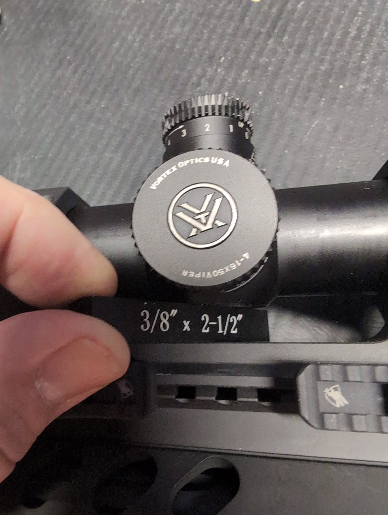

I use a parallel bar set and make sure the bottom of the scope is parallel to the mount.
Pick a bar or bars so that with a slight twist you have good contact up and down. An exact fit may get stuck when you tighten rings, so a little play is good.
This ensures that when the scope is held level, it is exactly above the bore so vertical and horizontal movements are true.
If you use a scope level I use a plumb line so the level shows level when the scope reticle matches the plumb line..
I have used the Arisaka style wedges, pin gauges and even an extra long feeler gauge set to level, then verify with a tripod and plump line.
Lately I just use the feeler gauges since I also use them to try to start the caps as evenly as possible. I installed a new scope last night and while most normally start at .032" gap, this one ended up at .020" to start.
Same here, feeler gauges between scope and rail or bottom of mount, then use them to set the gap on the caps. I don't think the gap on the caps matter much, if any at all, but it looks nicer. After I set the rifle on a tripod and confirm with a plumb line hanging on the other end of the garage, then bore sight by eye. Box test after initial sight in confirms it all.
