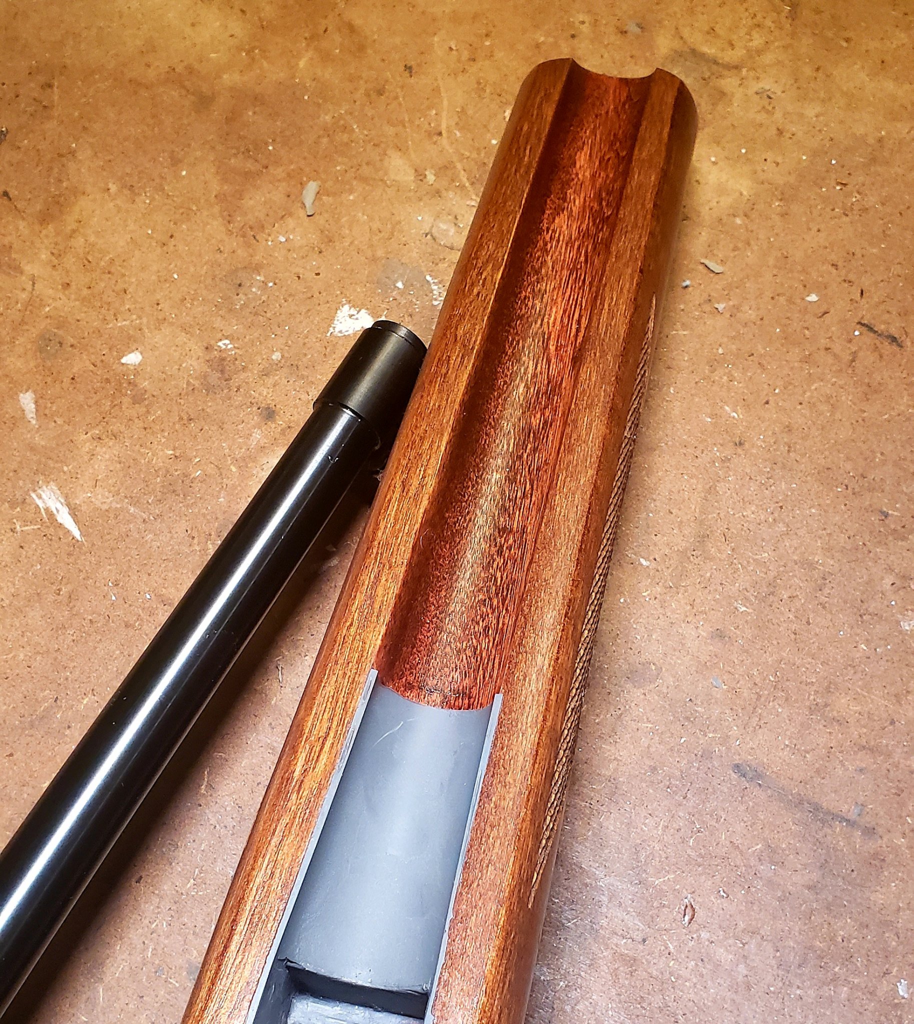

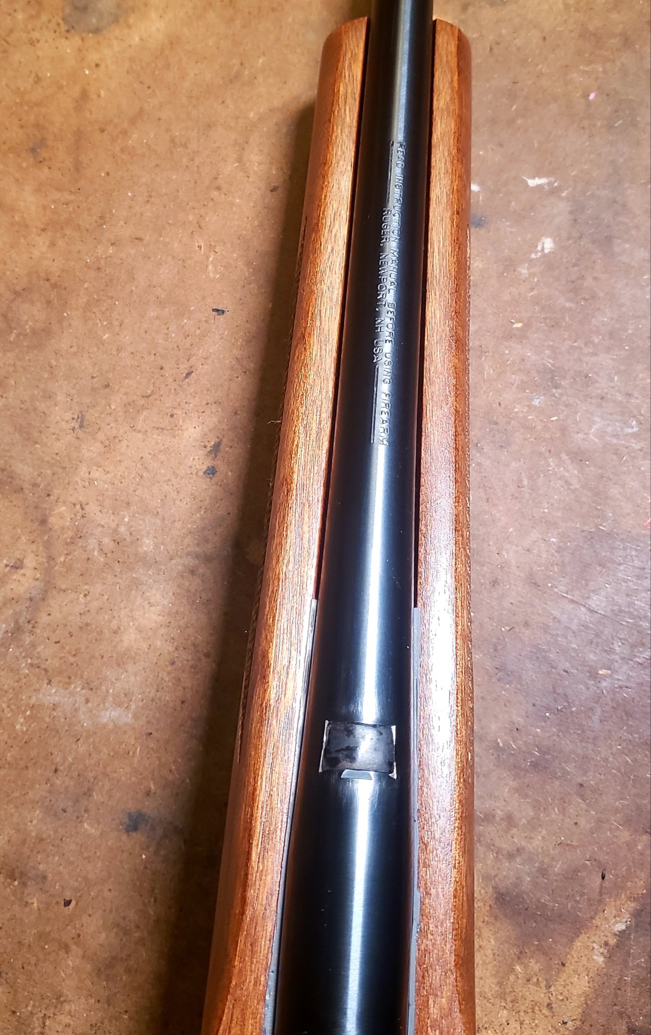

    Not satisfied with just dropping the barreled action into the stock I free floated the barrel and bedded the action. It fits like a glove, there's zero movement in the receiver if I try to flex the barrel at the end of the stock.
    It took a fair bit of sanding to get even reveals, leaving the barrel channel a bright blonde. A little stain and Tru Oil and you'd hardly know.

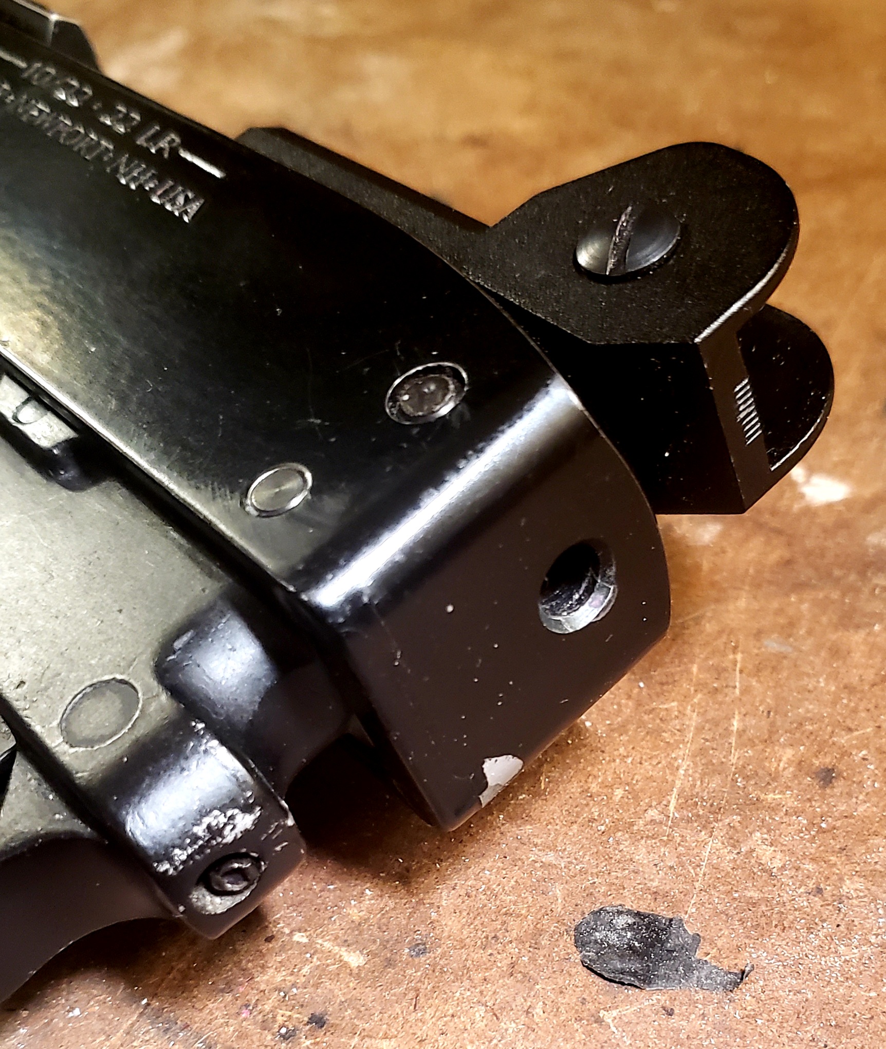

    To help with cleaning, I drilled a hole in the back of the receiver for a cleaning rod to pass thru to the barrel. It's centered from side to side and up from the bottom about .775".

    I have considered boring into the tail of the receiver as a cleaning aid. I prefer that all of the "things" going in the barrel all go the same direction...breach to muzzle.
    It's pretty easy to drill the hole, I did it with my other 10/22 and it's much nicer to use my normal cleaning gear then try to use a boresnake or something similar going through the ejection port.
    I'm going to do it, you have me convinced. That's how those things should come from Ruger. Did you bore a 22 cal hole or something larger? I was really thinking to go as large as possible, just for the heck of it, but I don't recall the measurements I made a couple years ago when I was getting closer to actually doing it. Also thinking I'll make a sort of plug to occupy that open hole until I want to push something down the bore.
    I started out marking the location for the hole with a pencil and hitting it with a center punch, then made a pilot hole, 7/32" I think, and then used a 1/4" drill bit. A 1/4" hole is plenty big for a cleaning rod and I could've left it at that but I countersunk the hole a little and hit with some aluminum black. There's really no reason for a plug, the bolt stop goes right in front of the hole and it's below the stock line on top of that.

    I'd never bedded a 10/22 previous to this so when I was researching it there were so many rabbit holes to go down. Rear bedding button, rear bedding block, floating the action, doing a barrel pressure pad, pillars, etc... I ended up saying screw it and treated it like a CF barreled action, bed the tang, bed the front with a barrel pad, and torque it to something reasonable. I side stepped a pillar because I figured the JB Weld made a good enough bearing surface and 20 in/lbs wasn't going to compress it enough to worry about. I'm happy with where the gun is at right now, the trigger pull is smooth and predictable but I may swap the trigger shoe for a flat faced one. Other than that I may do some reliability upgrades down the road like a VQ firing pin and extractor.
