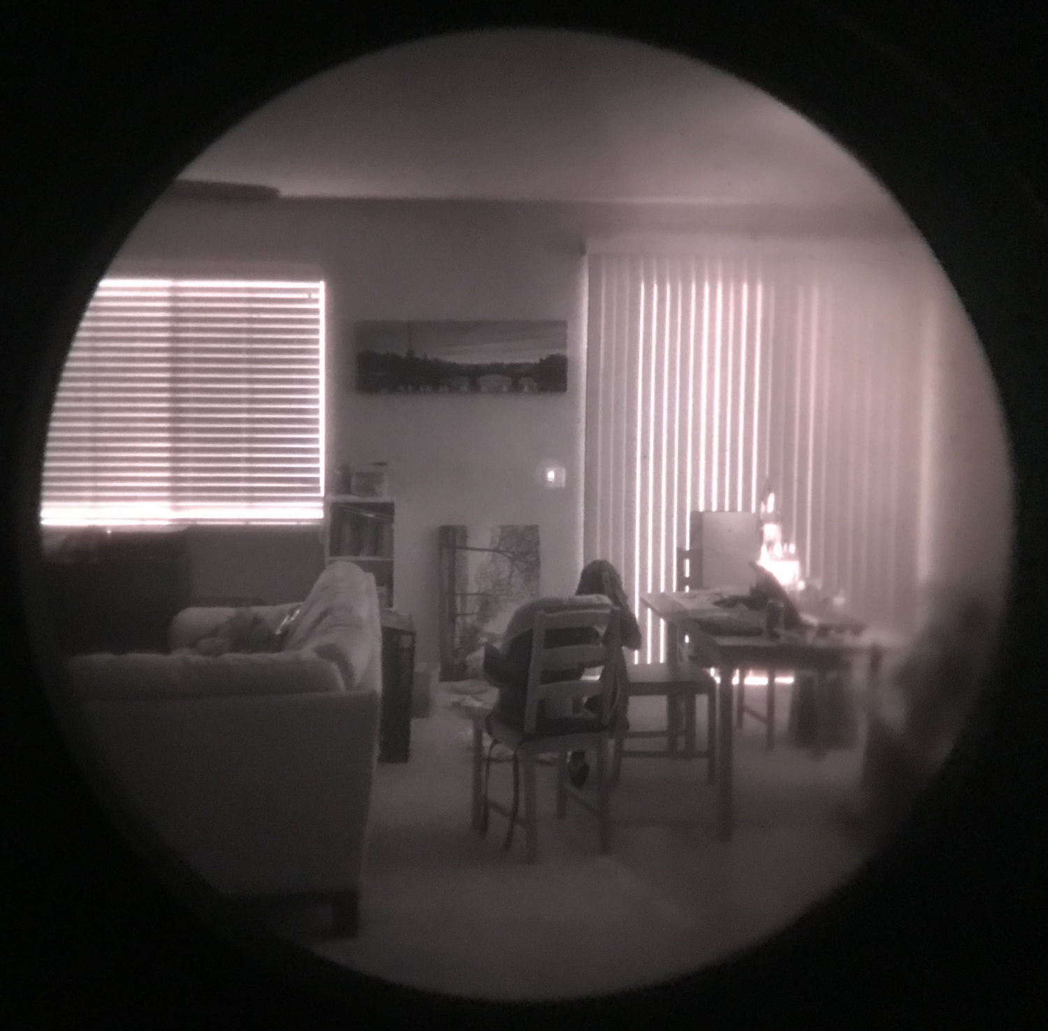

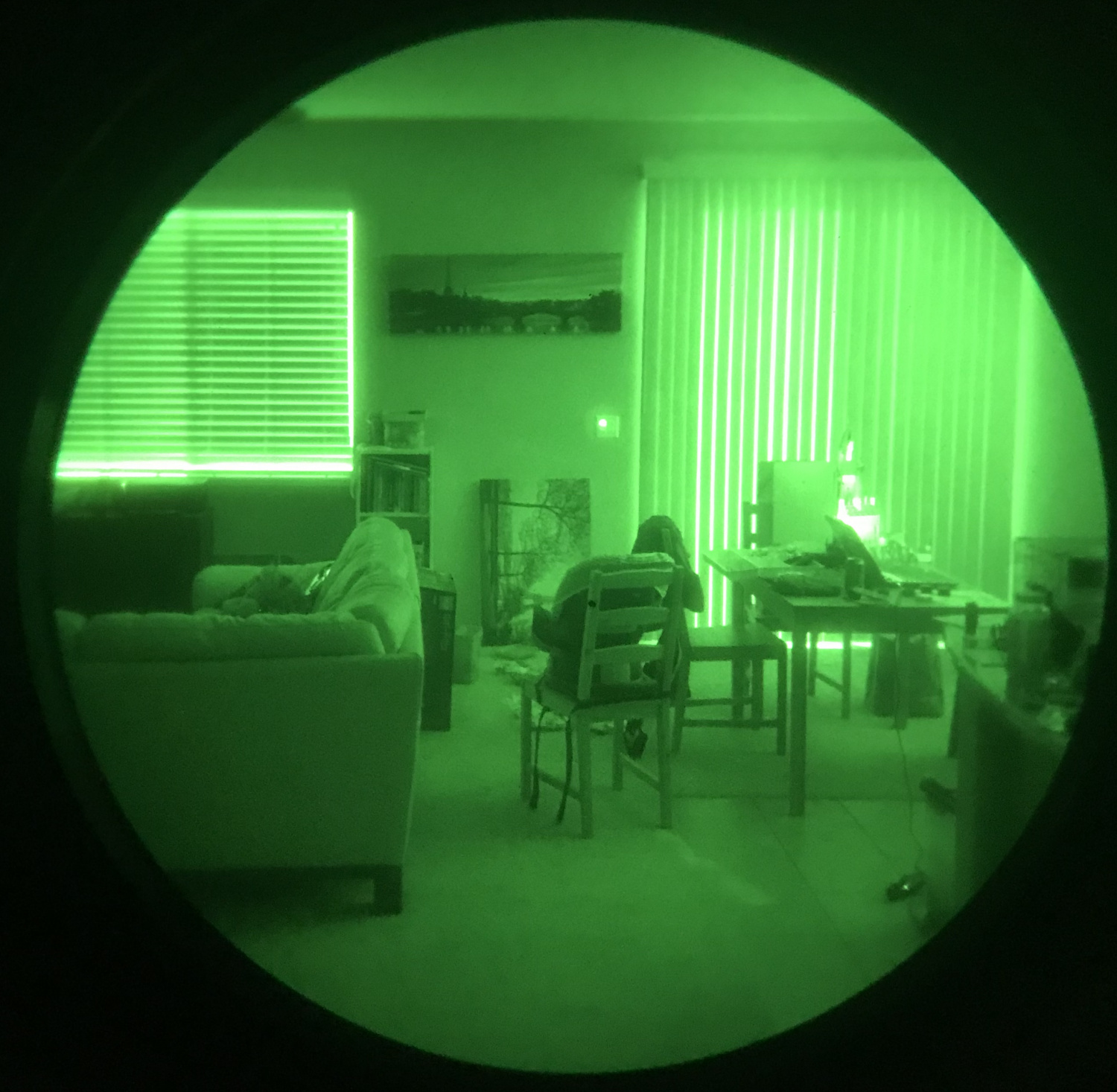

I read an article where a guy had tried it out and it didn’t look bad. But if it really does dim the image a lot I’m not as interested. Where I hunt it’s already hard to see at times with it fully bright.
Here are the pics from that article. One without the filter and one with on the same tube
It does dim the image. These pics are best cause outcome but everything looks great with that much light. You can find LIF’s pretty cheap so best way to find out is to get one and see for yourself
