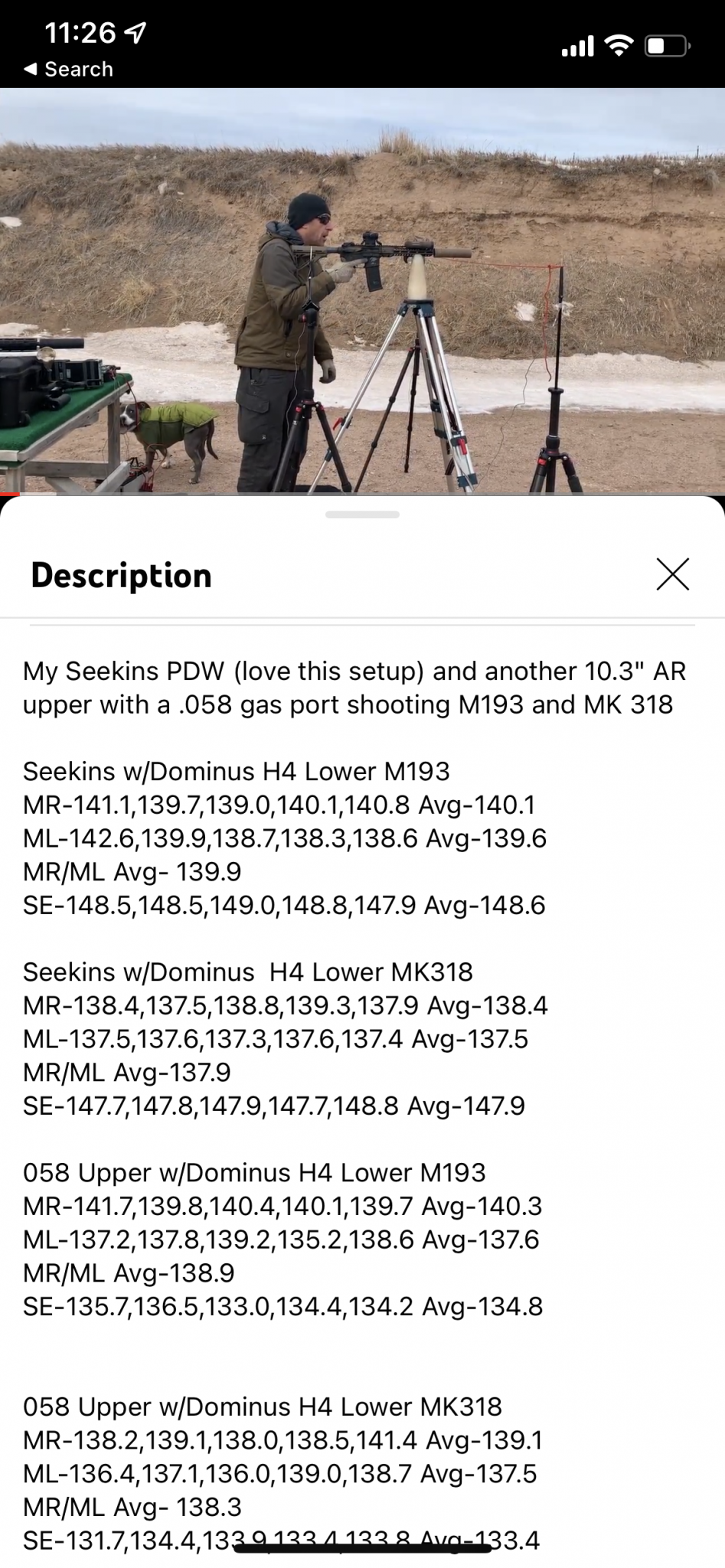

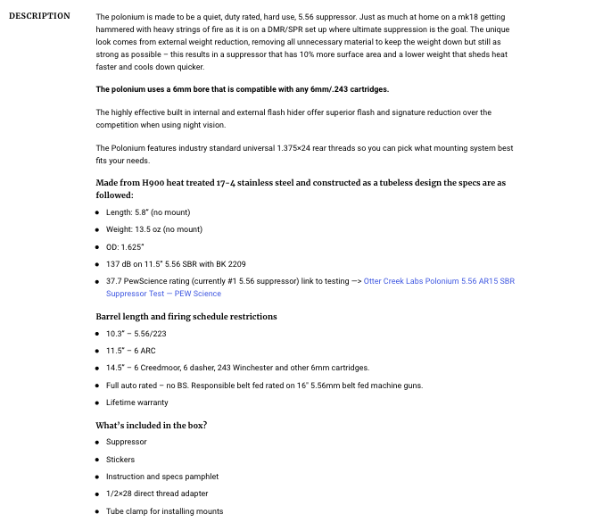

If you're talking about muzzle numbers, the Otter Creek Labs Polonium is the quietest 5.56 can according to PEW Science. As for at the shooters ear, I have no idea what would be the quietest. But I'm sure with some tuning on your gas block, and tossing in an H3 buffer, you'll be able to get those port numbers down significantly. Oh, and it's solid 17-4 stainless, and the MSRP is only $550.

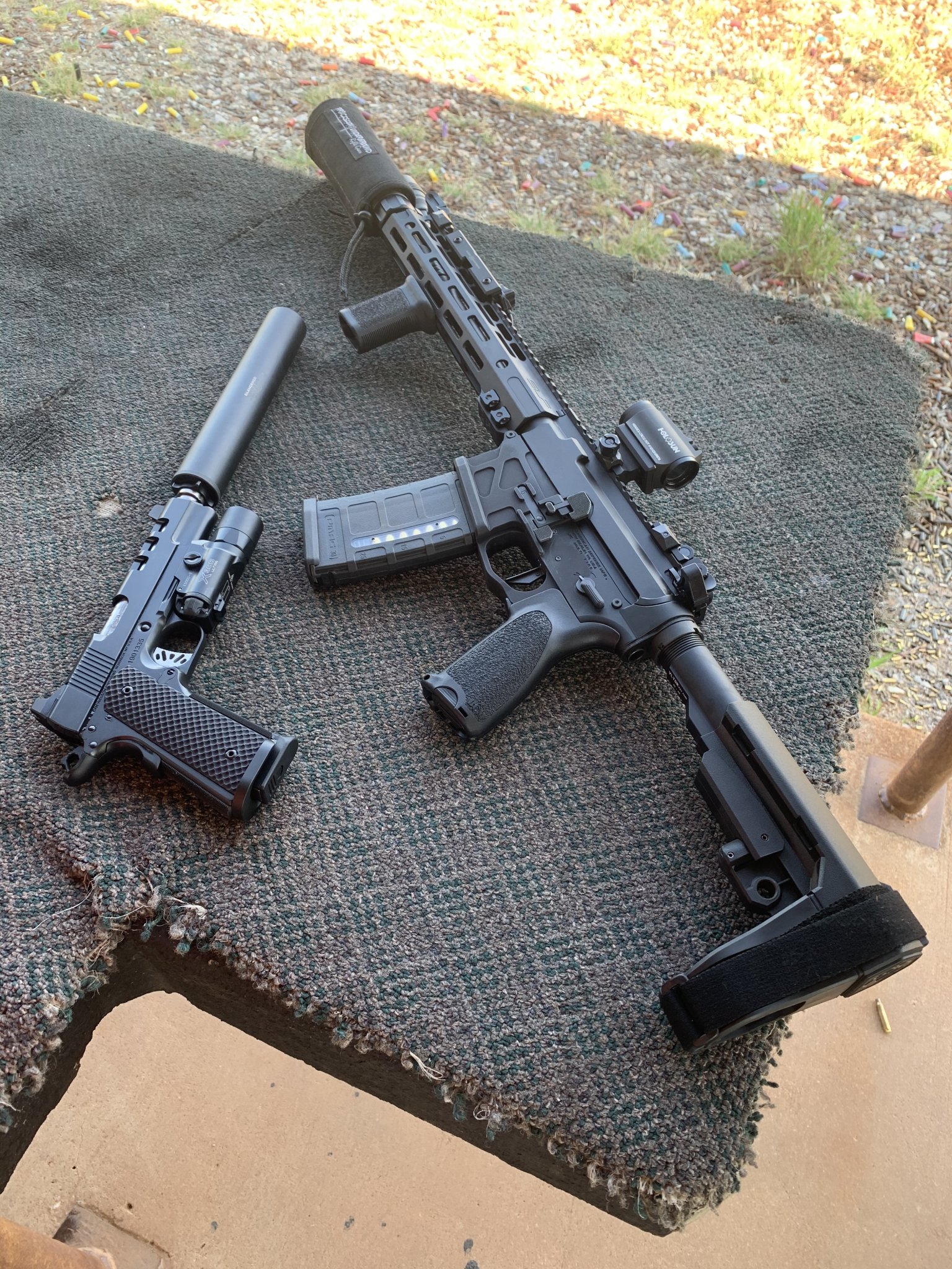

I have a SilencerCo Saker ASR that I really like. As noted above adjustable gas block is the ticket. With a untuned rifle the port will be loud enough that it won’t matter how good the can is. Back pressure will also effect this based on can design. Which will also effect rifle function. I use adjustable gas blocks or bootleg adjustable carrier

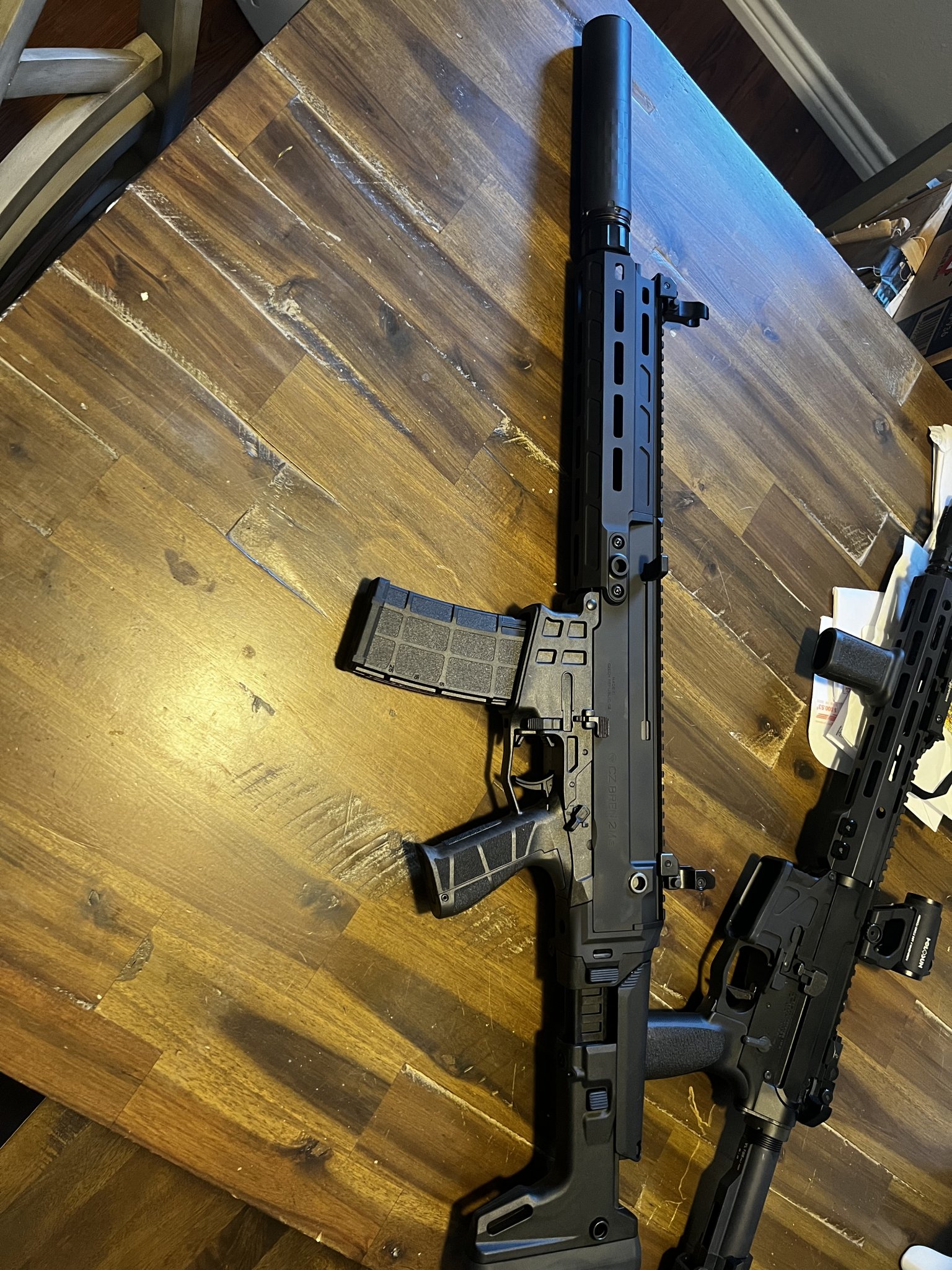

My 11.5 with a SLR-7 and a rosco manufacturing barrel. It sounds pretty good with a full size Omega with a 6.5 end cap. Like I said above I would not shoot it all day but I have ran a mag or two and it wasn’t bad. Now outside my drivers window is a different story lol. Also on a 11” Bren 2 but haven’t shot it yet.
