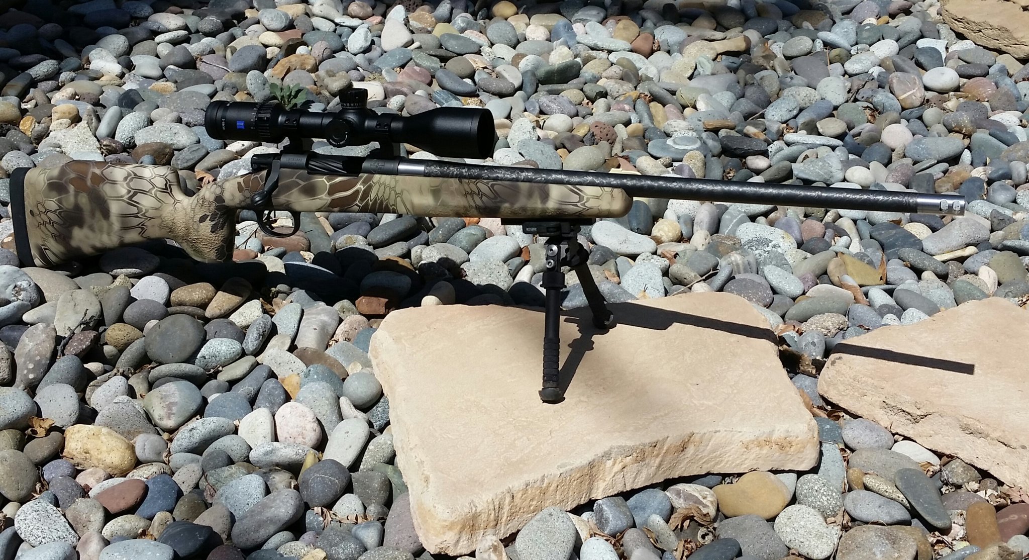

Zeiss V6 3-18×50
22 ounces Moa turrets
Excellent scope. Mounted one on a lightweight 6.5 PRC
